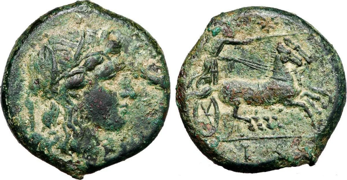

A very rare (R2) Syracuse Litra from King Hiketas (287-278 B.C.)
Heavy and bad encrusted but on some areas a nice black Tenorit Patina is showing up.

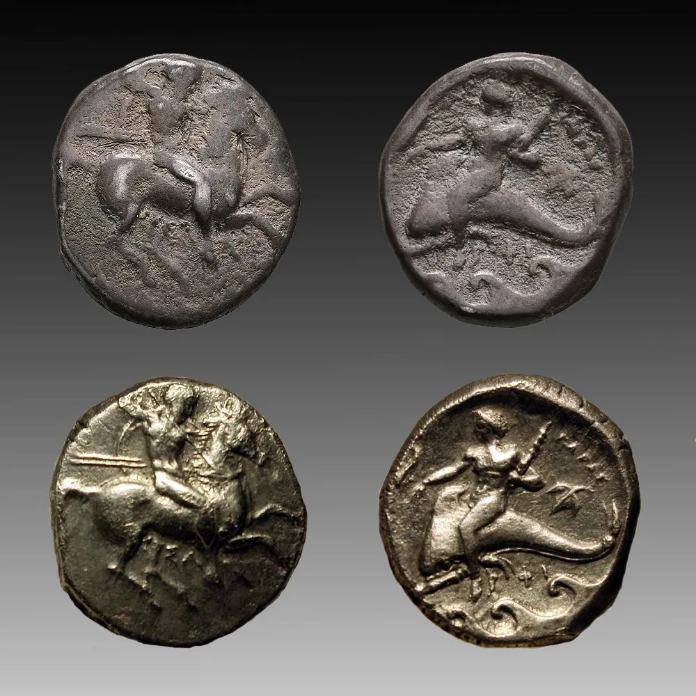

I cleaned it with a very soft air abrasion with mikro glass beads and it look good so far.
But I cleaned meanwhile an other silver coin - see below this posting!
Turned out great Tom.
To be Honest, better than I expected!
With such a thick layer of Silver oxyde you get mostly crude surfaces because many of the Silver surface is gone with the corrosion.
But on this one it was to see on some parts that it has quite good Silver under it.
Unfortunately way too bad for my collection but lucky me, I made out of 80 Euros more than a K, maybe 2 K :laughing7:
I tell you the auction result later in a few month :headbang:

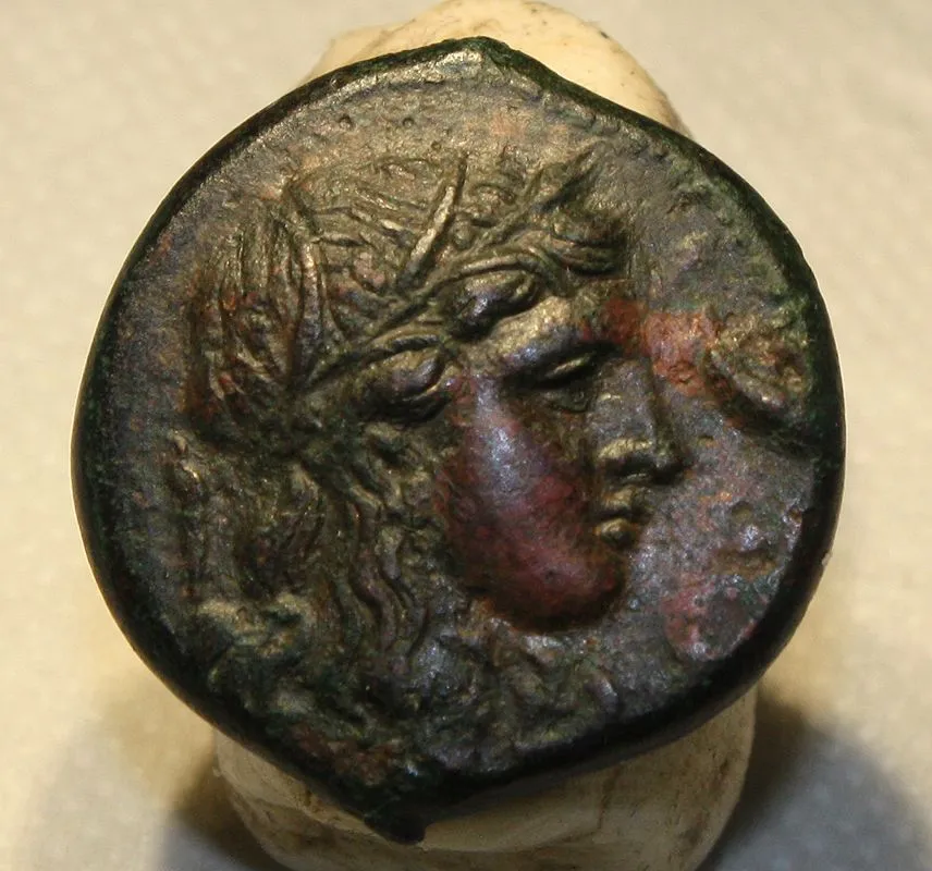

Just made some quick pics.
This is how it looks after the air abrasion.
As you can see on the face, there is a very hard wonderful noble cuprit patina under it!
I have to clean the front first with a scalpel to this layer and than lets hope it is also on the backside.
The Photo of the backside is strange. There is dirt on it from the plasticie I used to mount it for the photo which makes the surcae looking rough. In real the green layer is flat and shiny.
If I am able to clean the entire coin like the face - BINGO! Than it will stay in my collection :laughing7:
So wish me luck Friends!!!

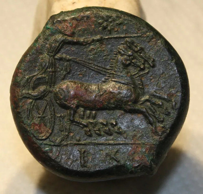

Quite a difference.
Quite a difference.
Not done yet! :laughing7:
I work on it at the moment with cutted toothpicks and glued very fine sand paper on top of it.
Works very well do flatten the fine details. It is more work to prepair the hundrets of toothpicks than work on the coin becasue this tiny pieces of sandpaper are quickly gone. The corrodet parts on the Horse are gone now!
Gosh... No client or collector would be able to pay for such a lot of work unless it is a coin for 10K or more :laughing7:
Works very well do flatten the fine details. ....

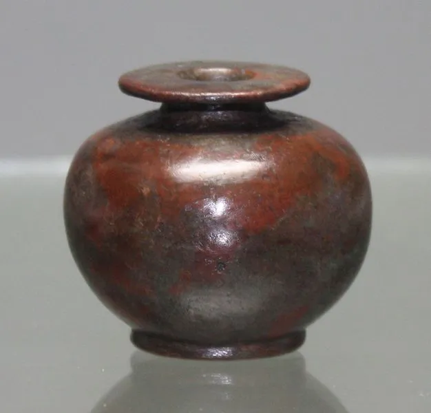

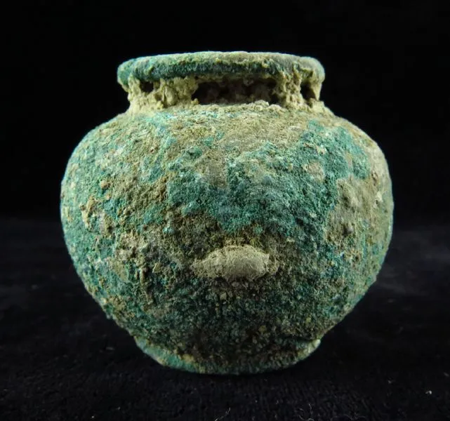

Egyptian pot is another exceptional restoration.
Is that your before and after images or what it will look like once it is completed?

It is always before and after the restoration.
