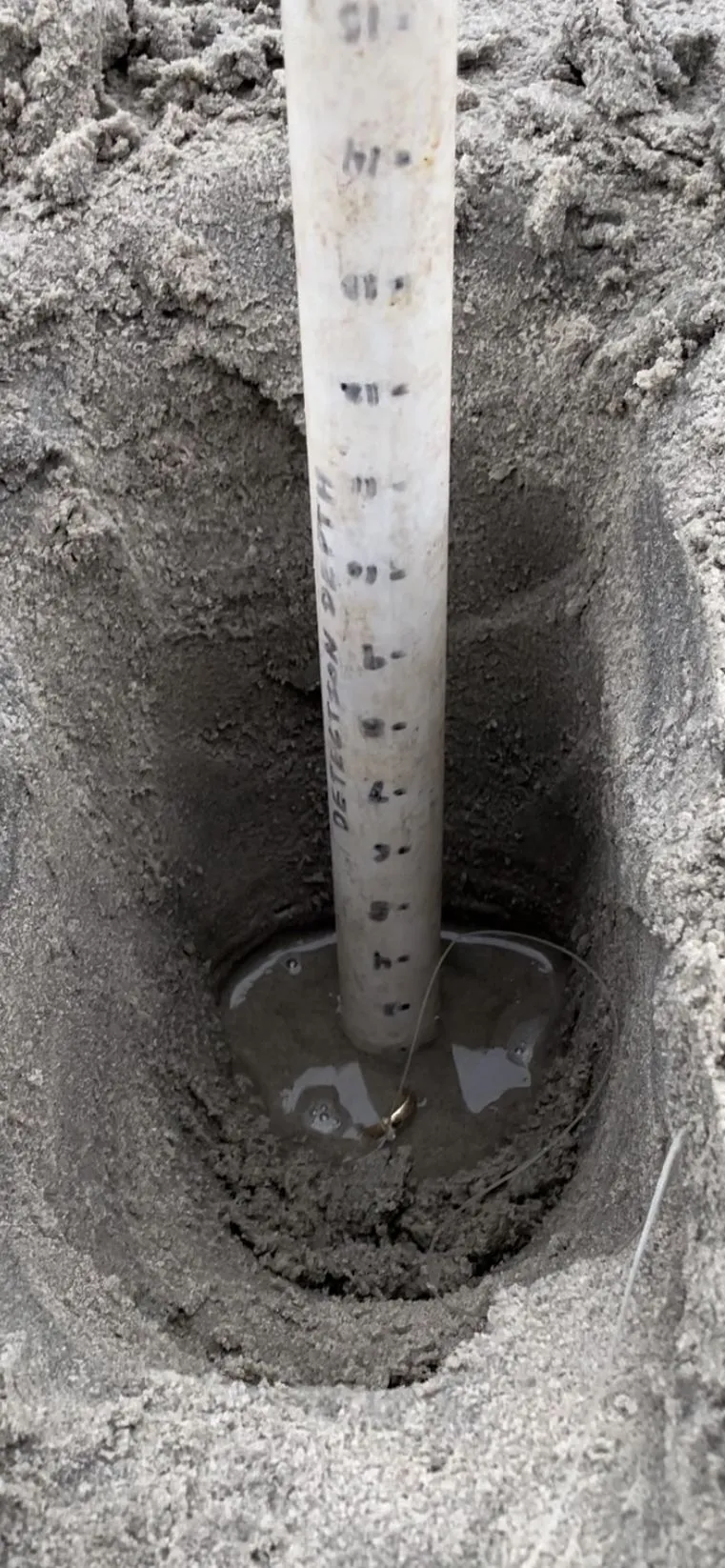

I recently ran a test using a men’s 14 kt gold wedding band and silver dollar at 1 foot in the wet saltwater sand.
I tested 3 machines on either all metal or discrimination mode:
-Original Excalibur (not Excal II) with 10” coil.
-Equinox 800 with large elliptical coil 15”
-AQ1B underwater pulse induction with 15” coil / 30 foot cable length.
After the testing was done, only the Excal on all metal (pinpoint mode) was able to pick them up. Discrimination mode did not pick it up without taking a few inches of sand off the top.
I tried various settings of the Equinox 800 with no luck. On land/regular soil I’m sure the Equinox would pick both up.
I would like to know if anyone can beat these results with the Excalibur on the beach in wet sand. My guesses would be the Deus or a pulse induction machine from Garrett or Whites. Maybe an AT Pro. I don’t own any of those machines.

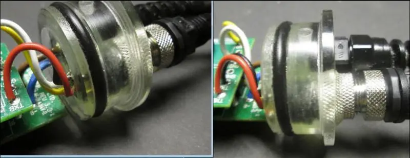

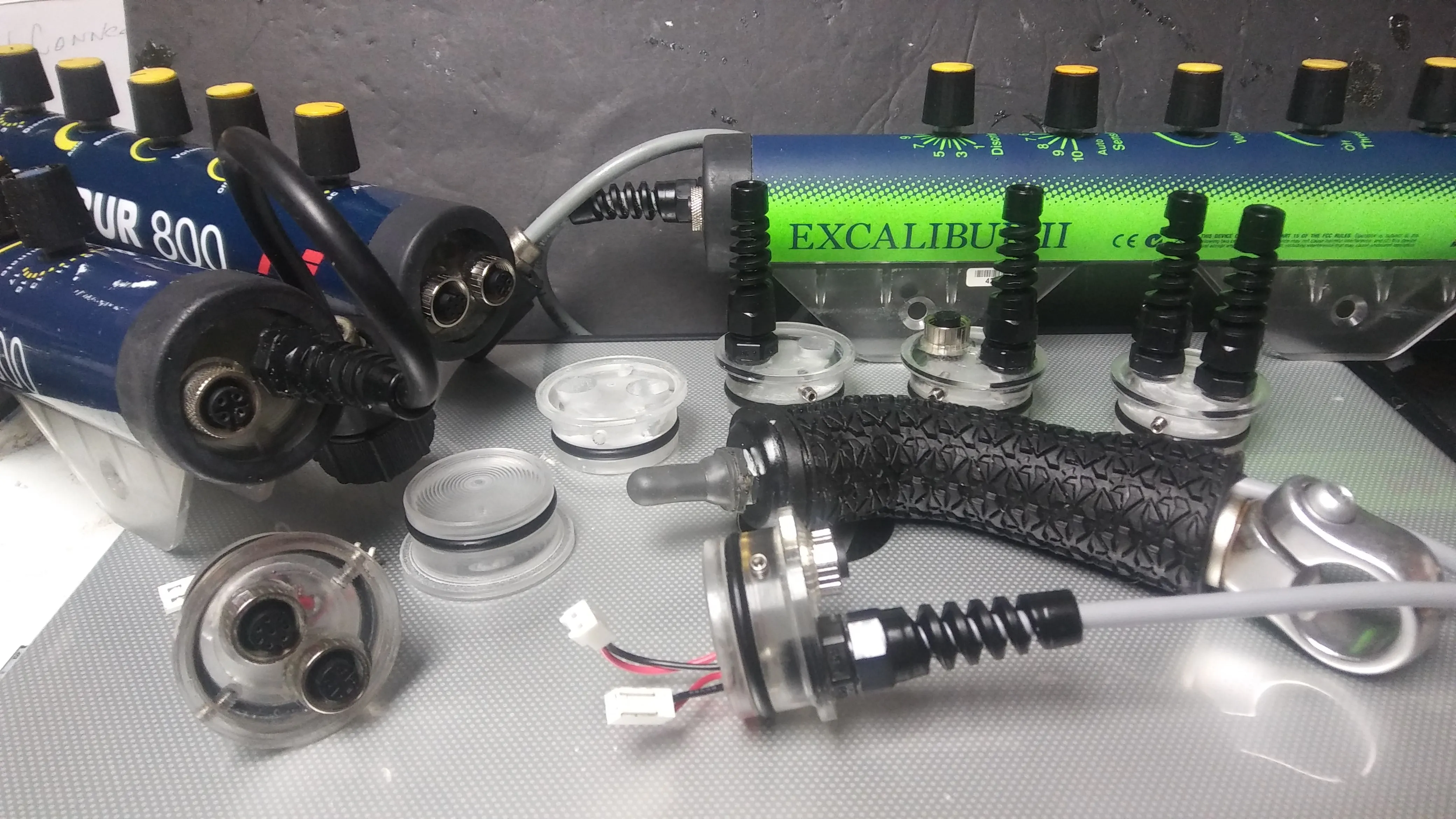

I agree, in the saltwater the 10 is the best for me. And 20 years is Great!! Mine are as old but I do rebuild them about every 3 to 4 years.
I made several of the endcaps that allowed coil changing, but in the end I found it is best to be hardwired. So after a few years of using them on my excaliburs I went back to hardwired. And stopped making all endcaps and doing repair work on the Excalibur, other than my own stuff.
I would guess I made a few hundred endcaps over the years for others..

Why did you like hardwired in the end better? For example the 10” is hardwired but I would like the option to swap a larger coil to detect silver dollar size coins in the sand at depths greater than what the 10” can find.

Just my opinion and since I hunt in the water only .. I feel I
have a stable connection, one there is less chances of having issues and I feel it is a weak link in that the signals have like a bottle neck. I used a few inline connectors over the years and always found them more likely to fail or to be a signal leaker, costing you depth. And what you will notice with inline connectors, when the saltwater hits that part of the cable it will false. Once I made the connector into the endcap it did seem more stable and no signal leaking. About 5 years ago I had several excaliburs so I was able to have a different coil for each machine, and after awhile I settled in to hunting in the water only..so I hardwired all my excaliburs with 10 inchers and one 800 coil, 7.5 inch stock coil. If your a wetsand beach hunter I think they will be fine, in saltwater your time is limited to when there will be problems.

Agree that putting the connector on creates a weak link and I don’t want to compromise depth. I hunt mostly in the surf and wet sand with the main unit out of the water. I could envision using a shrink wrap sleeve over the connector. I may consider a second machine as you mentioned with a hard wired large coil. It’s competitive on our beaches and gaining a few more inches in the sand could be useful. Again I’m looking for larger targets, dollar-sized silver coins. I liked the SEF butterfly coil the best and also tried the Coiltek 15”. If you have any recommendations for the largest, best coil for the Excal, I would be interested. Many thanks again, this has been a great thread.
