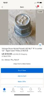

I found this buried in an old trashed desert area in AZ. It is a lug nut with what looks like worn gold paint, clear letter "R" on cover portion. Would like to know brand and age, whether color was stock or custom. Thanks! 1E8F7683-3A52-473C-9A4C-F4BB0BB9632E.webp178363E7-25CA-4DF4-A8B8-6A796C52FEA1.webp

I was thinking it’s a right side nut as a joke comment but I didn’t know they actually used to do that. Anyway, looks like it had a friend from Statham Georgia. This person thinks Rolls Royce is possible but I don’t think so as they always use the 2 Rs in their logo. They do want $20 for it though so maybe you could post yours up for $10 and under cut their sale! Lol
