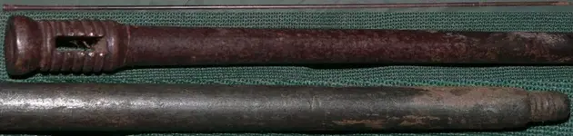

> First, show me the ramrod tip that would make that impression.
Scroll down to the end of this post to view a photo of "the ramrod tip that would make this impression."
Unfortunately, people who sell civil war era ramrods almost never include a close-up photo showing the shape of the "inside" of a ramrod's mouth. This photo is the best I could locate. I own a specimen of that same model of ramrod tip, but I don't currently have a "working" digital camera. When I get one, I'll shoot a photo which shows beyond any doubt that this IS "the ramrod tip that would make that [exact] impression."
> Second, as they say, name that tune!
Its name is the Enfield model P-1853 ramrod. The inside of the "mouth" on its tip is shaped like a shallow cup. Its shape matches perfectly with the imprint on the nose of Romeo-1's fired Enfield minie.

Yes. It was deliberately "big," because you don't want a small tip for pushing a lead (soft-metal) bullet down a rifle's ash-clogged bore. A wide tip works better for that than a narrow tip does.
