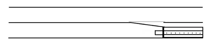

I really like the way this fellow fluid head addressed the removable trap idea.

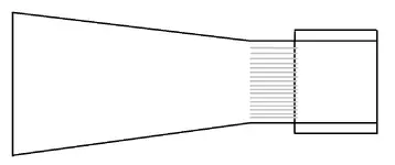

My next fbgt will incorporate that design except my trap will be wider than the sluice to allow for a lower water pressure drop zone.
Probably re-design the fluidizing tube layout as well and go with five 5/8" tubes instead of 3 due to the 10" wide trap.
The deck will be angled downhill into the trap starting at the beginning of the grizzly wires.
And of course my wire grizzlys will run flat not uphill. (my signature mod to reduce rock jambs). :icon_thumright:
More than likely go with a lexan cover over the trap. ( I like to see into the trap while it's running) Have one on my favorite fbgt and I like it.

I'm sure thinking of incorporating these ideas Goodyguy.
I'm thinking of trying the angled box for sure. And the drawer.
