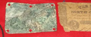

Below is a pic of a plate I dug at a North Carolina battlefield with permission. In the same area (within 10 feet) I found CW bullets, buttons, and other CW items. It measures approximately 3 inches by 4 inches as can be seen by comparison with the Confederate note. The holes appear to have been 'field made' at a different time than the plate. These holes do not look machine made since they are irregular. It's hard to see solder marks on the back, but I can make out 2 areas where it looks to have had solder. It was found in an area that was very close to salt and estuary water, plus sand, which may help to explain the difficulty viewing the solder areas. What is your opinion on this 'plate?' I'm calling it a 'plate' for lack of a better name. Thanks so much, Breezie

Breezie, what are the dementions of your plate and what do you think its made from? I don't know anything about it or CW plates at all, but you stated that the holes look to be field made and I'm interested in how a soldier could make these holes in his camp without many tools. Thanks.

Skeeterd, The dimensions are 3" x 4" and it is made of brass. I said I thought they were 'field made' because the whole are not uniform. I'm assuming they used some type of hand drill. Hopefully the CannonballGuy will give us his opinion. :) Breezie
As the mytreasurespot.com photos show, at least a few sheetbrass beltplates were converted for other use after their soldered-on attachment hooks broke off.
Breezie, about your plate:
You say it measure 3-inches by 4-inches. That size is significantly larger than the military belt-plates (which typically measure 2-to-2.25-inches high, and 3-to3.25-inches long). If your 3"-x-4" sheetbrass plate was manufactured for use on a belt, that would indicate it was a heckuva wide belt. Not impossible, of course, but it seems not very likely.
I wish your plate wasn't so heavily corroded & concreted, which causes uncertainty about whether it actually does have solder-spots or not.
The holes in your plate seem to be at least 1/4-inch wide, which strikes me as oddly large. If it was to be attached with small nails, or rivets, the holes wouldn't need to be that big ...unless it was going to be used in "very rough service" situations.
Sorry to be unable to be more helpful, but the above is all I caan think of for now.
Thanks CannonballGuy for the attemp. Actually, the plate is somewhat smaller than the 3"x4" I took it out of the display case to photograph it, but didn't measure it at that time. My measurements were approximate through the glass, but still close. I am clueless on this plate, but do know the history of it's location, but that doesn't really mean a great deal since I've dug a 1950's lipstick tube within 4 inches (and the same depth) of a CW bullet! LOL :) Breezie
