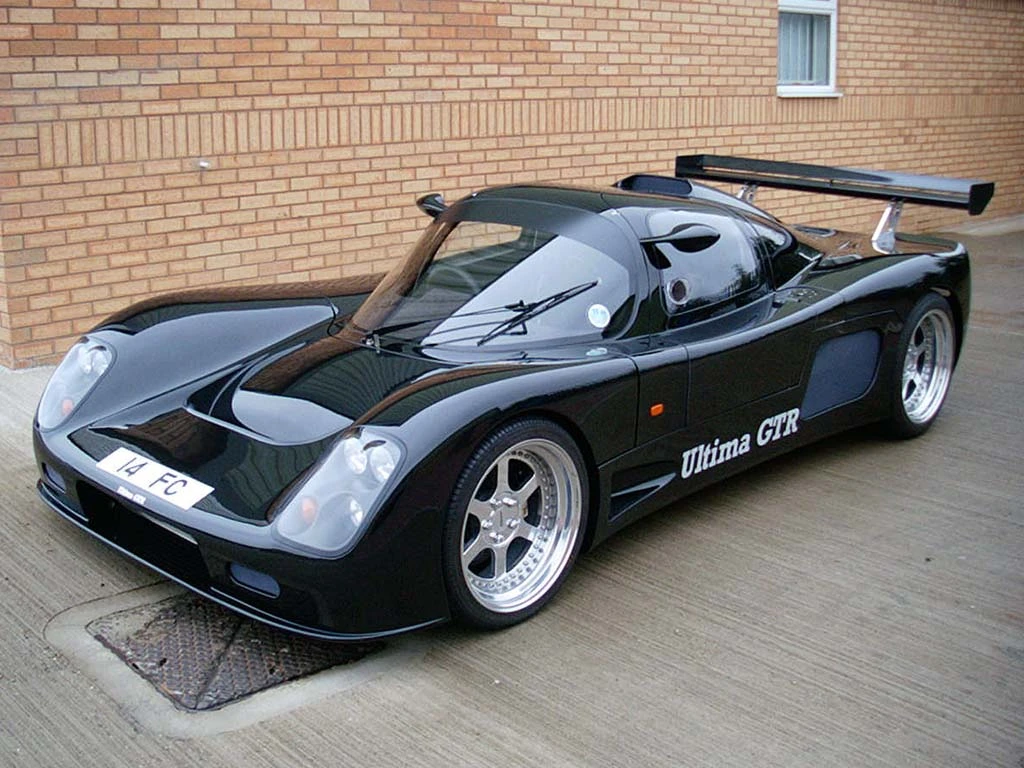

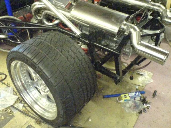

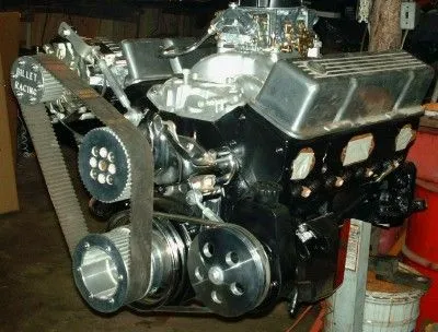

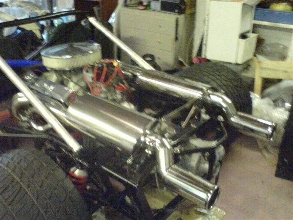

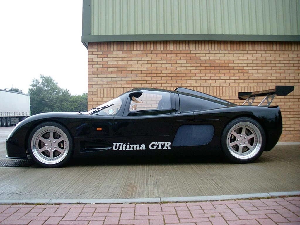

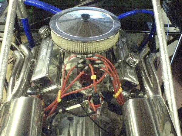

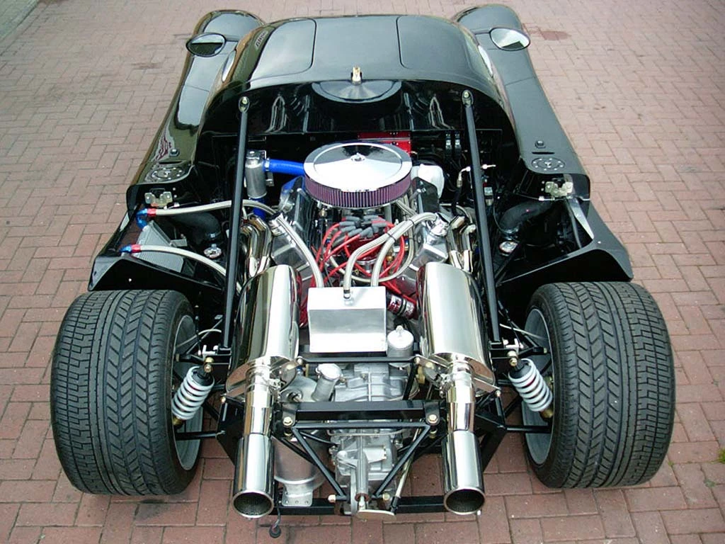

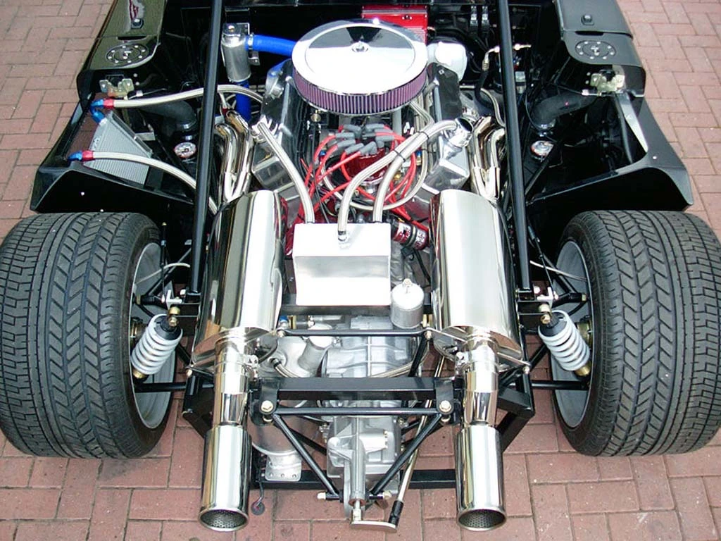

hi all, I didn't know this area was on Tnet ( what a great site ). When I am not tecting or working or being bossed about by you know who, I like to build cars. So far, 3 Cobra replicas and now, for a change, an Ultima GTR. I didn't build the engine on this one because I wanted much more hp and torque than before and the gear box is straight from Getrag ( Porsche suppliers). I am a little ways from finishing it but once completed 0 to 60 2.7 seconds, top speed 237mph and 0 to 100 to 0 in 10.3 seconds. The engine was a 350 4 bolt main Chevy, bored and stroked to 383ci. Keith Black pistons. roller rocker cam (wild), forged crank and rods, tweaked Edelbrock performer heads and airgap manifold, plus a few other goodies. The first three pics (sorry for the quality) are the back end of the car I am building, the next 4 are from the Ultima factory in Hinckley where they are manufactured, check out their video library http://www.ultimasports.co.uk/Video.aspx?f=videos
all the best and I look forward to seeing your masterpieces
hammered

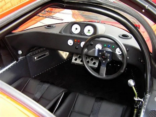

Forgive me asking, but where does the driver sit? Beyond cool car!!!
John
John
John I knew someone was going to ask so here's the cockpit

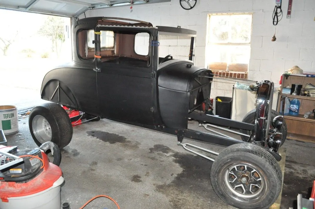

That is sweet! I'd have to hit the lottery just to build that engine. I'm building a 1929 Ford Model A Coupe almost from ground up at the moment.

I'd like to see that, have you posted any pics?

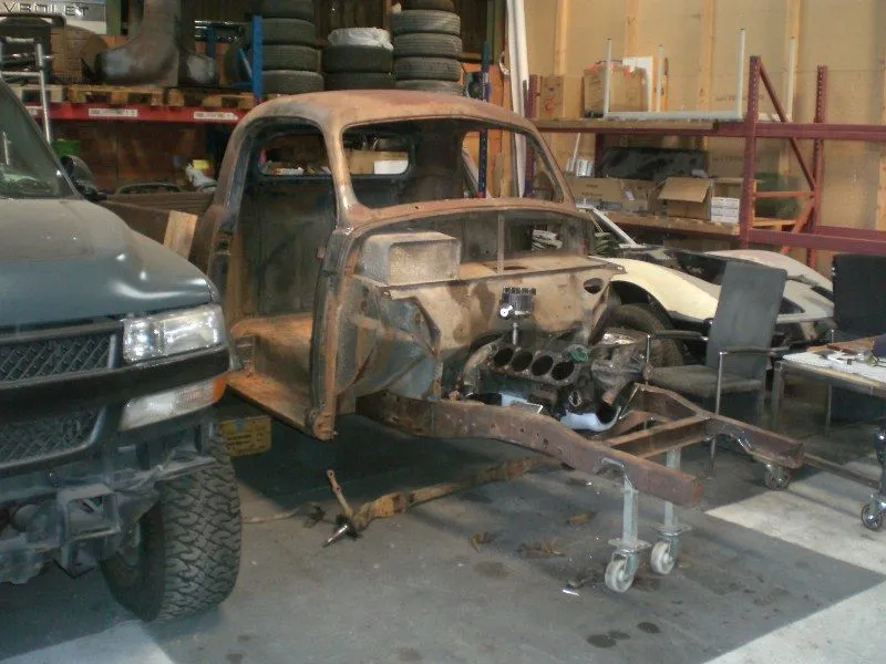

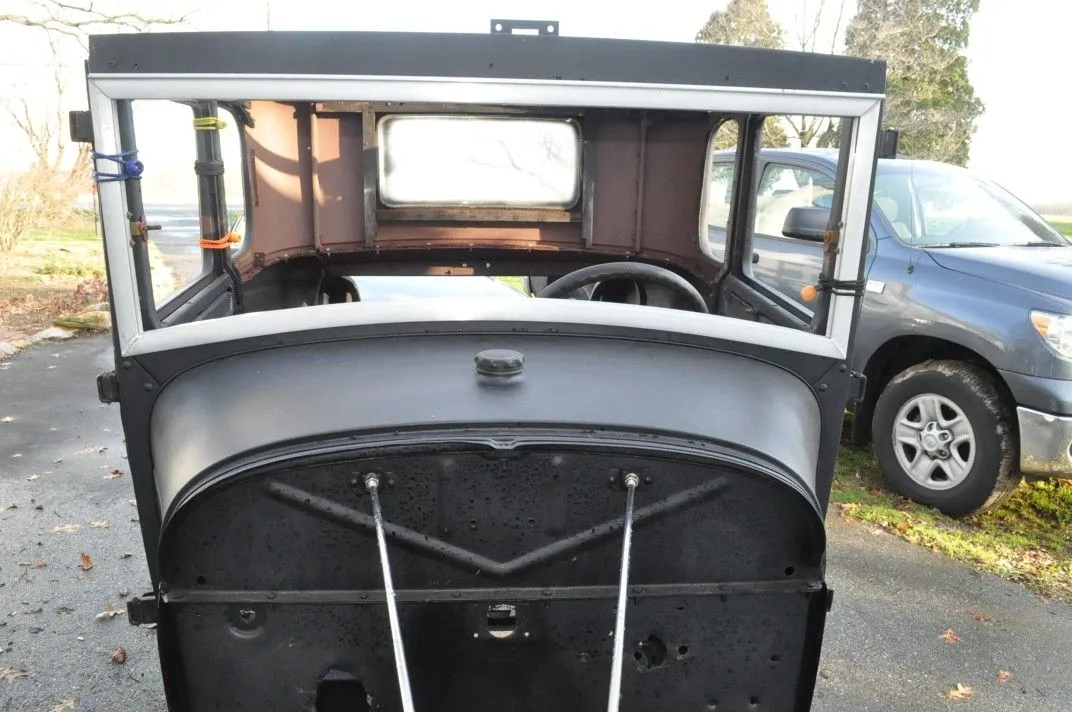

Here you go. I am in the collecting parts stage. Going to chop it 4 inches. Putting 1935 wire wheels, split wishbone front suspension with drop I beam axle. Drum brakes all the way around. Zing the frame in the rear and may channel the body not sure. It will be a late 50's early 60's style build.

baspinall said:
Here you go. I am in the collecting parts stage. Going to chop it 4 inches. Putting 1945 wire wheels, split wishbone front suspension with drop I beam axle. Drum brakes all the way around. Zing the frame in the rear and may channel the body not sure. It will be a late 50's early 60's style build.
Keep posting the pics, it looks like it's going to be a great car :icon_thumleft:. I will definitely follow your progress.

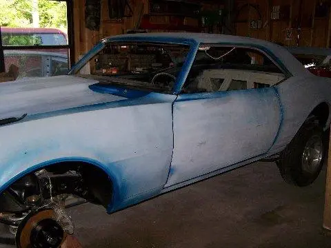

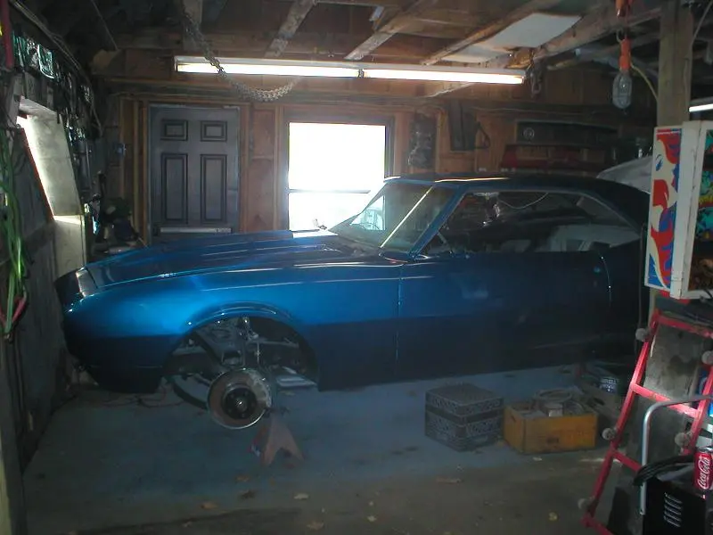

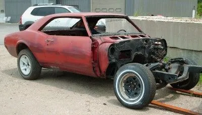

Current project is my 67 Camaro. Some of the pics make it appear to be a 68 (no vent window), it's not. The vent assembly was removed for painting. Waiting on wiring, glass & interior now. First pic is a 69 Z/28 I did a few years ago from the bare subframe up. 52K mile original car that's living in a heated garage in Washington state now at the home of it's new owner. The pic was taken at a local muscle car store where it was for sale on consignment. I shoulda kept that one...

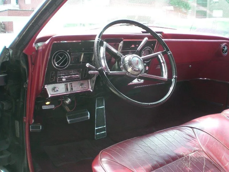

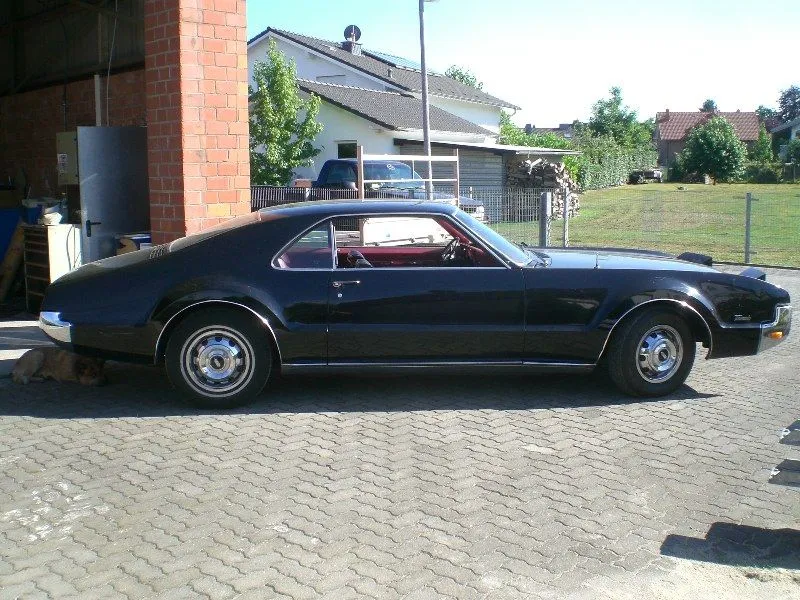

We are working on a 49 Studebaker Truck right now. Lots of work to do, but i love it! Last week we bought a 66 Toronado. Black on red! I should like it for my own...

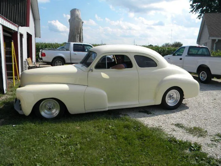

This is the newest to my collection. Its a 47. Ended up not liking the color, so next spring it gets a new paint job, and interior.
