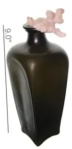

Here is a recent find I made in the USVI about two weeks ago. Dating this bottle around 1740 - 1780. This has to be one of my favorite finds to date.
Bottleman, that piece is in the later 'gin bottle style'. Would yours have contained gin or was it just a common bottle style of the time? (They would nave been handy to store in crates for shipping as there was less 'dead space').
Very nice bottle by the way. I still get excited when we find one 100 years old and intact. (Too many rocks around here.)
The case bottle is a nice find! There are divers and diggers that will never in their careers recover a case bottle!
I agree with 'likely guy' that this case bottle is later than 1740-80. A 1740s bottle would still be straight-sided, rather than tapered, and the shoulders would be squared. I would estimate 1800-1830 for this one, depending on whether it has a pontil scar. But, it's difficult to pin down a close date on these generic bottles.

Thanks for taking a look and clarifying a few things. I am still a rookie when it comes to dating bottles but appreciate the heads up. After I found it, I brought it to a good friend who collects mainly ribbon sealed bottles and he placed a quick date on it for me. As far as the contents are concerned I would have to believe that it contained Gin but you never Know. I will go through some of my reference books and see what I can find.

According to Van den Bossche, the tapered case bottle was born in the 1770s when the world-wide increase in the consumption of gin created an enormous demand for bottles (See Plate 84 on pp. 132). By 1830, these bottles were being made without being empontiled.
If they weren't so fragile, there'd be a lot more of them around today. By the 1870s, case bottles generally were more robust -- thicker side panels -- so there are quite a few of them available.

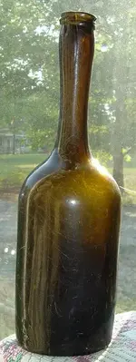

Here's one of mine.

Road Dog said:
Here's one of mine.
Nice! Good image, too!
These long neck wine bottles are dated to circa 1760s, and I admire the form.
Your long-neck wine is the first I've seen with a molette mark. The molette was a rod, sometimes with a toothed head, that was used to make the kick-up before the pontil rod was attached. The molette was in common use, but unless it had a toothed head, it didn't make an obvious impression.

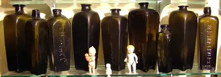

I have a few bottles of most categories, but I think I have more black glass than anything else. Here are my window bottles:
windowblackglass.webp​
Purty Window Shot! Love the Gins!. The Onion if I had to guess ...Dutch. It has no molette mark.

Thank you, 'Road Dog' -- the gins are pretty good, late 1700s, I think. My favorite bottle in the window, though, is not a case bottle. It is the sherry wine bottle.
