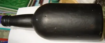

Dude you are happinin in Black Glass! Here is a 3 piece Mold I have. Excuse my kitchen light pics.
I can't say I remember seeing a Truffle Bottle. WOW!
Who does not admire these durable utility bottles! Your bottle looks to fall into that 1830-1860 range -- not unlike the two 3-mold bottles I posted earlier in this thread (I didn't label them, but you can see the mold-marks). Your bottle appears to have the satin patina of a river bottle -- are you a river diver, 'Road Dog'?

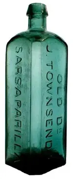

I found one of these Dr. Townsend's bottles in a river. It was covered in slime and barnacles -- I thought it was a brick when I picked it up. Imagine my surprise and delight! This is the one I found:

Road Dog said:
Yeah ,the Schnapps. WOW!, what a find. Did you give it a acid bath?
Yes, I am mighty proud of that Dr. Townsend's bottle. Acid bath? It's been so long ago that I don't remember. Probably used vinegar (acetic acid) -- is there a better way to clean it up?
