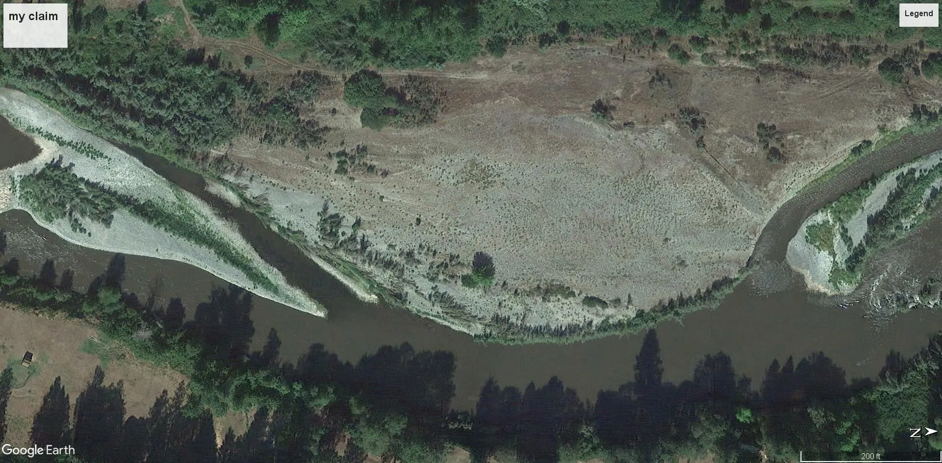

For us to give you a better plan you should give us a pic of your gravel bar, it is not necessary to dig up the whole gravel bar ounce you understand flood deposition. my claim.webpthis a 16 acre claim I own and I know from experience where to dig. Test your area and find the flood lines, they will be the richest .

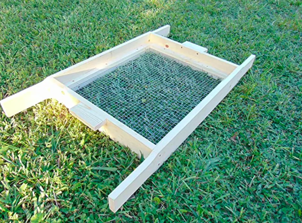

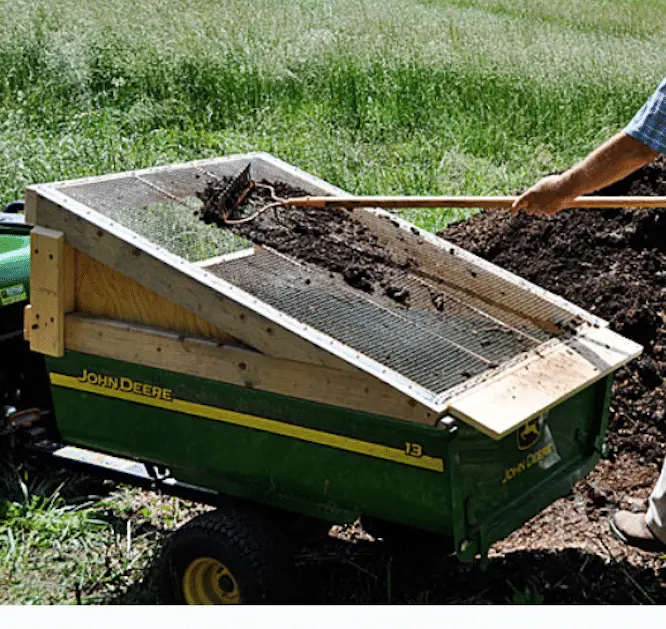

Build yourself a large classifier 3'x3' 1/4" mesh.. easy to do with a couple 2x4s and some 1/4 hardware cloth screen.
Put a tarp under it to catch your screened material... do this in the morning... Run the classified material after lunch through your sluice
Remember, classify the material down close to what you expect your gold size will be...This will improve the performance of your recovery equipment.......
As to your sluice mats .... Again determine the size of the gold you will be recovering, Use mats that perform well for that range of gold size.... You might also want to add a nugget trap for the odd chance of catching something out of the ordinary.
Haul your cons home.... You should only have a couple quarts of cons, maybe 1 gallon.
Hide the classifier on site as well as your wood framed sluice then all you have to haul out is pump, gas can, mats and cons....
Put legs on it instead of the configuration in the image.
