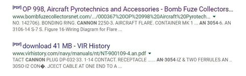

If I google "CANNON" "AN 3054", I get a few military hits related to 1947 aviation. google.webp
That part number is in here somewhere http://www.bombfuzecollectorsnet.co...998 Aircraft Pyrotechnics and Accessories.pdf
