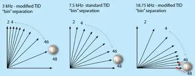

Well....I can tell you that you're pretty much on the mark, except for the part about DD coils doing a worse job.
I can also tell you the reasons that the HF coil is the worst for discriminating crown caps. It has to do with the target bin widths being narrower at the top of the scale with the HF coils, coupled with the difference in target response between the three freq's. The MF coils actually have the most uniform bin segment widths providing the most honest/accurate TID's, and the LF coils have the widest bins at the high end. What this means is that it's easier for high conductors to bleed over into adjacent bins with the HF, whereas the opposite is true with the LF. When you factor in the targets response to the fequency selected, understanding that rusty iron is basicly at the very bottom of the scale, you'll find that often what causes it to register as a high conductor is what's known to be a "wrap-around effect", which boils down to it producing a harmonic that causes it to be placed in a high value bin.
Here's an illustration that shows the difference in bin widths between the three frequencies.
