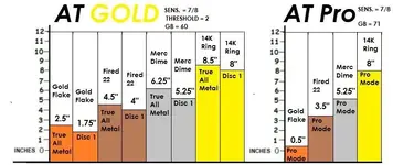

Maybe this will help, depending on which type of detecting you. Click below:
Garrett Comparison Chart - AT Gold and AT Pro
