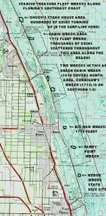

Hello chagy ... Im going to take a hard look into why they havent found them...You know im not from that area ,and have not focused my search on the area like you guys. I would like to know just about where the wrecks found are located,for me it helps to see maybe some type of pattern.. I would like to know just how far off shore the wrecks found are...If someone can give me the locations/red X of treasue found on the old map. I will try and help..
Ahoy!!!!!
Whats up RelicD.!!!
There are many theories..... that they are on the other side of the road in the river, that they are under the road or the buildings behind the dunes, that they are further north or south and that they are in deeper waters. Be careful once you get bit by the 1715 bug you will never be the same again ;D ;D ;D

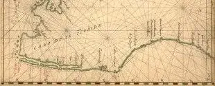

Good point about the info ivan,but can anyone really tell where anything is in the middle or shortly after a hurricane? Im sure it was just a mess..Were the ships found so far the big heavy ships of the fleet or the smaller of the fleet? Nothing to do with the treasure fleet , some may have seen this picture of the distruction a hurricane can do .And most in florida know first hand....Grand casino biloxi mississippi..Huge casino ,busted lose and pushed inland.. Katrina
