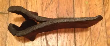

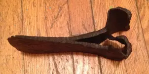

I just finished electrolysis, boiling, baking & waxing on the late 17th century trade axe (long process but worth it) I think it came out great! I only had a little loss on the edge but you can only save what is there. I also included the before pic. This is definitely my favorite iron relic besides my Rev War shells & probably my oldest find. ImageUploadedByTreasureNet.com1473123959.684442.webpImageUploadedByTreasureNet.com1473123974.738098.webpImageUploadedByTreasureNet.com1473123985.251000.webpImageUploadedByTreasureNet.com1473123996.183495.webpImageUploadedByTreasureNet.com1473124006.518900.webpImageUploadedByTreasureNet.com1473124031.000149.webp

Nice work, ax looks incredible... After electrolysis I boil my relics in paraffin, what is your process?
After electrolysis I boil 2-3 times to remove any salt (important, about an hour) Once the water is clear it's good.
Then I bake at 300 degrees for an hour or so depending on the relic to remove all moisture
I then take it out of the oven & while hot apply Ebony Briwax generously. It soaks it up while hot
After it cools down I wipe off the excess wax & done
