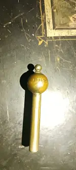

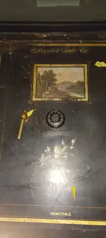

Hi everyone, I'm new here and in desperate need of so help!! My husband was just recently given a HUGE Antique Mosler safe he saw the other person open it but we are having a very hard time opening it, any advice would be appreciated!
ALSO any ideas on the worth of the safe?? I don't have the best pictures right now 😕

I don't have a lot of experience with old safes, however on some old safes the tumbler pins begin to wear. When the pins are in that state, if you try putting in the combination too fast, the pins won't necessarily slip into place. Slow down and 'feel' the pin slide in. It's much easier to show than explain. But basically as you approach the combination number you will feel a slight hesitation and then you will feel it slide into place. Let it rest there for a sec and then continue.
I also noticed there are two marks to indicate the stopping point. Be sure you are using the right one.

make sure you use the top mark ! The side mark is for setting the combination

The tumblers in this safe are discs not pins. Gare has the right instructions., if you don't begin in the right direction using the proper numbers will not open the safe. I have a similar Mosler, they are easy to set the combination to whatever you like once they are open. I have changed the combo on quite a few old safes, pretty easy on most of them.
