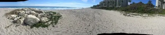

Yesterday I finally got to try out my new scoop. I had never visited Boca Raton beach and decided to give it a try. The beach is beautiful but it is all replenished sand. It was a little chilly about 68 at the high but a great day to be out. I was north of the Boca inlet but wanted to reach south of the inlet and walk to the pier. I never made it across to the south side of the pier because a hotel had me blocked off at the inlet to make the crossover to the other side. I did not find much other than clad and will not be posting pictures of my finds. I will however post some photos of the beach for others to see.

Not trying to be over critical but, I think some close up picks of the scoop are in order. Nice pics anyway.
You are right I should have and will include those.IMG_2115.webpIMG_2117.webpIMG_2119.webp
