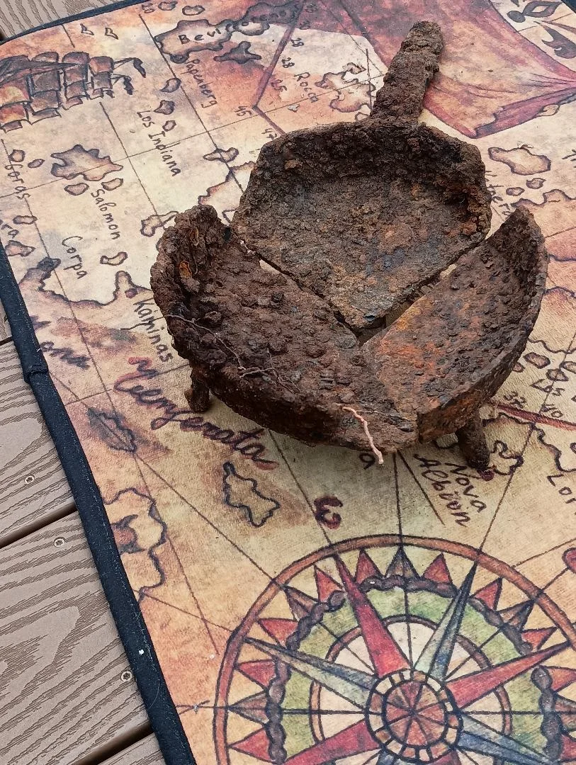

What's the process for restoring a skillet that's missing pieces?

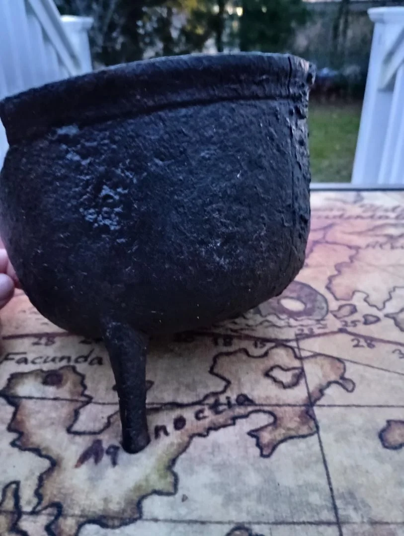

For restoring the iron skillet I'll get each piece down to base metal. I'll use reverse electrolysis and a drill with a wire brush. Then clean with acetone. After that I use a five minute epoxy to hold the clean pieces together. Then a coat of rust inhibiter. Finish with a clear rust-oleum. This is a dug bean pot that I put back together.
Congratulations on some very nice finds! Nice photos, too! Thanks for sharing.
Cool! I've dug enough bean pot pieces over the years to make a dozen bean pots but no luck in finding big pieces like that. Please post a pic of the restored pot when you get done with it. That bee button is a great find.
I see. It'll be restored but with a couple of missing pieces?

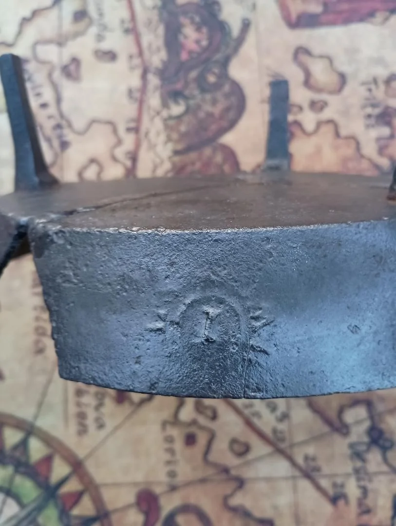

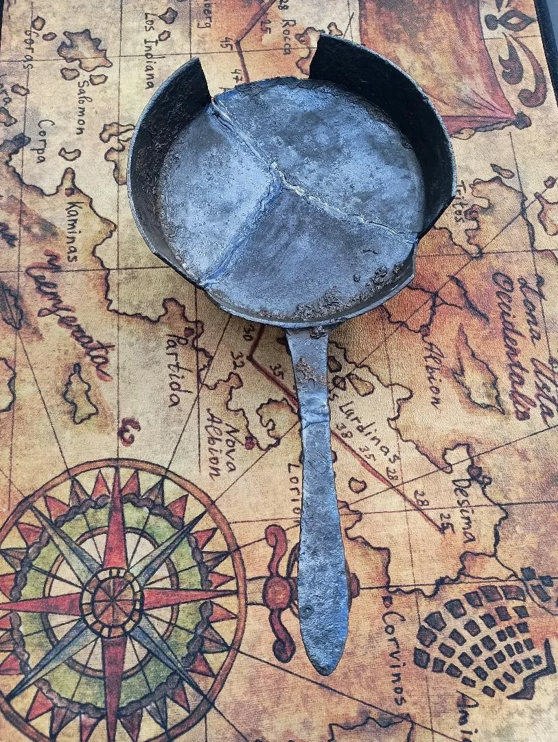

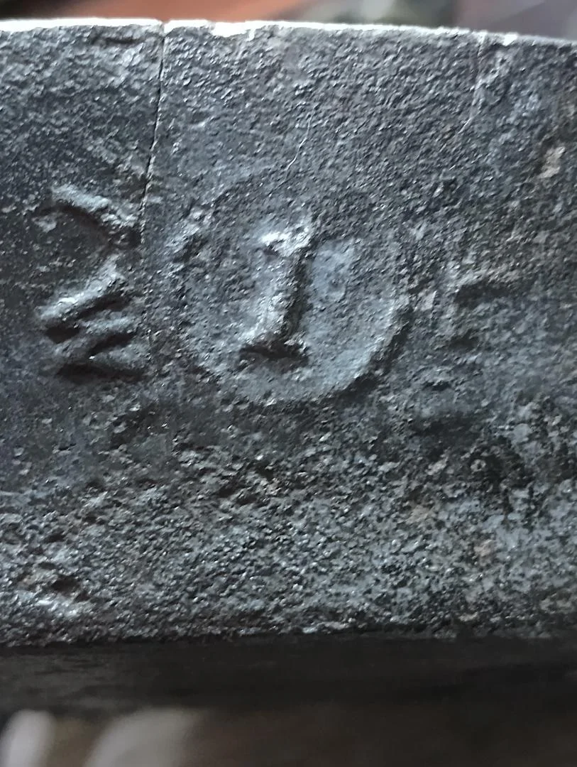

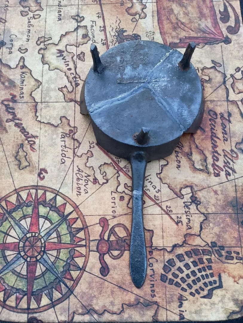

This is the 9" Spider Pan 90 % restored. I'm trying to ID it.

That is too cool. Great job so far. I'll see if I can help with the ID.

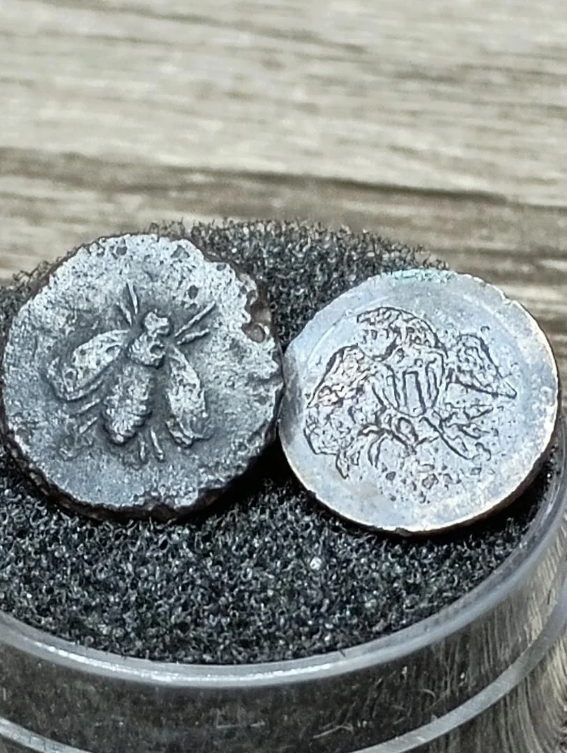

Any ideas on the bee button? I recently found one….just curious
The small bee button is a Jacksonian waist coat button. They were worn when Andrew Jackson was president. There was also small patriotic eagle button.
