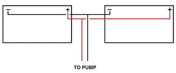

Yes I want to buy a 12 volt deep cycle battery. Could I get two and put them inline would that work?

Tractor supply sells them for $90. If you connect 2 in parallel you could get 5-6 hours runtime. If you have a way to transport them easily, then 2 is better than 1 by sharing the current load and is less expensive than 1 larger battery in most cases.
Two batteries will give about 5 hours of run-time draining down to 50 percent as you will extended the battery life.
