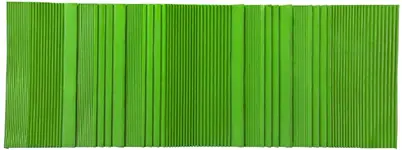

I actually built the hopper for my plastic drop riffle sluice with the long slick plate that the mat was purchased for. Problem was the plastic sluice had sides that are at an angle not the 90 degrees necessary to seal the mat against the sides. Plus the mat is 10 inches wide and the plastic sluice had a 9" bottom.
Well I wanted to take advantage of the full size of the mat so I put together the sluice shown above. In the meantime I came down with the flu and have not tested the mat as yet. I had already tested the hopper on the plastic sluice before the mat came in.
Dont worry as soon as I'm able I will test the mat and let you know the result. Just so you know, when I do a test, I do it with a known quantity of gold of different sizes and shapes. The gold seeded paydirt is not introduced to the hopper until after the mat is completely loaded with sterile (containing No Gold) dirt. Then after the gold laden paydirt has been introduced I will run at least a couple more gallons of sterile dirt before doing a clean up.
I've seen tests on youtube that run gold only with no dirt at all to evaluate a mat and to me that is not the best way to test a mat that is going to be loaded with black sand and gravels while being used in the field.
One test that stands out in my mind was a side by side test between Dream Mat, Miracle Mat and Gold Hog Mats performed at a gold show. Of course the dream mat won hands down. Which meant absolutely nothing to me knowing that I would not be running gold by itself down any sluice.
Just to prove my point I think I will first run my test gold by itself and then compare those results with those using my normal testing procedure.

Hi John,
Just finished my test on the mat you have pictured above.
The first thing I noticed after turning the water on before running any material was that the mat traps a lot of air bubbles.
A hand spanking of the mat took care of all the air bubbles (something I learned to do with the vortex mat/rough top conveyor belt)
Another issue that I wanted to address was the transition from the sluice bottom to the beginning of the mat.
I found that a thin piece of aluminum flashing 2-3/4" x 10" held to the sluice with waterproof double sided carpet tape worked great.
The first 2" were in front of the mat and then 3/4" was bent up and over the leading edge of the mat.
Made a smooth transition and held the mat down as well.
At the foot end of the sluice across the bottom I attached a 1/4 tall aluminum molding to serve as a stop for the mat and to do double duty as an anti migration baffle to stop any gold that made it's way underneath the mat from washing off the end. Very important.
Ok, now to my test results.
First, out of curiosity I wanted to see what would happen if I just ran my 2 gram sample of assorted shape and size gold by itself.
The gold consisted of large pickers down to fly poop size, some was coarse some was fine, some flat, some round.
I sprinkled it into the hopper and waited 5 minutes before shutting the water off.
NO gold went past the first 3" of mat.
I cleaned the mat, dried and re weighed the gold to make sure I had it all.
Then I re-started the water, spanked the mat, and ran 2 gallons of regular desert material classified to 1/4" that contained no gold to load the mat.
Without stopping I then ran two gallons of the same type material but with the 2 grams of gold mixed in.
Then ran another 2 gallons of sterile desert material before shutting down to do a clean up.
I also had placed a tub at the end of the sluice to catch all the tailings from when the gold was introduced until shut down.
Could see that a lot of gold was trapped in the first 3" of mat. Before removing the mat to clean it I adjusted the legs on the sluice frame to level.
Then I used my long tweezers to check the mat riffles to see if I could tell how far down the mat that the gold had traveled.
The best I could tell was that no gold made it past about 12"
After panning the material in the mat by hand and then drying it before weighing, the 2 grams of gold was all accounted for.
I felt there was no need to pan the tailings.
I know this test was just my one experience with my setup and my material and gold. Your results will most likely vary.
My opinion of this mat so far is that for what I am going to use it for, it does a great job!
Hope this helps.
