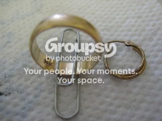

Pete and I hit a beach that is hammered to death. There was lots of people in the water and nice looking gold everywhere.
I hunted with the PI machine so I could get deeper than the vlh machines and it paid off in a nice 14K band and a very small 10K earring....
nice gold. those little earrings are cool.

Nice finds. All of you posting these finds are making me desperate to get back to Florida.
Congrats....

Hey Bill looks like that ring has been there a while in the water,, Looks very old ,, Great find ,,wtg guzz
