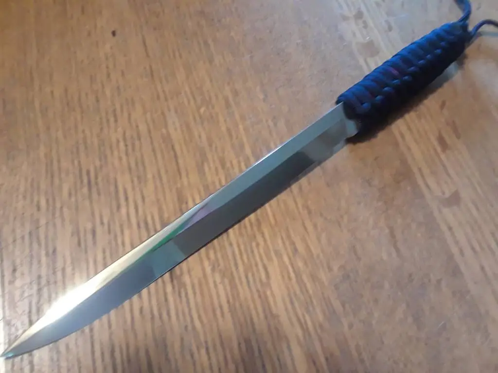

Well, heres a first shot at it. Took a belt sander to a piece of 1/8" x 1" x 12" brass flat stock. Made a letter opener, sharpened it a bit, and gave it a quick paracord wrap.
Fits the size requirements, made of softISH metal and i should be abole to make a nice hole with it..20180502_200442.webp
The original 1/8" x 1" knife works great, but it is a little flexy when I pry.

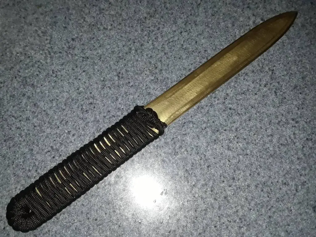

Revision 2 is 1/4" x 3/4", we'll see how that works.20180621_193813.webp
