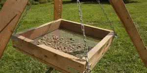

You may want to try the gantry style by using 2x4's. And by utilizing the sawhorse brackets for quick assembly.
You may want to have a crossmember between the two legs, behind the sifter in the first photo.

a couple different ideas from you fine folks have given me the basis for a plan...
take the gantry style and just tweek it a little...4 legs with a cross bar arranged like a swing set. A rectangular box just slightly longer than the bucket on the tractor, suspended from the frame like a bench swing.
Now a handle set up for easier shaking with a gravity assist....hmmm
1320, there can be no or very little lifting. Let the tractor do the heavy work. I can just hold the bucket over the screen box and give it a slight tilt. Then a short handled hoe or garden rake can be employed to move a regulated amount into the screen box. shake and bake.
