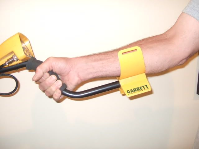

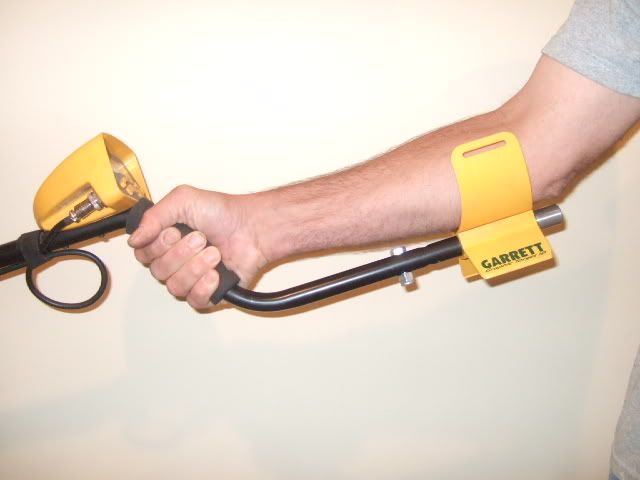

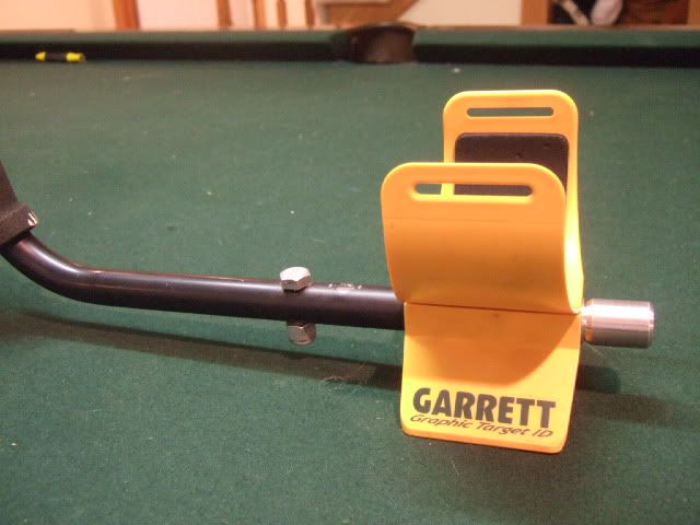

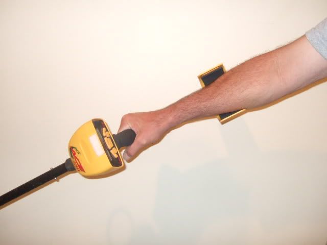

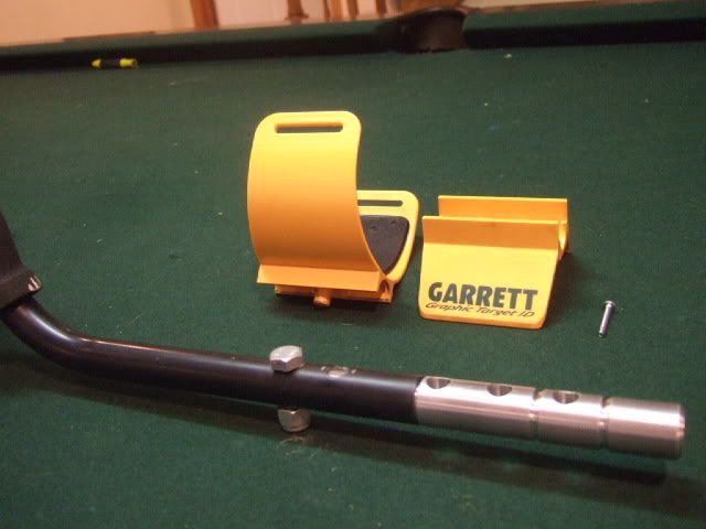

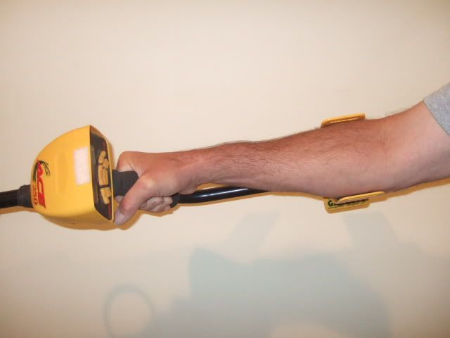

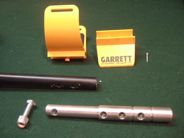

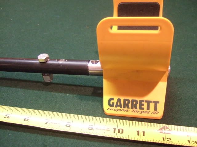

I thought I would post this arm cuff extension I've been working on to my Garrett buddies. It helps with fatigue and reduces the coil heavy feel. Also shifts the balance point 3 inches closer to your grip. Being longer it reduces the torque on your arm. Now the cuff fits on the big area of your forearm for a better fit. I call it the Garrett Gizmo. What do you think?

I don't have an Ace myself, but you did a great job on that mod. I can see how that factory setting would get on your nerves. Looks Good!
I think when Garrett made these machines they thought maybe kids were going to buy them? I never had any machine with such a short arm cuff. Since most users are adults the cuffs don't fit very well. I have been using one of my first extension for over a year. I also gave several away with great feedback. So I made a few changes and decided to share them.

That is one sweet idea. Where did you get that piece for the extension and what was the ID (inside dimension) for the extension tube?
The extension is not a tube. I make them from solid 6061 hardened aluminum stock. I turn the od at .675 for a nice tight slip fit on the small diameter of the Gizmo. I buy the material in large quantities since I'm making several at a time. Your best bet would be a local supply house that sells by the foot.

Since this thread was started, I have purchased a 250. It's a good little machine, but quickly found out that I couldn't use it for long periods of time. I have back problems, and heavy machines just kill me. The Ace is nice and light, but the arm cuff position was a problem as it makes the detector feel heavier than it is. I remembered this thread and ordered one of these extensions to try. Problem solved for me! It does still feel a bit nose heavy, but I can use the Ace a lot longer now. It's much more comfortable to use.
The piece was shipped really fast and is of very nice quality. The fit was excellent. This was something that worked out great for me, so I recommend it for Ace users everywhere. Just my two cents worth. Thanks again Khouse!
