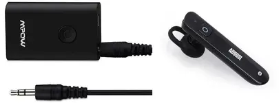

Just got back from taking my new wireless audio mod for a test drive, and it worked perfectly!
I used a Bluetooth transmitter, Mono 1/4 to 1/8 cable, and a BT headset.
Transmitter:
MPOW Streambot Slim Wireless Portable Bluetooth Stereo Music Transmitter
http://goo.gl/8uNj5O
Cable:
Mono 1/8 Inch TRS to 1/4 Inch TS
Amazon.com: Hosa Cable CMP105 1/8 Inch TRS to 1/4 Inch TS Cable - 5 Foot: Musical Instruments
Headset:
Note: Headset must be A2DP (ability to stream music) any BT headset or headphones will work. Also best to get something that has volume control!
August EP620 - Bluetooth Headset with A2DP
Amazon.com: August EP620 - Bluetooth Headset with A2DP - Hands Free Speaker Phone with Media Playback (Black): Cell Phones & Accessories
Issue: This headset only lasts about 3 hours max. For longer battery life I recommend a Plantronics M55 headset

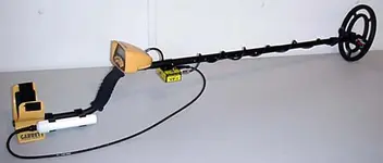

Sunray probe! Not mine btw.
Cool deal. I have the taotronics bt device on my atp. I was experiencing slight lag and attributed it to the headphones. I was right. The bt headphones were super cheap bt headphones and were only bt v2 compliant. I tried my buddies sony headphones and they worked like a champ. I bet they were also a2dp compliant. Cheers!
The Sunray probe is a nice mod! My buddies all have a Garrett Pro Pinpointer: Garrett PRO-POINTER Pinpointer Metal Detector | Manufacturer This will be my next purchase... if you haven't used one you don't know what your missing!
I definitely recommend spending a bit more on the BT headset (they are nice to use for phone calls too). PS: I paired my headset to my phone as well so when I got a phone call while metal detecting I was able to answer without skipping a beat!
