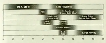

i'm really late and probably just talking to myself, but it says 925 and is probably vermeil, that is to say, gold plated sterling. I found that a couple of very thin, small sterling rings I found read below the coin notches on the 250, as did a vermeil bracelet. A braided chain sterling bracelet, air reads as foil.
This might help.....
Both of the broken bracelets I found last year rang in the foil range, just above iron. One was 10k, one 14k. Unless they are in a pile, (unlikely) there isn't much surface area to catch the signal. If I didn't dig foil, I never would have found them. They sound louder than foil when you are pinpointing, though, unless you get a big ball of foil. (I have dug many, many, MANY balls of foil.)
I found a paper thin 10 k kiddie ring (made in mexico) in a tot lot area once with my ace 250 that I was using at the time --that rang up as foil -- I only dug it up because I was getting coin signals nearby and wanted to get the trash out of my way --lesson learned * tiny thin gold items can ring up as foil with the ace 250.
the co mingling of junk and good stuff together in the same "block" with the ace 250 made me dig a whole lot of "iffy" signals -- (much more often junk than not )-- so I stepped up to a "0 to 99" range numbers type machine (delta 4000- $279) figgering 100 numbers vs 12 blocks - is a lot finer sorting ability wize ( 8 numbers on the delta 4000 vs 1 block on a ace 250 --thus finer sorting = less trash digging -due to better pre digging IDing .-- thus more time spent digging higher probility good targets --of course no machine is 100 % perfect ID wize but I feel its better. well worth the $67 dollar differance.
if hunting gold items once must understand there are some non gold items that WILL overlap into the gold ranges --electric conductivity wize-- like foil and pulltabs ( measuring electric conductivity is how a metal detector "sorts' out what metals it "thinks" it has found differant metals have differant electrical conductity --by its electrical conductivity level-as the machines electric feild it generates reacts to the metal in the ground and gets the return signal and "reads" it as being one metal or another ) --the finer a machine can sort its finds --the better you chances of being able to "pull apart" those close together items electrical conductivity wize --like say pulltabs vs gold rings * with the ace 250 there both in the same "block" so no chose but to dig it all --with the delta 4000 --lots of pull tabs are often say 54 while 10 k rings are say 56 (some tabs still read 56 --sadly) --14 k reads like 66/67
Gold under 1 gram comes up as foil on my 250.
foil signals + pull tab signals + can slaw signals + zinc signals + can slaw signals + aluminum booze cap signals + a lot of effort =
GOLD! ..............enjoy...
