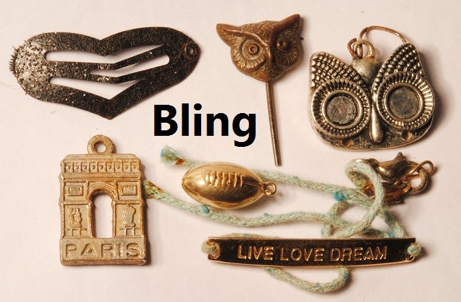

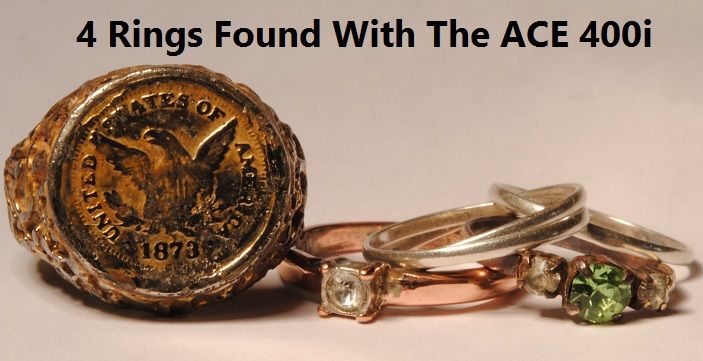

I did manage to dig up 4 rings during my hunts. You can't miss them. They hit hard! The older ACE models were very good for hitting rings, including gold ones. I didn't find any gold rings, however, I did get a solid gold football charm in a sports field! That was a first!
Here are some pieces of jewelry I dug up. If the jewelry is there, the ACE will find it no doubt.
