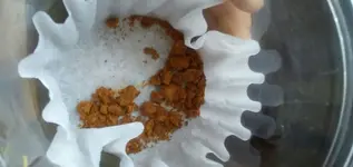

I poured out a little solution from the ore and added a small amount of SMB. It precipitated electric yellow. I poured it back in and it all precipitate red/yellow. As it dried it turned more brown. First try at this.

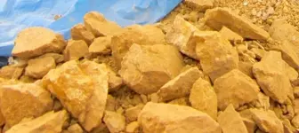

This is what the ore looks like... I am not an expert.
Thanks!
Update.
The pic I posted is ore from Senegal. Mine looks identical from Placer County, California.

I'd like to help you out a bit, BBM610, but for me to do that you will have to address ALL the question I have posed in my above posts. The image of some rocks from Senegal is of no help at all, since a lot of rocks that look similar are just that. Rocks that look similar.

So, I am getting a lot of positive comments on photos of the precipitates.
IMO the AP leach works very well on this particular gold ore. Though, it seems many do not suggest it as a first choice; the precipitate is pure gold.
