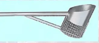

This is the one I am looking at. Has 6x11 bucket...48" overall and is $140.00 plus shipping.
Would this be better than the solid bottom with holes for $125.00 ?
I have an aluminum 5" RTG Pro mini (very lightweight and good for summer fresh drop hunting) and a T-Rex but for deeper holes like you will be digging with a PI detector the Stealth is much easier to empty out when making multiple scoops down for the deepies!
