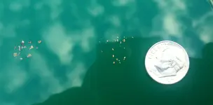

This is the clean up from my trip Saturday the 13th with my dredge. I changed the carpet for rib mat and miners moss and tried a new area on Oleny creek. This was not the best single day but the gold is bigger on average so I think I'm on the right track.image.webp

You're definitely on the right track...keep following that yellow brick road :thumbsup:

I am working in the same location as the last trip, I reopened my last hole and made it a little deeper (approx 30") and another 1.5' father South. So about about six buckets of material. Here is the gold, and the lead, lol that had me going when I panned it down.image.webp
Not a huge amount but I'm still I hopes that I'm getting closer. I just wish I knew if I should go deeper, or concentrate on moving forward?

Thats a good showing for a tank of fuel. Did you change out your carpet for v-rib and moss?
Thanks Kai,
I sure did, thanks for the advise.
You can see some of the gold in the picture is pretty dang small. I think I have a good exchange with this set up too. Even though I have never run more than a tank without cleaning up. I'd say I'm about a quart of concentrates when I do and 90% will pass through a 20 mesh screen.
