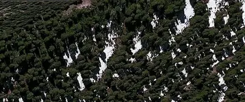

Nice.... I couldn't help but notice this as well .........
Yeah that red spot is what drew my attention when scanning the map the first time. The sulphides pins where already in place from work I was doing with a geological survey map.
I almost have to wonder if it's a wrecked plane or somthing, lol (Not that it would be iron I suppose) Maybe a rolled jeep? Whetever it it is it's sure strong in the iron band filter. I will definately plan to hike up there next summer and take a look.
But nope, it's a big old beautiful solid iron dike! Ain't that somthing.
Center of image is the red spot
