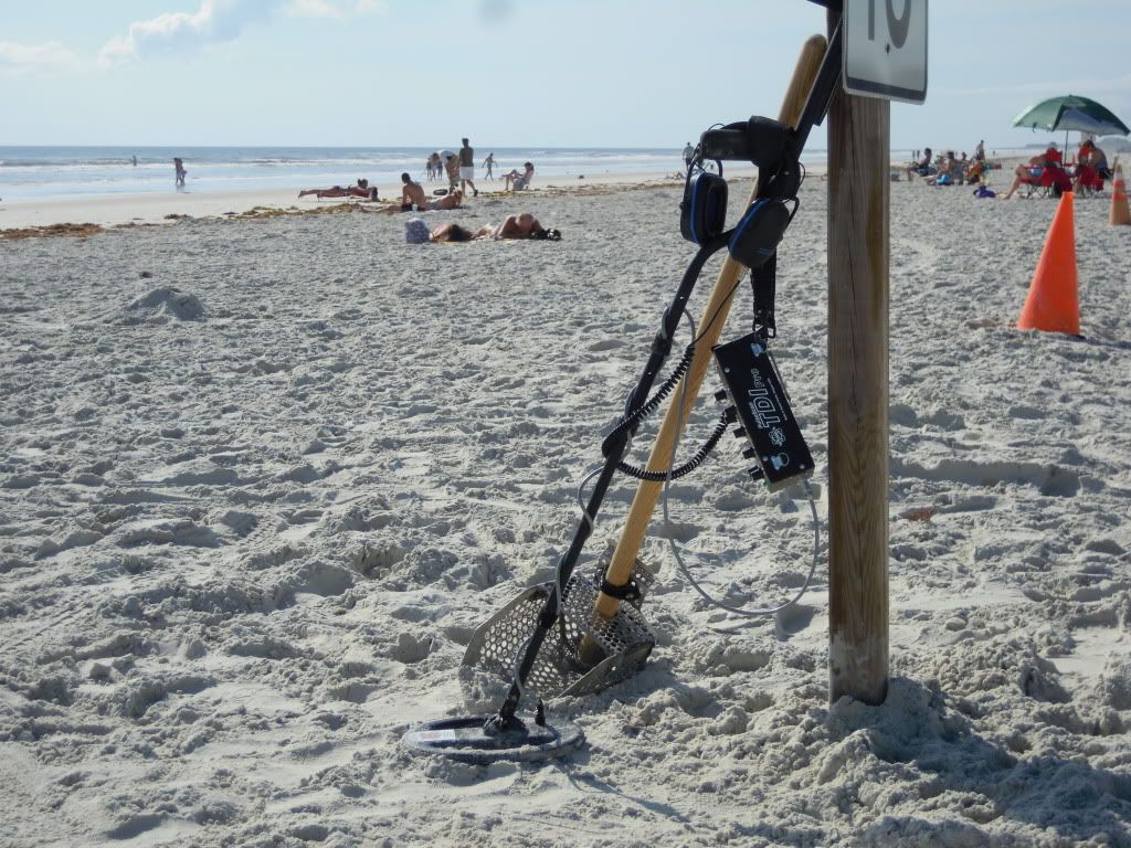

ArizonaAmes,
Thank you for your inputs on the Whites TDI. From how "I" read your post it seems you like the TDI Pro the best, what other TDI models have you tried? In the picture of the machine at the beach I see you have a wired set of earphones. Just recently I purchased a set of TDK wireless earphones from NewEgg(check for coupons for this item) and they work GREAT on my GMT. I put up a thread on them in the prospecting section under metal detecting, Wireless Headphones-Again. In my initial search for wireless one of my "wants" was a set that did NOT have built in batteries and the TDK 700 uses AAA batteries. I've found going wireless to be so very nice simply because of not having the wires in the way, though that may not be of much importance as you are using the chest mount and that IMHO is a super setup, chest mount that is.

I use a wireless set of headphones from Radio Shack when I am using the detector around a lot of brush while prospecting out west in sage brush. On the beach I use a good set of wired headphones, as I chest mount the TDI and TDI-Pro that I currently have. The Pro is more sensitive to small gold and nickles than the standard unit and is a lot more powerful for depth than the SL version due to more powerful batteries. The Pro was redone by Eric Foster to pick up gold better so that it would be a better unit for OZ than the standard unit. I was stunned that I could pick up less than a 1 grain picker at 2 plus inches on an air test.
