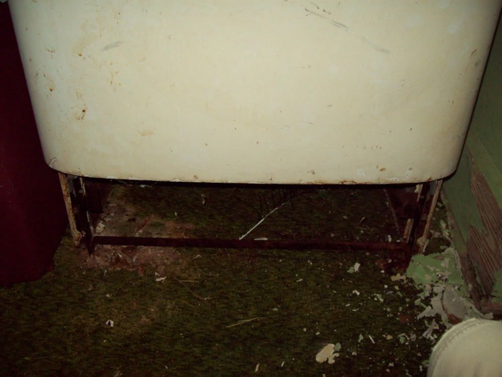

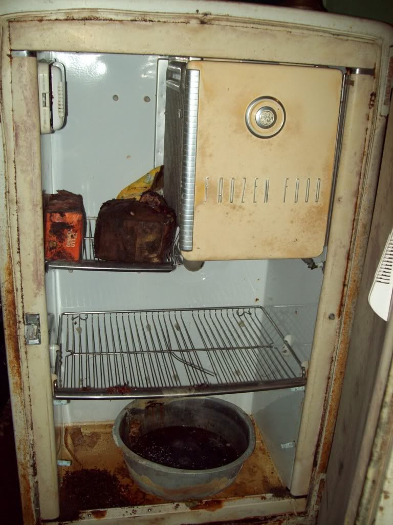

Restoring this thing may be more than I can handle as far as $$$ goes, but I don't think it's impossible. the main problems so far are:
Missing crisper trays (may be somewhere in the attic)
Missing drawer on the bottom (may also be somewhere in the attic)
Very dirty and has some rust
As the poster above stated - hasn't run in a loooong time

First take an extension cord with you. You can run the cord to a working outlet. Listen for any bad rattles from the compressor. If it rattles it probably has a bad mount. When working out the price make sure you grunt & shake your head at every little thing. Can't really tell from the pictures but if the bottom is rusted out not good. Don't be scared to poke at any rust to see if it's gone all the way through. When they give you a price, counter with about half & let them know you'll up your offer when they locate the other parts.
If you're going to sell it as vintage, clean the inside out then soak some towels with citric acid solution and let them sit on the rusty spots. Wipe the outside down with the same solution till the rust comes off. After you've gotten the rust off the outside, give it a good rubbing with some Scotts Liquid Gold. Scotts makes porcelin and paint pop. Touch the chrome up with some Simi Chrome polish. If you have problems finding a buyer or info PM me, I haven't got my sources list with me.
