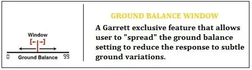

If your threshold is too chattery, turn it down or turn it off. You shouldn't have to turn the sensitivity down unless you are hunting in mineralized soil. The AT Gold should ground balance nicely for you....in fact, it has a range you can set it up for to compensate for changing patterns of mineralizations. using the 5" x 8" DD coil will even help you more in mineralized soils. The only place it will probably chatter is salted sand and salt water. The manual even states that the AT Gold was not designed to work in such environments.
