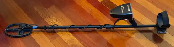

Hey guys please take a look at this. Personally I hate the "S" shaped handles..they don't balance right and cause fatigue so I developed a straight shaft retro fit handle. People that saw it liked it, made some locally and it took off really well, so I patented it and manufacture them. I and others weren't about to pay near $200 for a certain other handle and this one is easy to attach, you don't have to break down the whole detector. Check it out here or Finders Keepers

I'll answer questions in order.. Yes a straight shaft improves balance and is easily felt once used, take notice of all the higher end machines that use straight shaft design and those that use a large coil, a straight shaft helps balance and removes the fulcrum position of where your pointer finger is in an S shaft.
The shafts are made of the same aluminum alloy that Garrett uses but with a thicker wall since my design uses pipe for strength rather than tubing that Garrett uses. As far as my patent process I don't know why that even needs to be answered but it does take some time(several months) but was easier since I'm filed as a micro entity and not that of a larger business,a corporation or a business with more than one person owning the design. As far as fees it also ranges in price to size of business and again due to micro entity it costs only $745 and lasts me for 11 years and that is per item or per kit if that's how it's deemed. There are a lot of people that have and use my tools and the handle. I've had one complaint and that came from a guy who tried to use the sand scoop to dig up then pry up a metal post that was cemented in the ground, covered by sand. The scoop bent and he tried to get a new one for free but his wife wouldn't go along with it and told the truth. He is buying a new scoop now. I build my stuff to last but anything can be abused. Also No the cables are not contained, the retro fit handle is just a handle.the upper part where the handgrip, box and arm cuff is not the whole shaft. Check the website out and see.

There is no distinguishable difference in weight at all and as far as references on Tnet I have none here I do on other sites that I'm mot allowed to mention and the reason for this site is you have to become a charter member before you can sell. I honestly have been selling them through my own website and recently contracting with certain metal detecting supply companies we all know. The pictures you see are actually from a buyer who posted them on another site and how happy he is about his purchase and how its made a difference in fatigue and arm/shoulder pain.
