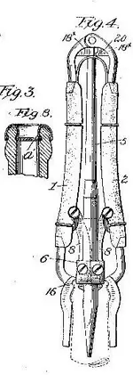

Here's what an antique crown finishing/lipping tool looked like - notice #16 - those long prongs at the end are what touched the bottle's neck and caused the swirl marks.
Thanks for all the info Bob!!!.Yes they are calling tooled top a wiped top.Have seen the tool before
