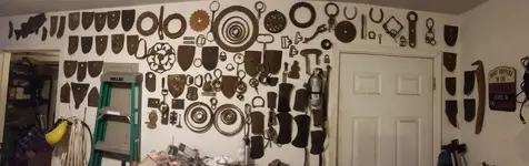

I've done electrolysis on loads of old pieces like that.
Chip off the heavy stuff with a hammer the get a small tub or bucket if that's all you have.
Mix a tablespoon or so of baking soda into a gallon of warm water do it dissolves easy.
I use a big stainless steel bolt on the + side (still alive and well)
Keep your battery chargers clamp out of the water, which means you shouldn't fully submerge either piece.
If you get bubbles it's working.
*You can do the same with crusty unidentifiable coins using an old cell phone charger.
**Don't trap the gas and huff it, don't drink the water, and wash your hands like a normal person when you are done and you'll be ok.
[Edit: correction to polarity]
Neat finds Icewing. It goes to show how many interesting relics people are missing when they block out iron.
Except I don't dig iron on purpose usually. If you will notice a common them that pretty much every piece has a hole in some form or fasion, thus throwing off that conical signal that tricks most detectors.
