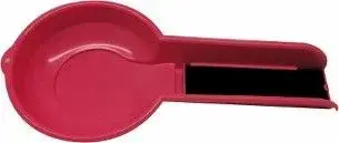

Don't forget these... The "Gold Hex" and the "Banjo" pans.
