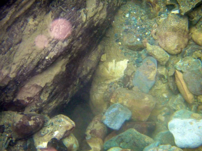

Seems like you will be working this spot for years to come Lanny....SushiDog
Look at that bedrock to the left. Below the cobbles to the right (and buried under them in this picture) is another shelf of bedrock (completely different color) that met the bedrock on the left. It formed a contact zone and caught the nuggets between them. See if you can spot the gold.
Sushi--I sure hope to. A buddy of mine got a nice ounce and a quarter nugget just upstream from where I worked. I figure there must be at lease one more left. I used my underwater detector on the bedrock after I cleaned it and found a little stinker that didn't want to show his face any other way.

Nuggy...thanks for the correction! That is exactly what I meant to say, albeit, sometimes I am at a loss for words with the stuff Lanny is posting...I saw two pieces of gold in that pic you posted...really very pretty blue rock...I am sure I missed some other pieces...SushiDog
Thanks for the clarification Nuggy, and nicely spotted Sushi--one at the top of the big cream colored boulder in the loose stuff, and one at about a 45 degree angle from it on the other side of that darker, eggplant sized rock.

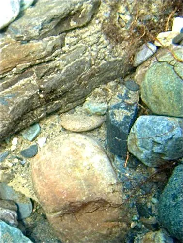

Here's a different shot with a chunk of gold--check out the round flat rock with the blue rock on it, then look what's sitting right tight against the bedrock wall. By the way, the locals are always cruising by checking out every move and looking for free-swimming snacks.

Lanny....that LQQKs like wire gold! SushiDog
Great photos Lanny, I see what looks like the edge of a flat, sassy nugget beside that round flat rock. Pity you can't train those fishes to do a little scouting, I always thought they would probably see some good rich spots. Nuggy.

Sushi--I wish that was wire gold--you're looking a bit too high and to the right. I have found some nice wire gold in this spot, but only in very small pieces. On a different note, nice spot Nuggy, and on a related note about the trout, I found out years ago that the gold and the fish like to hang out in the same spots--the fish may not bring the gold to you, but they love the spots where the river will drop the gold, and in an indirect manner will lead you to likely gold locations.

Lanny....I have never seen blue rocks like that in the river....do you know what they are? (and don't tell me "blue rocks"! ha,ha,ha,ha!)....SushiDog
Sushi, I think those rocks are of the chlorite group. I find many that look like that around Vein Mtn, NC. When I take them out of the water and dry them out they become less blue and more greenish. I could be wrong though, since its hard to tell from a picture.
See the bluish green in this picture, which is of a chlorite schist:
I know this picture is of a schist, but a traverse across an area of metamorphosed fine-grained sedimentary rocks could show schists grading into phyllites, and then into slates. I think a Phyllite containing chlorite is good possibility for those rocks.
I'd only be guessing as to what the blue rocks are--Astrobouncer sounds much more knowledgeable and learned. I know that some of the blue rocks we have contain nickel, but I'd only be guessing on the rest of them.

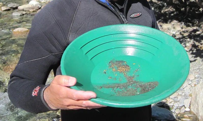

The real deal before panning it down--super concentrates.
Lanny....you have hit the mother load....are you getting all of this gold by dredging?....SushiDog
Sushi--not the mother-lode, some weak cousins. I love to metal detect for gold, and nugget-shoot every season. I genuinely enjoy dredging, but only have a very short season in which to do so. I tolerate sluicing, but have accumulated some nice gold that way--it's just not one of my favorites. The previous shots are of dredge gold; however, you need to remember that I combine dredging and metal detecting--I have an underwater detector that conveniently sniffs out the sassy nuggets that are trying to hide. Its only drawback is that it won't find anything under a gram.
