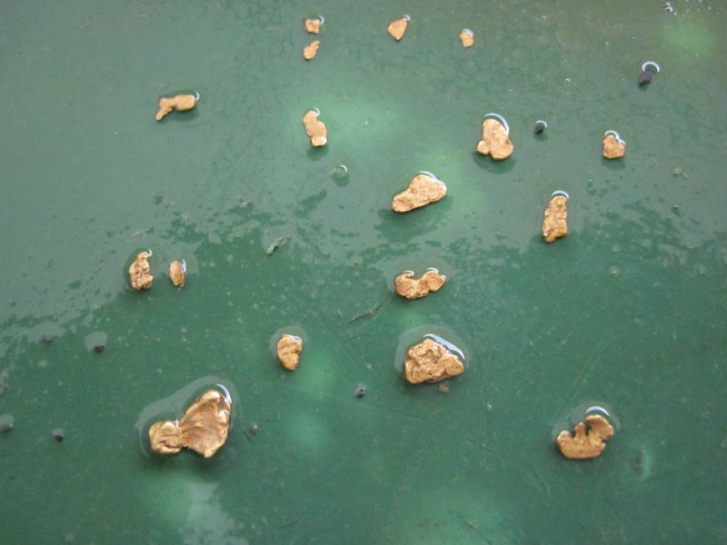

Thought I'd post a shot of this past summer's gold that I took out with my four-inch dredge. For reference, the biggest chunk is about half an inch long. (Since my pictures keep disappearing, I'll just substitute with what I can find.)
All the best you fellow goldseekers,
Lanny

(A lot of my pictures have disappeared--not sure why, so I'll just substitute pictures that I can find. Sorry for any inconvenience.)
Here's a shot of some more gold that I found prospecting,
Lanny
