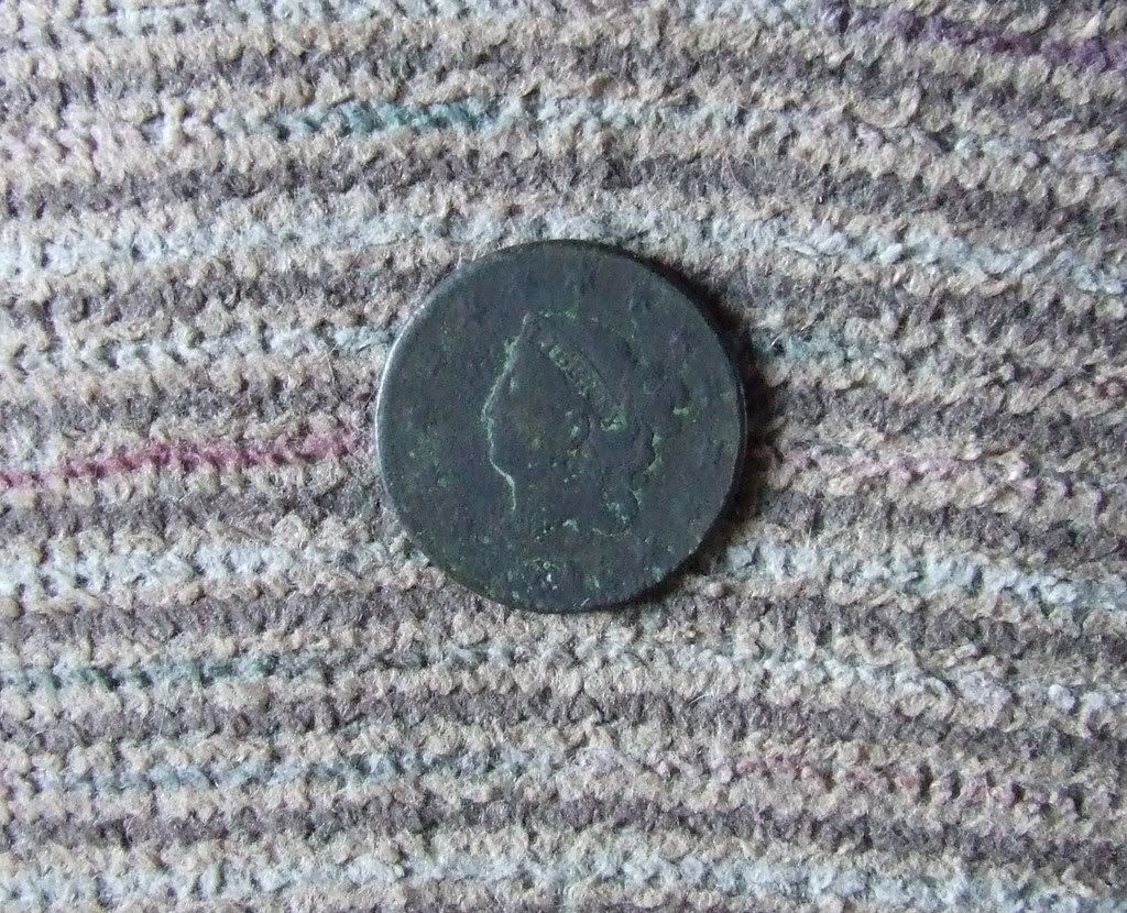

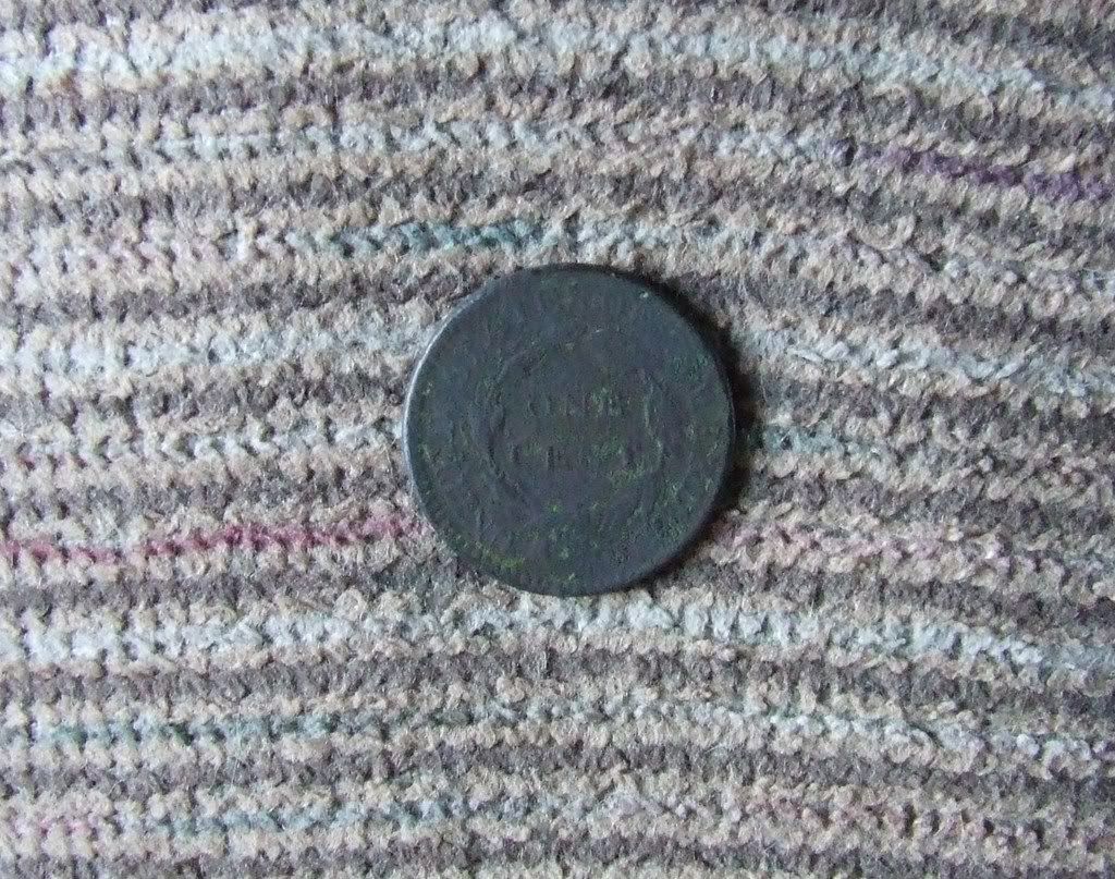

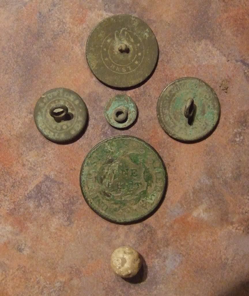

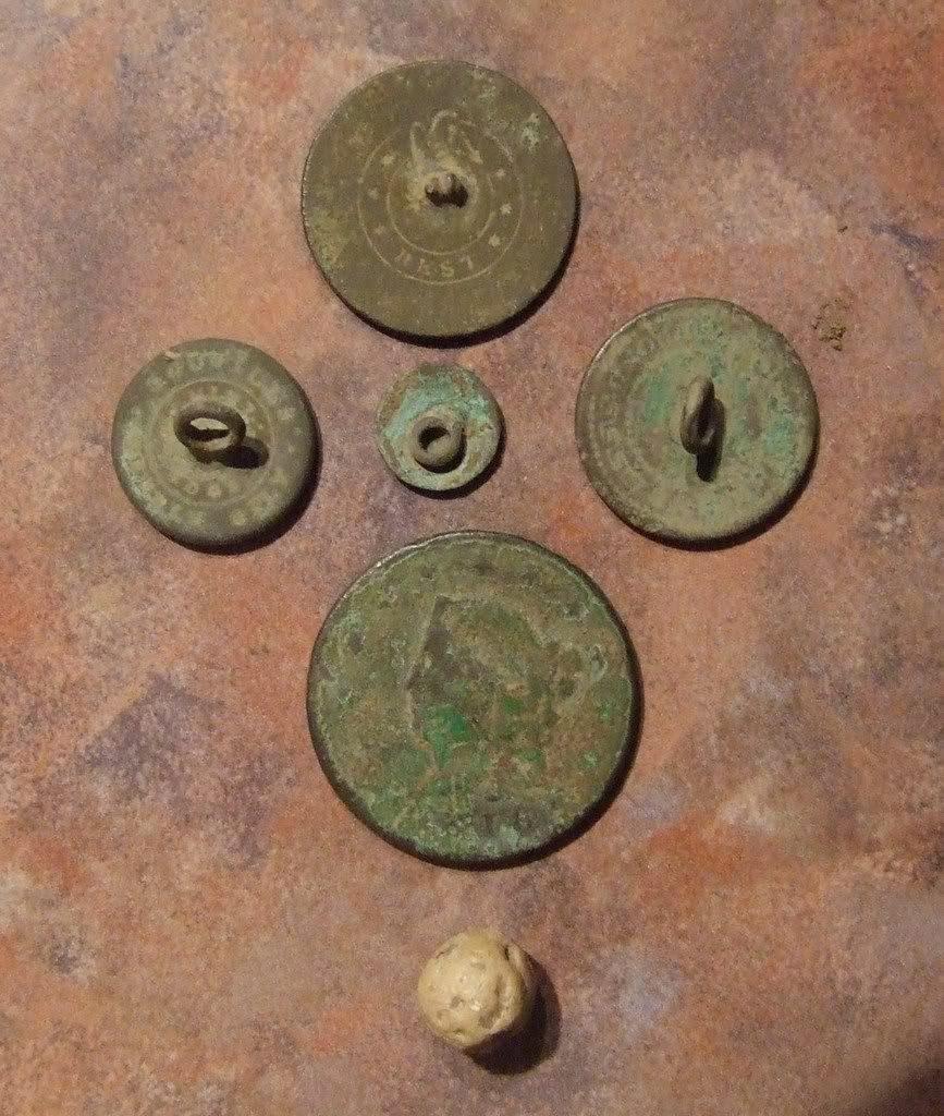

Before and After Pics of Coronet after Peroxide Bath (Other Coronet ADDED)

wow it cleaned the carpet too......LOL
Looks good
Before Pics:
After Pics:
BDD...KylePencil :D
Zoyboy,
That coin looked better UNCLEANED. John Walter would NOT be proud!
BDD...Kirk
