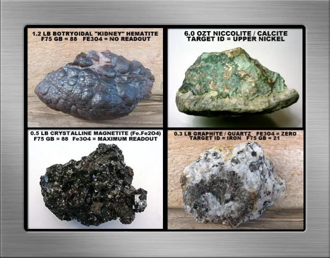

With the above discussion in mind, extremely fine-grained, unweathered magnetite that occurs in pyroclastic material (for example volcanic ash) can drop into the GB45 range, but it is extremely rare. Unweathered volcanics do frequently drop into the GB70's due to submicron magnetite, but the recommended F75 / GB65 compensation point will eliminate those positive signals.

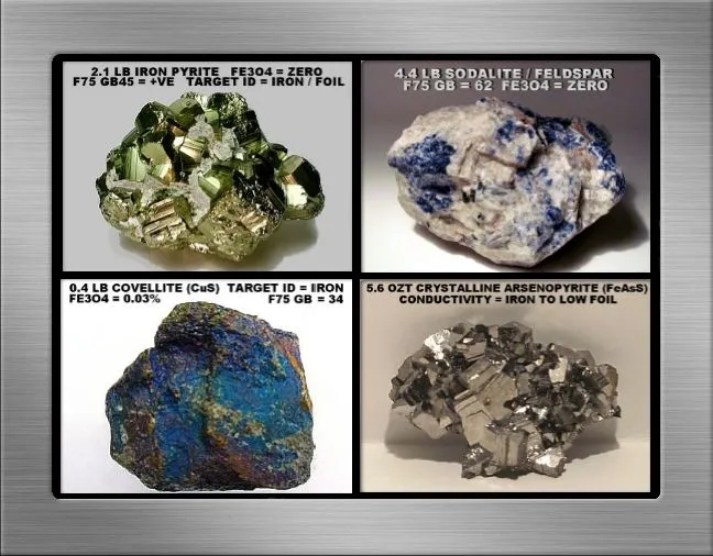

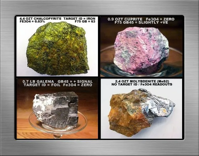

The arsenopyrite sample depicted above is a good example of a commonplace mineral that we encounter in the silverfields of northeastern Ontario. Generally field examples could be described as marginally conductive and many are low-grade. A good many react with only a mild positive signal, and sometimes not at all to a benchtest depending on which GB compensation point is used.
The high-grade, solidly structured sample above produces a strong positive signal in either zero discrimination or true motion all-metal mode with the ground balance control adjusted to the GB compensation point required for our moderately high mineralized soils. As noted, that’s approximately F75 / GB86, although in the field, of course, it varies somewhat depending on location and coil type / size employed.
The response is not as strong as a similar size and shape metalliferous sample would produce, but it does generate a surprisingly strong benchtest signal that would be readily detectable in the field. Even with the GB control dramatically reduced to more conductive values (F75 / GB45), to ensure that any positive signals produced by non-conductive iron mineral inclusions should now only produce a negative threshold signal, it is no surprise that this (non-oxidized) specimen continues to generate a strong signal.
20180605_073755.webp​
For those readers unfamiliar with detector responses to such minerals, the same general response scenario described above with arsenopyrite applies to other marginally conductive minerals such as galena, pyrrhotite and to a lesser extent even iron pyrites. Ordinary iron pyrites is generally innocuous, but maghemitized pyrite, pyrrhotite, and the copper sulfide ores, particularly bornite and chalcocite, can be a real nuisance in the field due to magnetic susceptibility, magnetic viscosity, and / or electrical conductivity, just depending on what minerals are involved.
Such variable responses from arsenopyrite and many other mineral and metalliferous examples clearly infer that signal strength and potential target ID depends on a sample’s physical and chemical characteristics, including the quantity of material within a given rock. These factors include structure, size, shape, purity (overall grade), and magnetic susceptible strength of iron mineral inclusions. Moreover, the VLF detector’s sensitivity, the GB compensation points employed, the coil type and size, and the sample profile presented to the coil further influence benchtest target signal strength and / or potential target ID readouts.
Incidentally, neither of my PI units will respond to the arsenopyrite sample depicted above, even with a TDI Pro equipped with a small round 5” mono coil, the GB control turned off, and a 10 usec pulse delay to deliver its most sensitive detection capability. That result is typical of most, but certainly not all sulfides and arsenides that occur in my areas. Higher grade and solidly structured pyrrhotite, an unwelcome nuisance iron sulfide, and collectible niccolite, a nickel arsenide, are commonplace mineral occurrences here that do respond strongly to PI units, although their respective VLF target ID ranges are quite different.

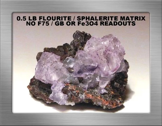

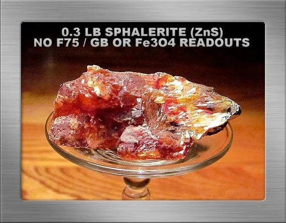

As a related but slight diversion, the photo below depicts a handsome example of the widely occurring mineral sphalerite. It forms in both sedimentary beds, and in low temperature ore veins. It is interesting to collectors because it possesses a dodecahedral cleavage which means that it breaks smoothly in twelve directions, and it is usually triboluminescent, meaning that it gives off a flash of light when struck sharply. Like many desirable minerals lurking in prospecting country, unfortunately sphalerite doesn’t react to metal detectors.
0.3 LB SPHALERITE SF17GG.webp​

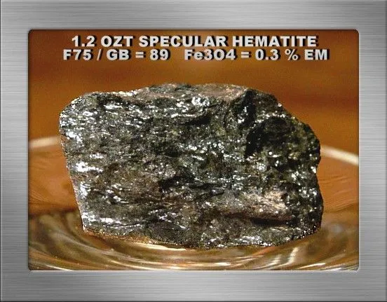

There were quite a few mineral samples that could not be included into this article so let's post specular hematite below. I don’t know if you encounter this material in the southwest. We have some high production iron mines in several localities, including the renowned surface extraction facility at Marmora, Ontario. Unlike other types of hematite (that I know about) this material, although not exhibiting nearly the full magnetic susceptible strength of magnetite, does seriously react to VLF metal detectors.
That's it for now Herb, good luck with your gold hunting trip, we'll look forward to hearing from you when you've returned. Have a great time!!! :)
1.2 OZT SPECULAR HEMATITE SF16GG.webp​

I should have mentioned in the above post that while the F75 / GB45 compensation point mimics the 300 kHz Falcon although obviously it is not as sensitive, the F75’s lower operating frequency and much larger coil size should improve electromagnetic field penetration when testing larger rock samples. Incidentally, I see no reason why other prospecting-capable VLF detectors cannot be used in the same manner providing that a ground balance compensation point is identified such that it eliminates positive signals from all iron mineral types.

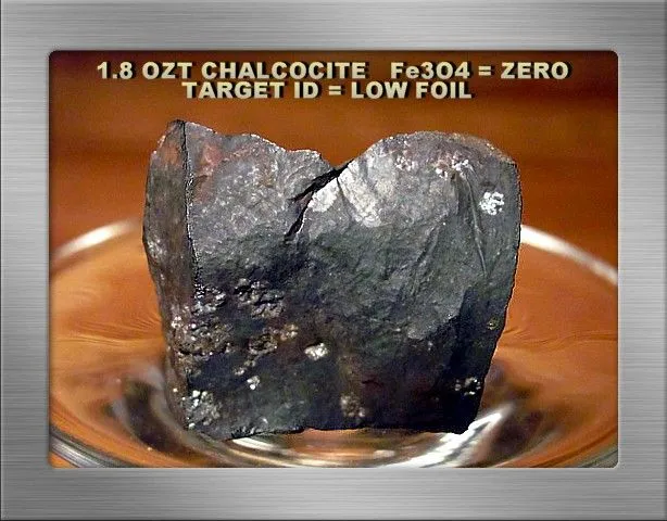

I don’t remember exactly where the sample below came from, although it’s undoubtedly from an abandoned site in the Temagami copper district just south of northeastern Ontario’s silver producing areas. It’s a more typical example of the nuisance chalcopyrite that we occasionally detect in the field as compared to the fine specimens used to illustrate mineralogy texts.
Jim.
PS: Thankyou for sharing that charming campfire photo above. It struck me as an ideal size and shape designed to keep the fire reasonably small and not require too much fuel to keep it good and hot. Absolute perfection Herb, throw another log on the fire for me!!!
1.8 OZT CHALCOCITE SF16YGLASS.webp​

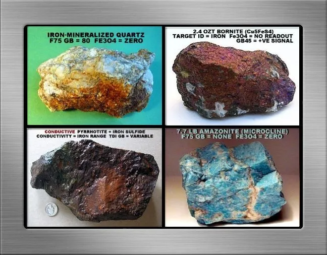

In reading about abandoned mines across Canada, there invariably is a detailed list of associated minerals that include the sulfide group. Sulfides occur everywhere because they form in hydrothermal veins, in magmas, and some such as iron pyrites and marcasite (iron sulfides) even form in sedimentary environs. It is not unusual to find several sulfides in close association, for example galena, sphalerite and frequently fluorite are commonly found together.
Sulfides are the major ores of many metals such as lead, zinc, silver, iron, antimony, bismuth, molybdenum, nickel, and copper. Gold is also commonly found in sulfide deposits. Many sulfides and other indicator minerals are not detectable in the field due to ground effects, but sometimes do respond with a positive signal to the F75 / GB45 benchtest compensation point or equivalent on other VLF detectors. So while there are obvious shortcomings, the technique could prove handy either in the field or back at home for checking suspect rock samples. That's about it for now, thanks again for popping by!!! :)
0.5 LB FLUORITE SPHALERITE DEFRAME SS17BB.webp​

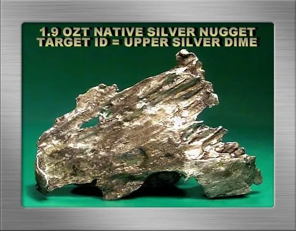

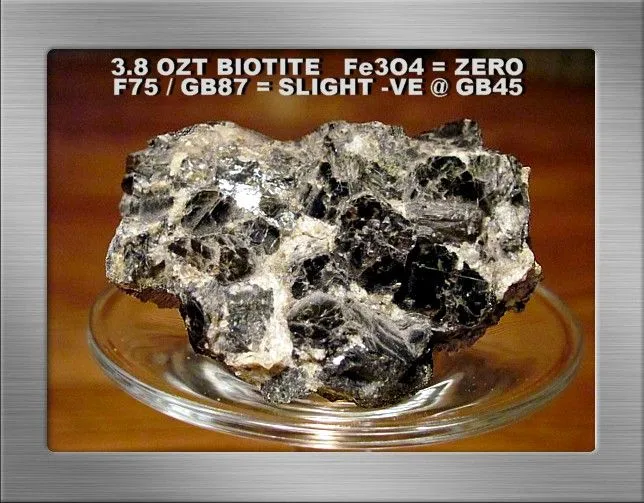

3.8 OZT BIOTITE SF17GGLASS.webp​

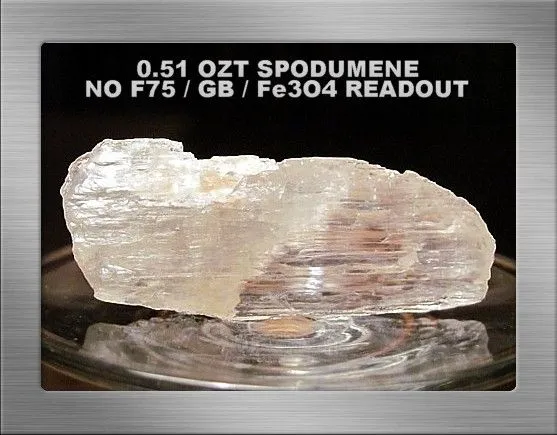

The photo immediately below is a lithium aluminum silicate called spodumene. You are probably familiar with this mineral although the color variations are labeled differently. This colorless, opaque to translucent example is further identified as cymophane. It came to me years ago from a California mineral collector who wanted to trade for some native silver. He also exchanged some purple spodumene called kunzite, but it doesn't take a decent photo.................... Jim.

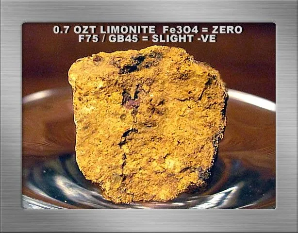

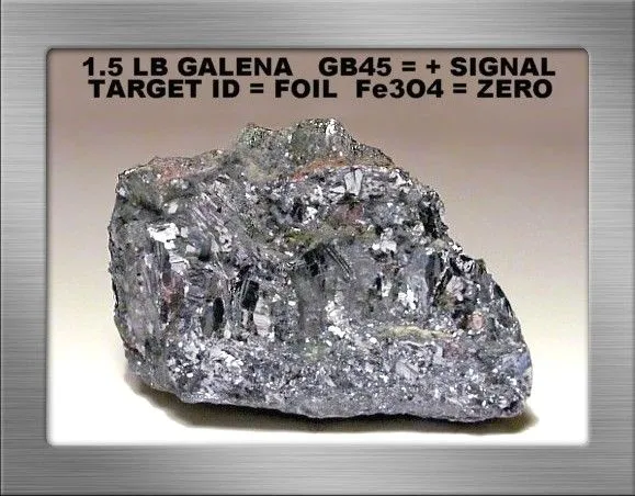

1.5 GALENA ORE DEFRAME SS17BB.webp​

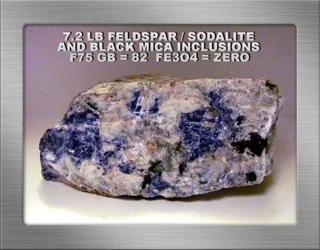

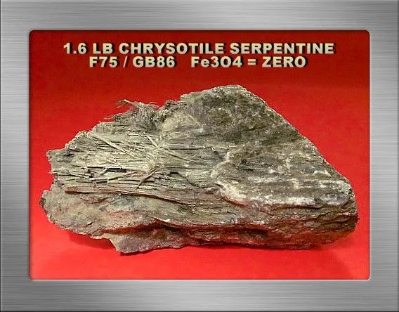

7.2 LB SODALITE SF18WGREDO.webp​
