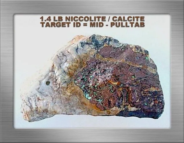

The arsenopyrite sample depicted above is a good example of a commonplace mineral that we encounter in the silverfields of northeastern Ontario. Generally field examples could be described as marginally conductive and many are low-grade. A good many react with only a mild positive signal, and sometimes not at all to a benchtest depending on which GB compensation point is used.
The high-grade, solidly structured sample above produces a strong positive signal in either zero discrimination or true motion all-metal mode with the ground balance control adjusted to the GB compensation point required for our moderately high mineralized soils. As noted, that’s approximately F75 / GB86, although in the field, of course, it varies somewhat depending on location and coil type / size employed.
The response is not as strong as a similar size and shape metalliferous sample would produce, but it does generate a surprisingly strong benchtest signal that would be readily detectable in the field. Even with the GB control dramatically reduced to more conductive values (F75 / GB45), to ensure that any positive signals produced by non-conductive iron mineral inclusions should now only produce a negative threshold signal, it is no surprise that this (non-oxidized) specimen continues to generate a strong signal.

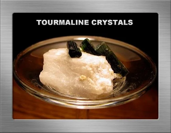

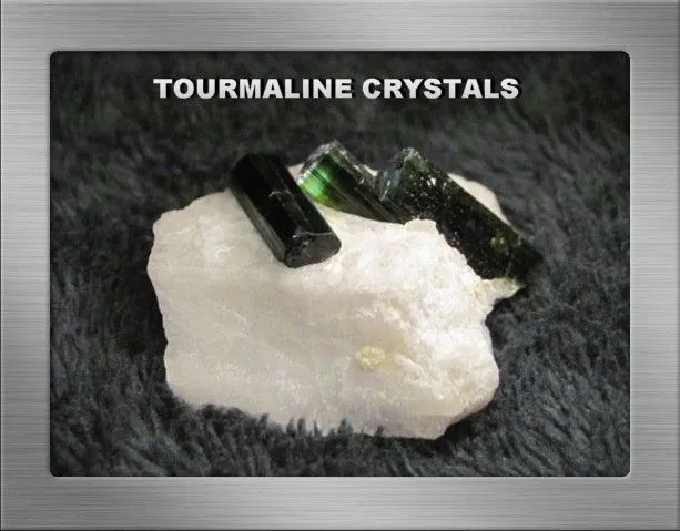

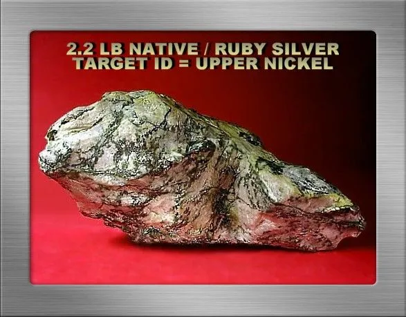

Now let’s look at an example. The rock below was found by eyesight while hiking along an old abandoned rail line traversing an area I wanted to explore. The rail line bedding was created from discarded mine tailings. I saw this calcite rock lying on the surface, picked it up and observed that it had flecks and spots of either pyrite / chalcopyrite mineralization. There were a couple of small veinlets of lustrous gray material as well. These I recognized as oxidized, but non-conductive ruby silver. So I put it in my knapsack to check back at camp.
I didn’t need to do ground balance adjustments, because as you can see, it produced a good strong signal sufficient to provide a target ID. But out of habit I reduced the F75’s ground balance to GB45 to eliminate any possibility of non-conductive iron minerals producing any signal. The result was the same. This is a fine example of benchtesting a suspect rock that produced a positive result. It encouraged me to do further work on it, an acid bath to expose the silver within it, followed by a rotary tool and silicon carbide bit to finish it..................... Jim.
2.2 LB NATIVE RUBY AG SFYGG18RDRS.webp​

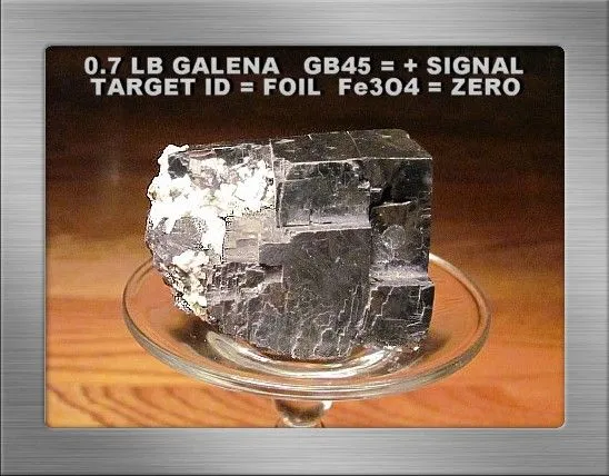

In the autumn of 2011, I was trenching a very productive area that opened into a pocket of white calcite ores. These had little or no indication of silver on the surface, but we have learned not to ignore calcite ores because they’re typically associated with the original silver veins and frequently contain some amount of silver.
Some samples would respond in true all-metal motion mode but many of those would not generate a target ID. The ones that continued to signal at GB45 (to eliminate positive iron mineral signals) were kept. Prior to heading home later in the season, thinking they really had no value as specimens, I dropped them off to a local friend who operated a small smelting operation at the time. He later messaged me that those rocks averaged one-half OZT refined Ag per pound of rock processed. That information did surprise me.
I gained a new appreciation for the value of benchtesting suspect rocks / ores, and the desirability of eliminating any positive ground / iron minerals responses. As has been discussed here earlier, a rock that continues to signal at F75 / GB45, or its equivalent on other detector models, should be investigated further to identify the conductive substance producing the signal.
Even a 13 kHz F75 provides a very sensitive benchtest at GB45, and this is particularly so because with most rocks I’ve tested, there has been little or no evidence to suggest that ferromagnetic minerals have substantively affected the benchtest’s sensitivity. That means I’ve usually seen very little difference between the F75 / GB86 and F75 / GB45 test results. In any case William, I think it is better to at least know about this technique, even if you have no need for it most of the time……………….. Jim.
0.7 LB GALENA GLASS SF16GG.webp​

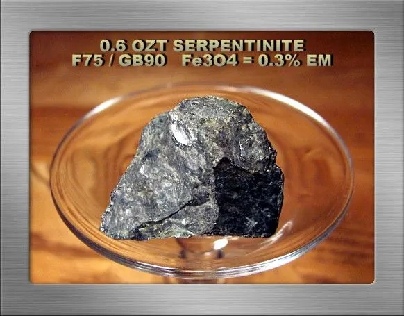

Hi William… I have a small sample of serpentinite depicted below, that I’ve checked with my F75. At 0.3 % equivalent magnetite and a GB90 readout, in some areas it could be VLF detectable as a surface negative hotrock, particularly using a sensitive high frequency VLF unit. You might try to find a similar size dark sample that is roughly an inch in diameter to test on your V3i. My sample was benchtested using a 10” elliptical concentric coil.
Prior to reading about it in my mineral field guide today, I didn’t appreciate that the process referred to as serpentinization also produces magnetite and brucite. Although serpentinite is a low-grade metamorphic rock, the grade can vary from one area to the next depending on the parent rock material. That means that your readings may vary somewhat from mine, although we should still expect to see an Fe3O4 readout indicating some modest level of magnetic susceptible strength………………. Jim.
PS: a concentrated black sand sample would do fine to check as well.
0.6 OZT SERPENTINITE SFGGY17.webp​

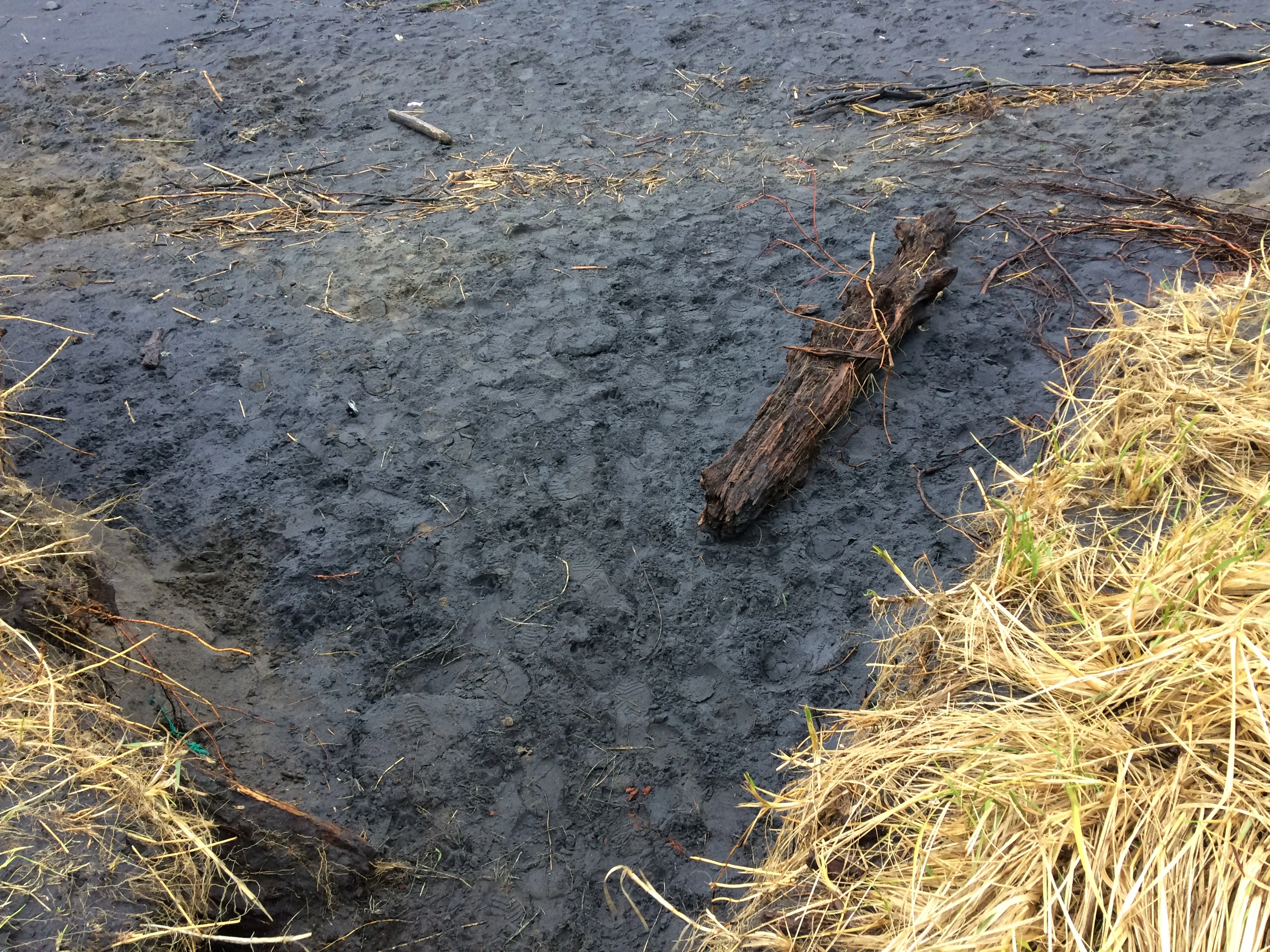

WOW!!! Over the years I've hunted many freshwater beaches here in Ontario, including our fabulous beaches along Lake Huron and Georgian Bay (Wasaga Beach for example), but I've never seen anything remotely close to what is depicted in your photos.
No, I don't suppose you'll have any issues with collecting some black sand to check on your V3i metal detector. Thanks William for posting such unique and fascinating scene photos. :cool:

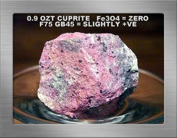

Hi Jim.
If you would like some of that black sand I would be happy to send you some to sample and play with...
Heck there might even be a bit of beach gold in it.....:laughing7:

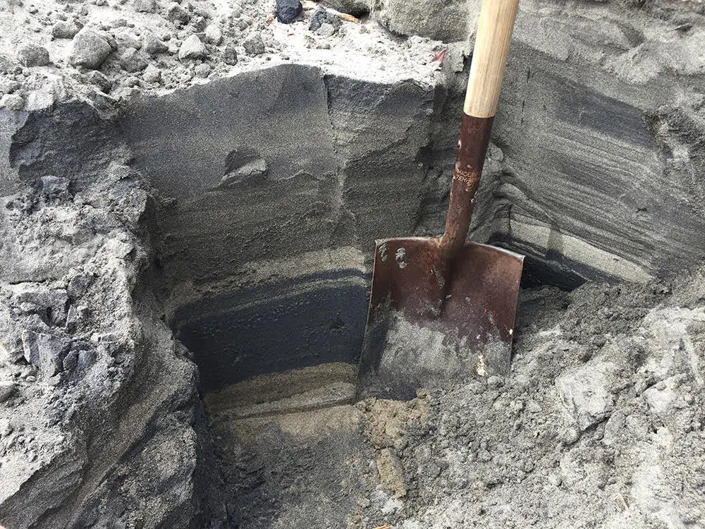

Here is another pic of a black sand layer that ya have to dig a little to get to.

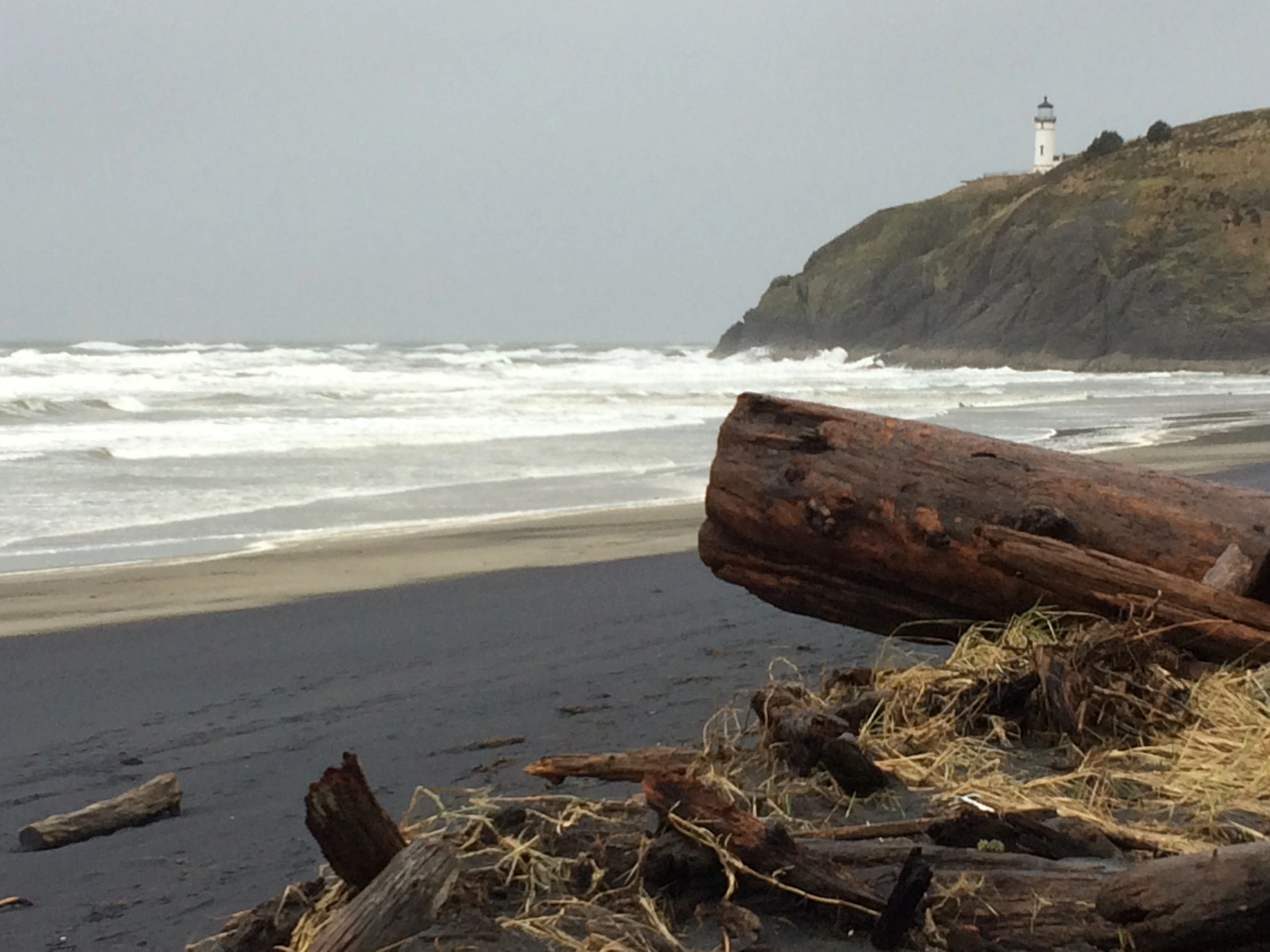

This pic and the surface pics are from Cape Disappointment. It is the S.W. point of Washington State just south of the light house.

Question: why is it named Cape Disappointment? Is it because there is no natural shelter / harbor available for ships caught in stormy weather? It does sound rather ominous.

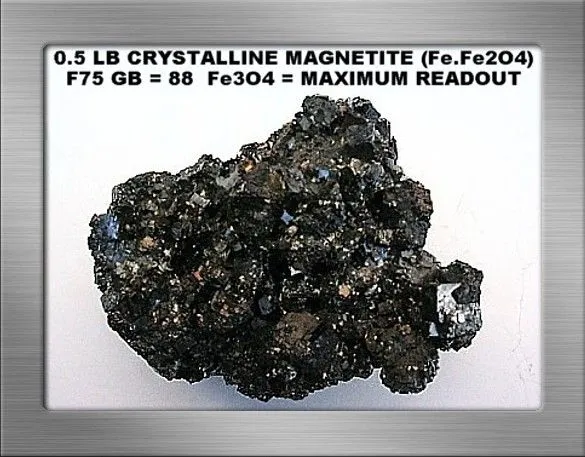

Below is crystalline magnetite with the readouts for you. I think your black sand ought to give you similar, although perhaps not identical readouts. You might want to check and see how your V3i responds for comparison sake………………….. Jim.
0.5 LB CRYSTALLINE MAGNETITE SFBBRS.webp​

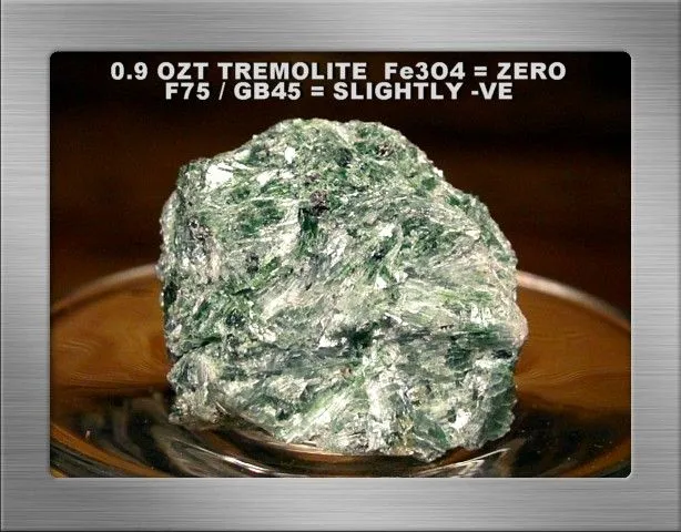

Quite different results between my two units, it might be a good idea for interested hobbyists to run this test to evaluate how their own detector model responds at various GB compensation points to a tiny metal target.
Thankyou very much Terry for your thoughts on the subject as they pertain to your Goldbug2. This is exactly the type of technical comment from a veteran nuggetshooter that I had hoped for when I posted this article. :icon_thumright:
Jim.
Hi Jim....
Not sure how the cape really got it's name but this seems to be the recorded version.
English fur trader John Meares names Cape Disappointment on July 6, 1788. - HistoryLink.org
An excellent read that does clarify how the name "Cape Disappointment" came into existence and has survived alternate names from other explorers. Thanks William, it was a very captivating, historical article that renders my earlier surmise about a lack of safe haven / harbor as totally irrelevant....... Jim.

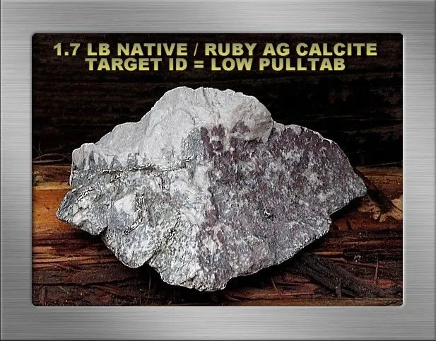

1.7 LB RUBYNATIVE AG SFYG18.webp​

1.4 LB NICCOLITE SF17BG.webp​
