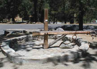

Screenshot_2016-09-26-15-31-30.webpthis is just part of the huge Site.this is mainly the ore processing site.you can see circles on upper left and a big rectangle on lower center..my theory is that in the circle structures the ore was crushed down and sent down (the incline is really steep).trough canals (straight lines) down to the rectangle structure where the ore was milled with a huge metal wheel..the wheel is like nine feet across.. I have no Idea as to how those pieces of machinery was transported more than a hundred years ago.really a big achievement by itself..the wheel has a stamp from Saint Louis . it was made in the USA..to the lower right out of the pic is a small creek.across this creek are the structures where the Bullion was stored. I think a nice metal detector there will reveal nice things..
I think It the Mexican Marines could provide security if Requested. they are the only ones still respected by people down there.the consulate might forbid you from taking arms into Mexico.there's a Canadian company close to this site called GOLD CORP.and they 're paying armed Men (federal policemen) to protect the installations and guard the administration's personnel's convoys going in and Out..
S5031319.webpS5031316.webpthis is one of the structures on the Satellite picture. some canals run right through it .I have No Idea why they would do that.the second picture is from the Bullion storage Building. (To the right of satellite picture .not shown).notice the small windows at shoulder height suitable for long arms to protect the Bullion.

IMAG1453.webp I got this picture of the Structures with a computer which has more detail than the image I got from my Phone..notice the canals running down from the rounded structures to the rectangle structure..
