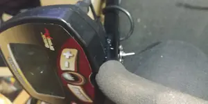

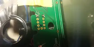

Tried the same Mod for Pinpointer on LRP on my QDP.Well,did not work,but did no harm.Not rocket science,so figured out which pads to use.Turns out Pad #1 is the same as RLP,but other connection needs to be on Pad # 5.They are numbered on opposite side of board from LCD.Just got done testing it,works great! I use it a lot Coin shooting,but was getting mostly unuseable,or at least a big PITA !
My board had date of 2/20/2014 Rev 1 on it.Others may be diff. PERFORM AT YOUR OWN RISK!
Anyways,hope this helps anyone with same prob.Any input,questions,welcomed.
First pic shows board with Pad #5 marked.Second pic shows completed PP toggle installed.Sorry didn't get more pics.
