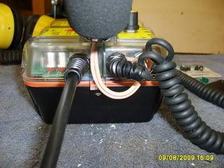

Thanks Treasure Hunter. It's already been out of warranty for awhile. My background is communications repair and this should be an easy modification for me. I'm aware that it will have to be hard wired in. I just bought a phone jack, cable and small external amplified speaker and will make modifications myself. Going to have the option of speaker or differant and more comfortable headphones. After that I'll tackle the three LED lights and parallel them to go up on top of the pole. The pinpointing toggle switch will also be moved to a forefinger or thumb useage position. Thinking of putting the amp/spkr on a neck strap or shoulder harness. One way or another I'll make everthing on the box and pole waterproof. Thanks

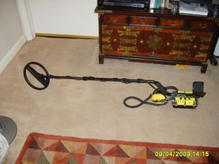

Finally got around to putting my new EXcelerator coil on. Real problem was cleaning my shop up so that I had room on the bench to do the work! LoL Relatively easy to do. Tried it out in my yard and seems to really work well. When I get time I'll take it down to the beach and see how it does in the water. Coil supposed to have a negative buoyancy and hope it will have a vast improvement over the stock coil. My original coil was not a yellow spider coil like the newer BH ID 300's. When I get the chance to find a new water tight light housing, I'm going to work on moving the LED's up on top of the shaft. Thanks "Willee" for the coil suggestion.

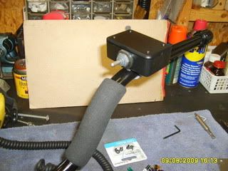

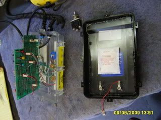

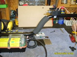

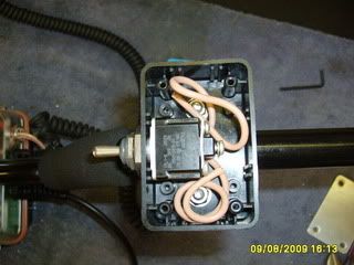

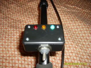

Got around to doing more on the modification today. Removed LED's, ran wires thru handle, mounted box and relocated toggle switch to box. Gonna try and mount LED's into box tonight or tomorrow. Here's a few pictures.

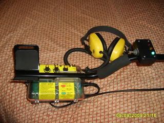

Semi-Finished. If only I could find an Amphenol connector to change to my Grey Ghost phones!
Took my "modified ambidextrous" BHID to the beach yesterday and the results were very good! Being left handed I now only have to look at the top of the shaft for the indicator lights. Also its sooooo easy to use the toggle switch for operation selection. It's really a breeze to pinpoint, go back to discrimination and reset. The new EXcelerator coil doesn't float up anymore! Yeah! With the larger 10" EXcelerator coil I use the spiral inward method to pinpoint my targets. I really love my BHID now that it is user friendly!

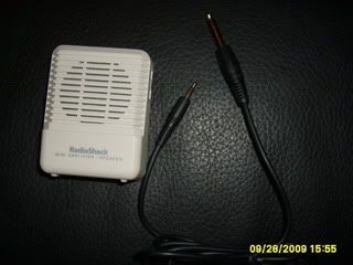

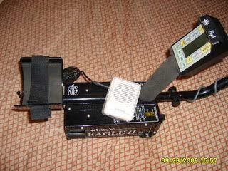

Here's a couple of pics of the speaker amp shown on my Eagle II SL so you can get an idea of it's size.
