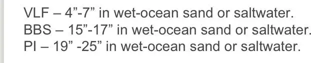

You won't dig iron for sure but doesn't have a very deep depth rating either. It's a VLF machine
And I've owned one before and did well with it but needed more punch for depth. Maybe an 1/8 of what your dualfield can reach!

My VLF machine hits a lot deeper than 4 to 7 inches.
Yeah if I remember correctly I think I dug some 8-12" targets with my beach hunter 300 iD I liked it a lot and a hunting buddy talked me into a pi and I wasn't happy digging all that iron so I missed it! Found 7 rings 8 days out in the dry and wet sand.
I didn't say it can't detect deep I said it doesn't have a deep depth rating

Huh?: "I didn't say it can't detect deep I said it doesn't have a deep depth rating"
Someone said theirs detected deeper then 4-7" and I responded with A statement that a VLF isn't "rated" as a deep machine not that it won't detect deep.
