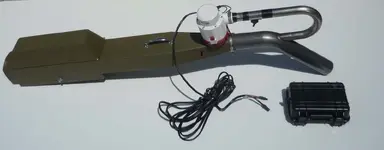

Ok-without causing a p****** contest,what about a large bilge pump going into a small venturi with a 1"-1 1/4" suction hose run it off of a battery,for sniping and cleaning cracks and bed rock (not for over burden)possibly dumping it into a 5 -gal bucket or a sluice box?for smaller creeks ( to small to dredge) it would be very portable ,quiet,could even recirculate the water when scarce,and would be more productive than a hand sucker.anybody ever tried this route?
Seems like a pretty cool concept OV!! I have been thinking along those lines for a few years but never got around to building anything. Today I noticed on Ebay the electric submersible dredge from Australia. I see another member already mentioned it. LOL.
to gain suction for a dredge nozzel, the gph of a pump isnt the main factor,what you need is pressure. on this small of a nozzel, pressure can be aquired by reducing the water into the nozzel by a orfice at the nozzel. there are some really big 12voltDC pumps out there that would work,but they pull a lot of juice to run them. you would need several 12 V batterys and then how big of a solar pannel would it take to recharge/top off these batts while running??and then hiow portable would this be while snipping? a off/on switch would be manditory to save juice! good luck, i hope you get it to work!
