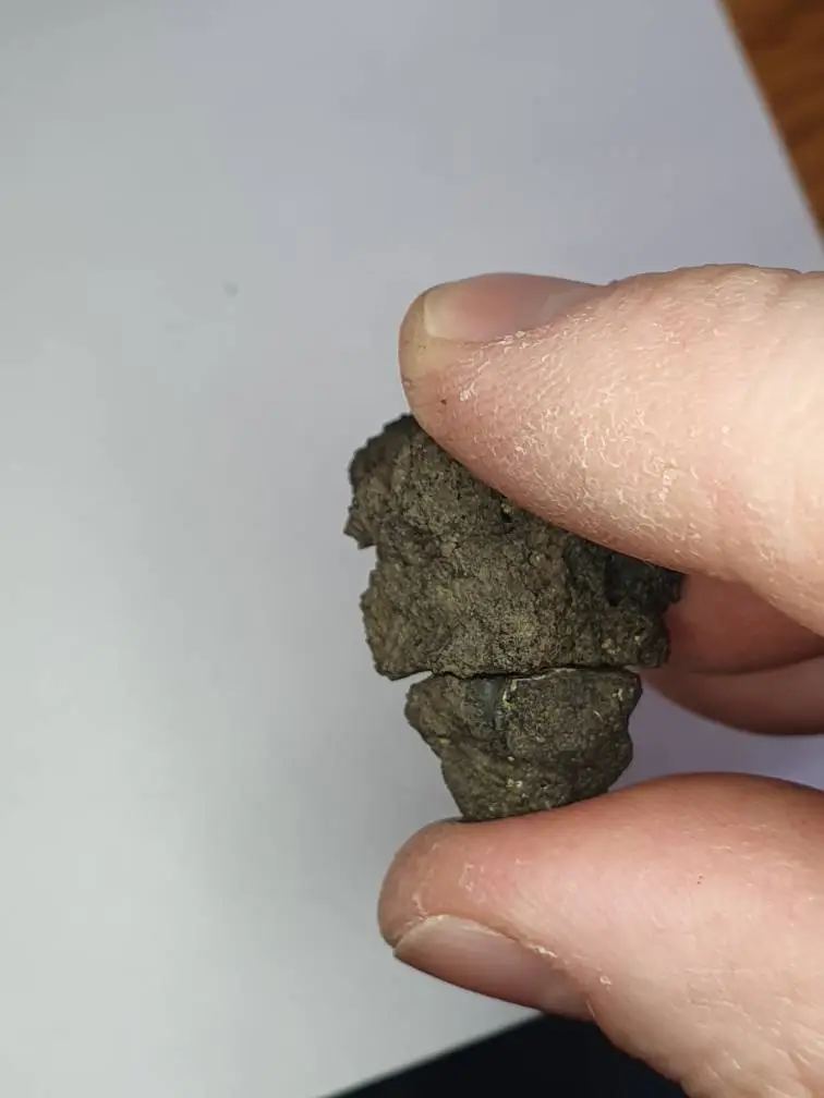

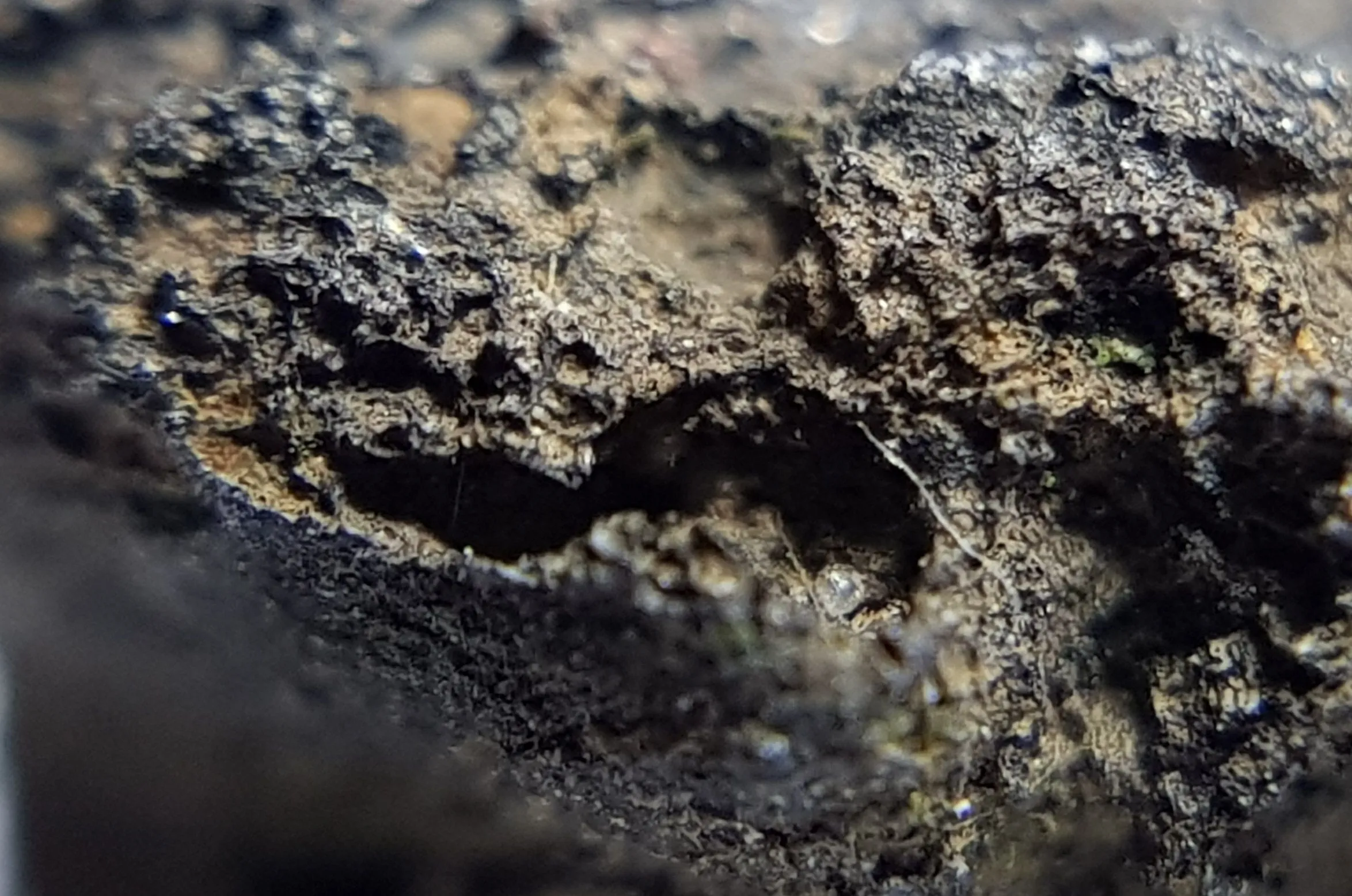

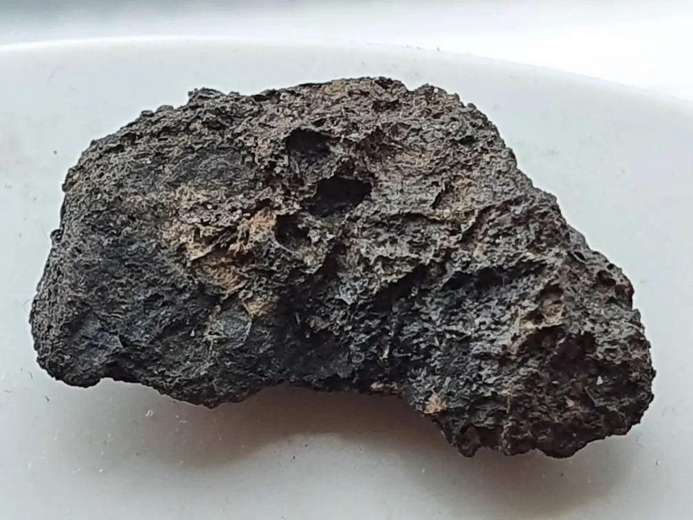

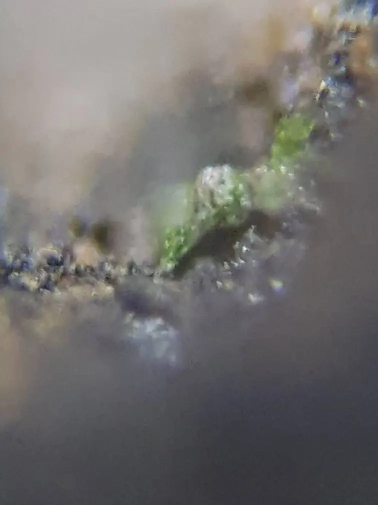

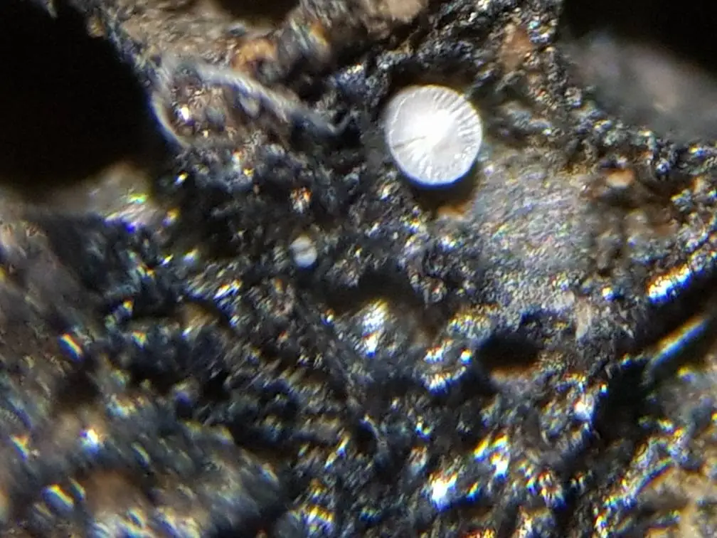

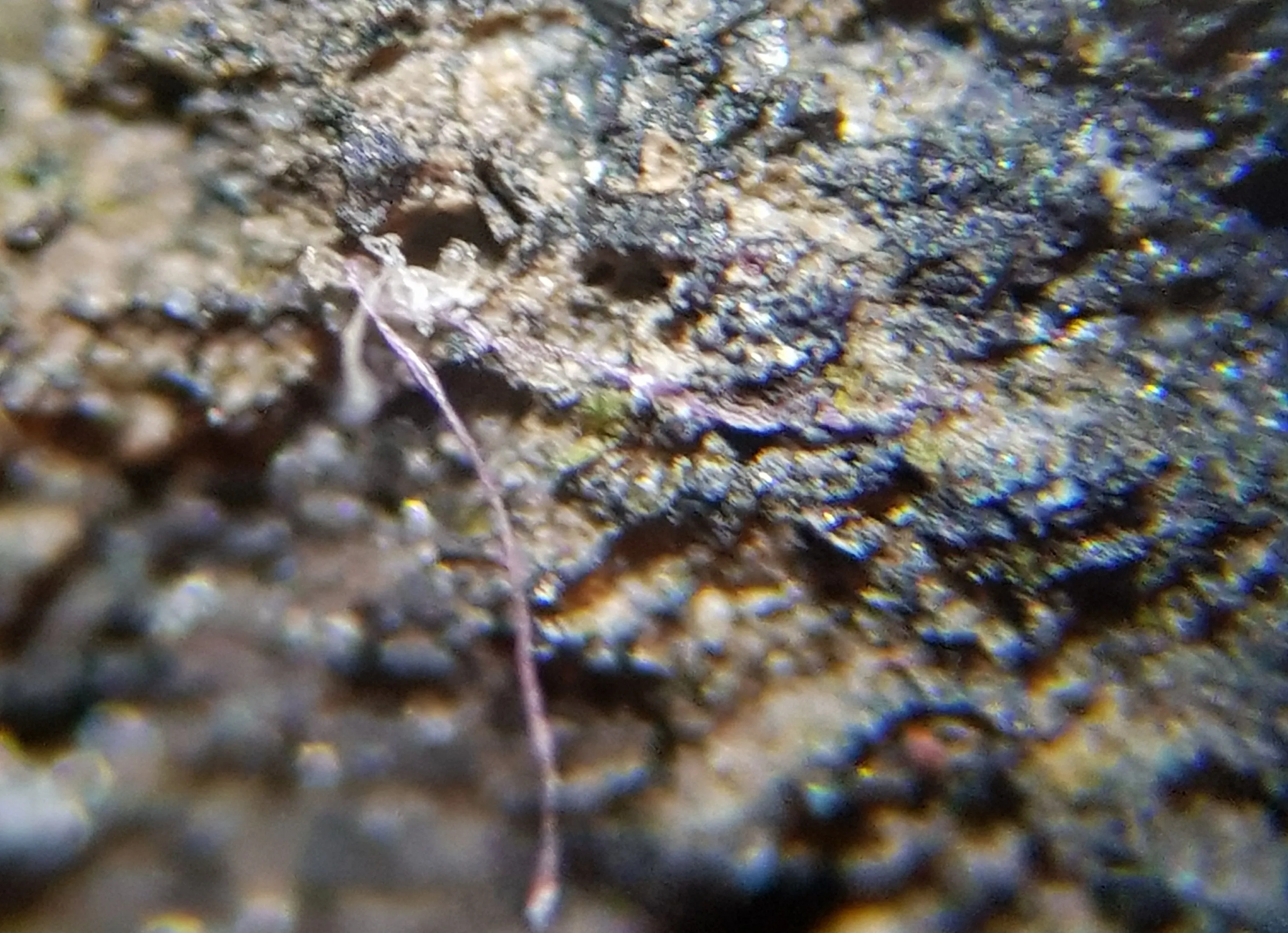

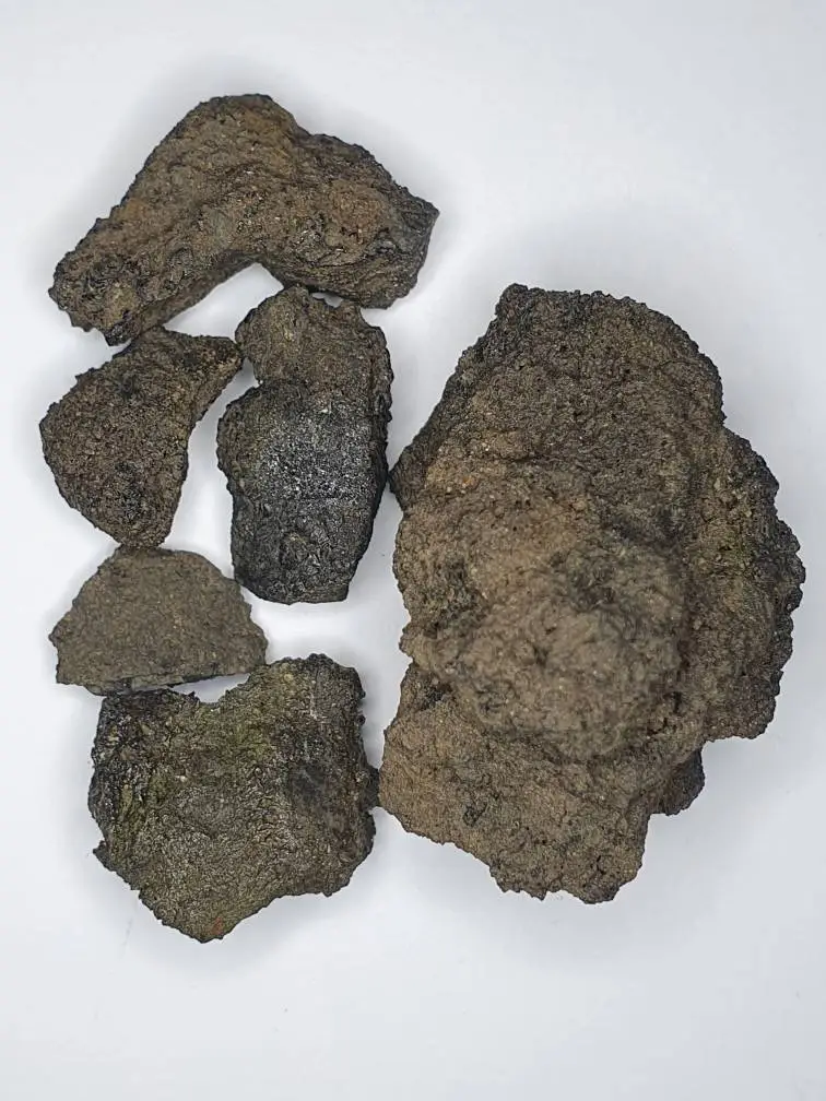

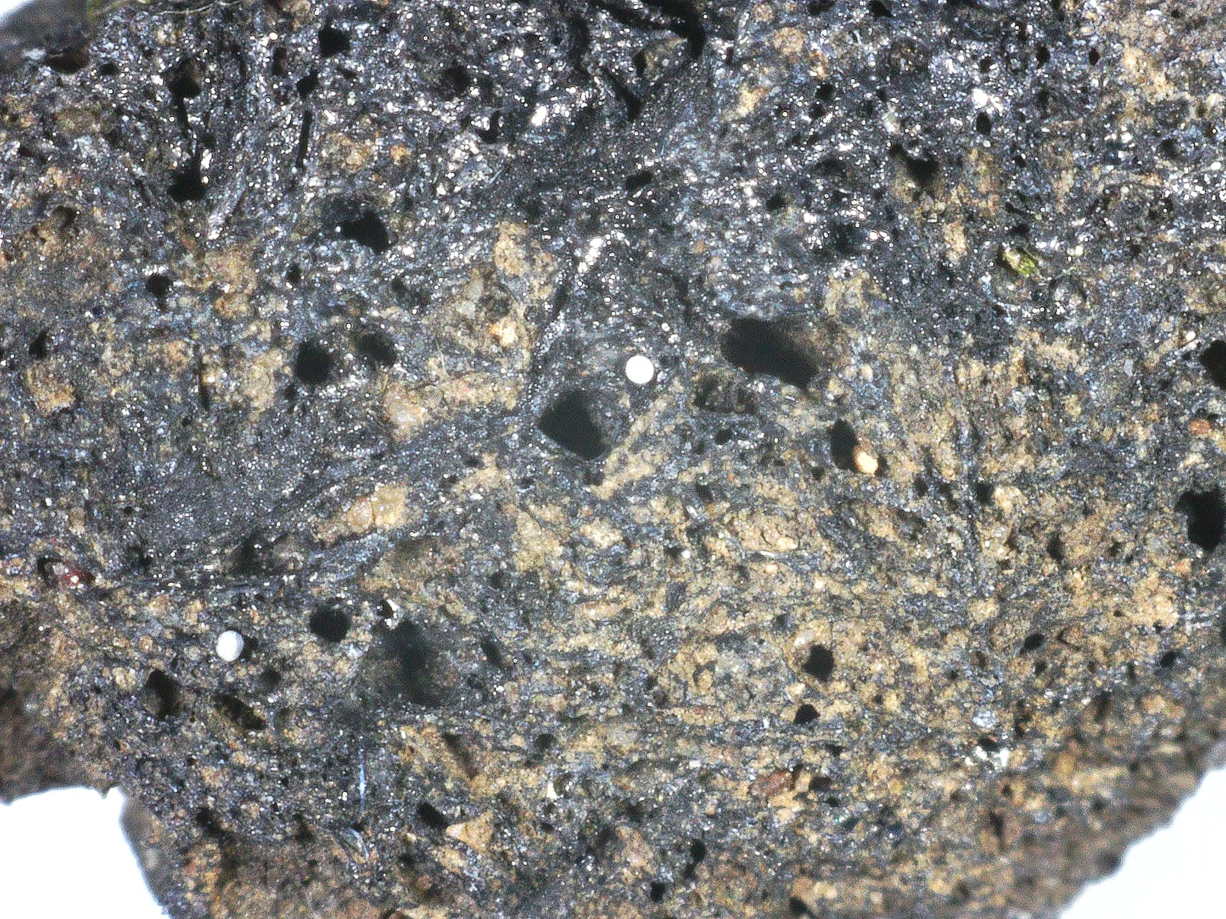

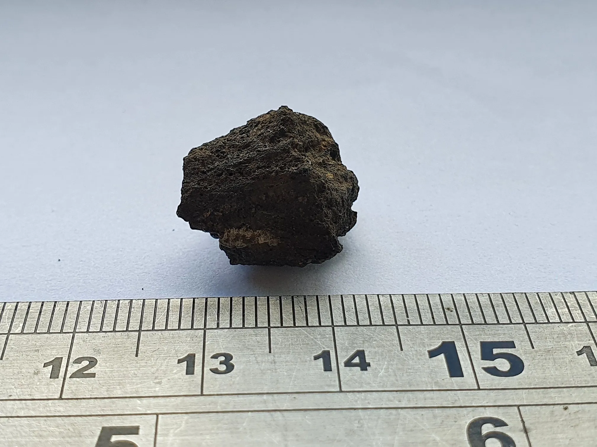

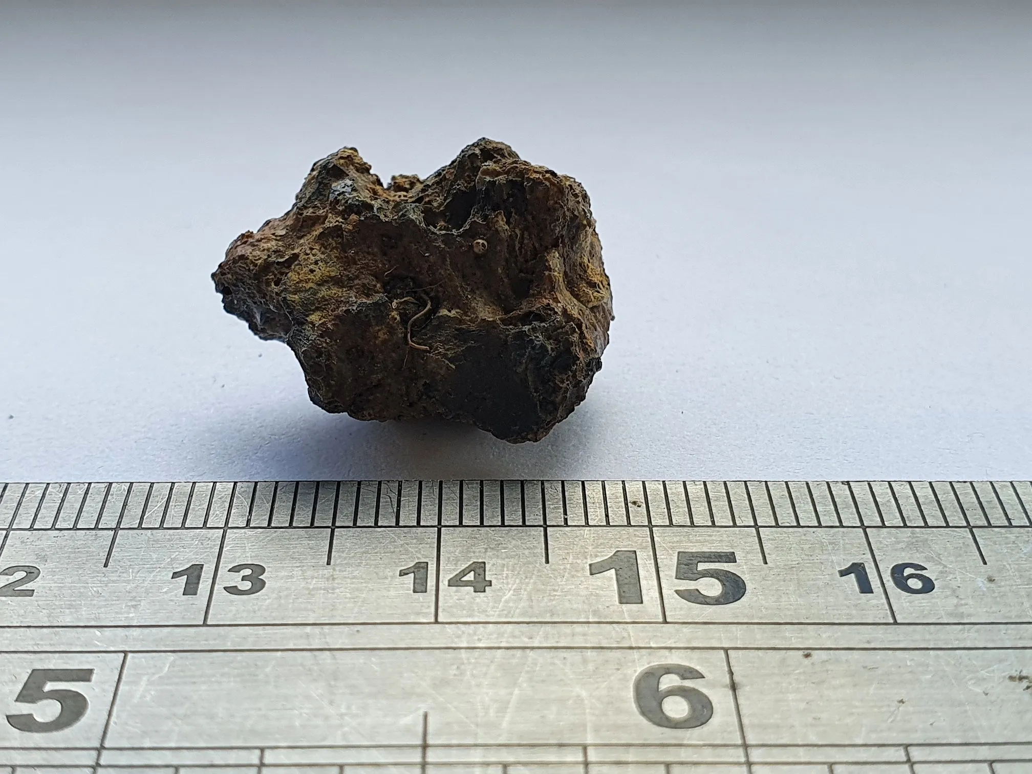

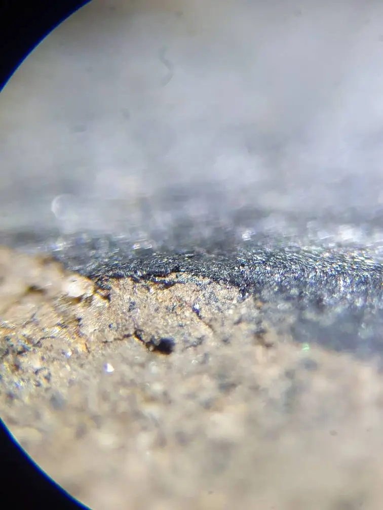

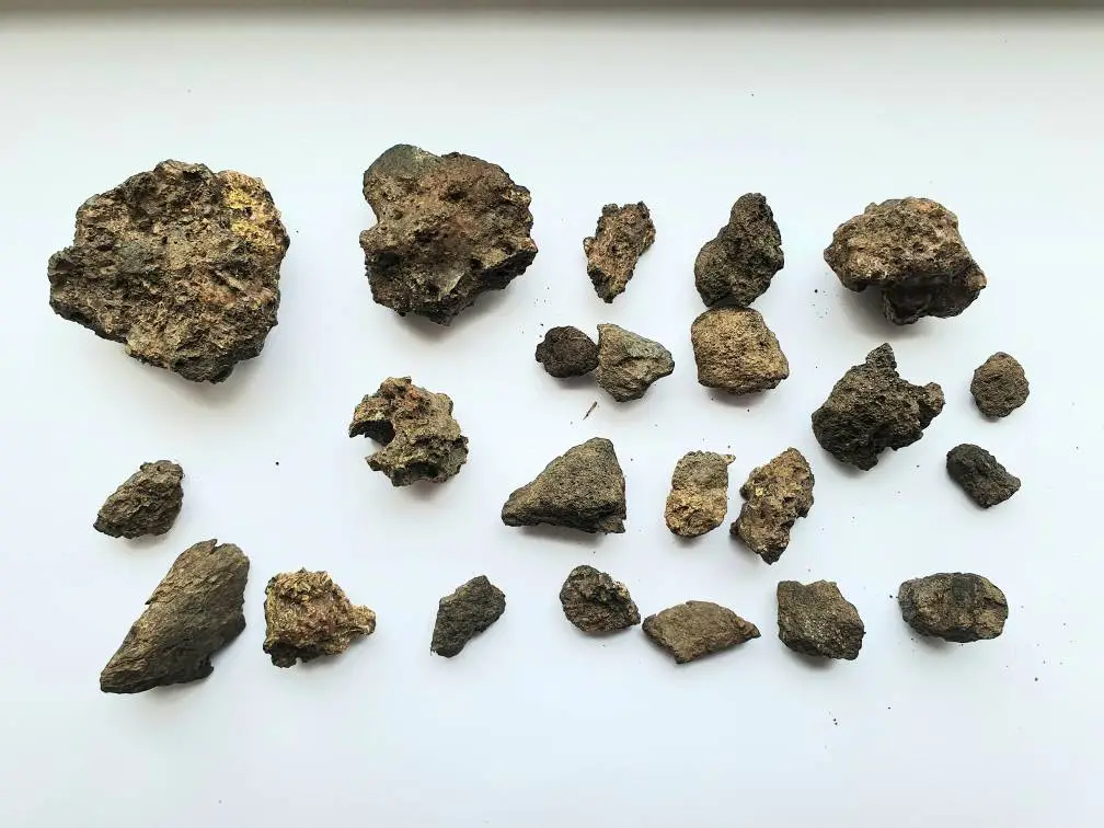

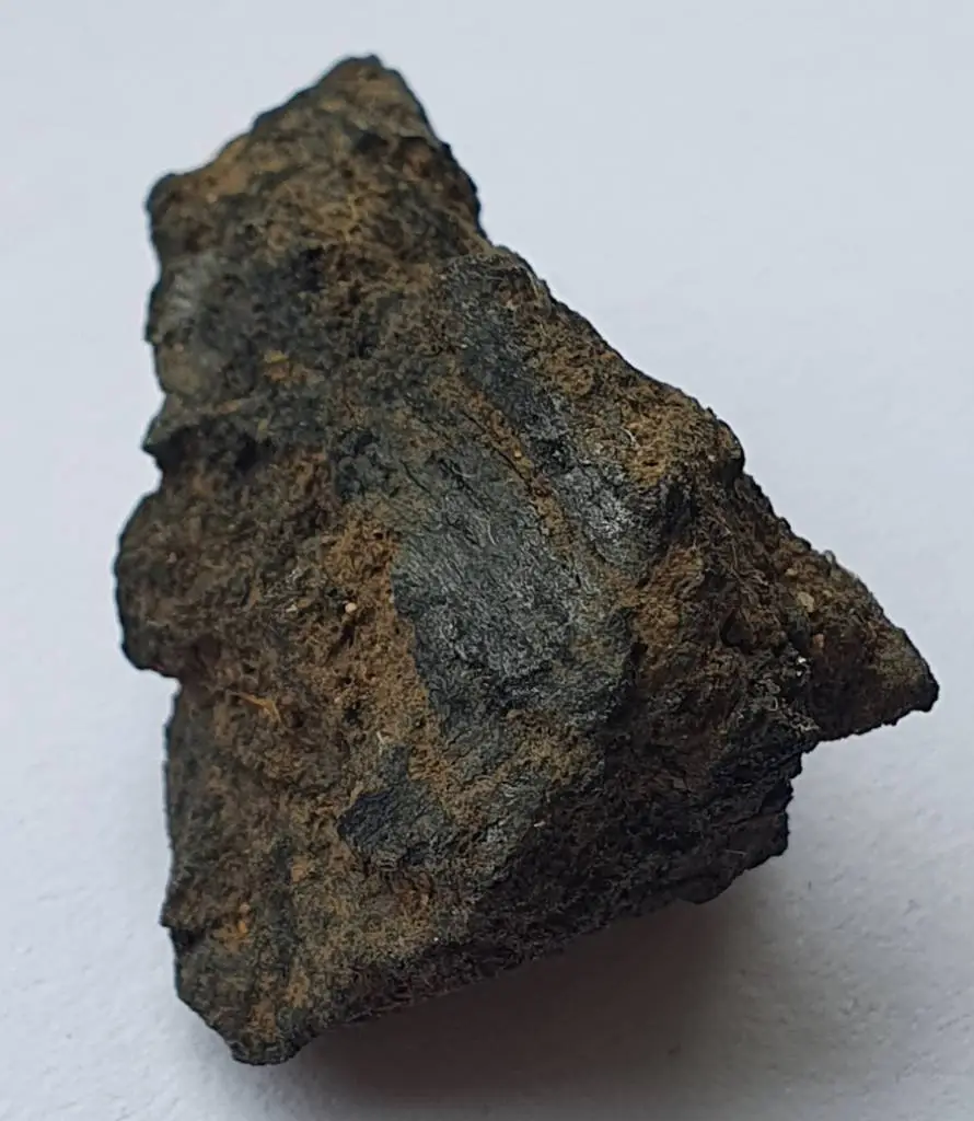

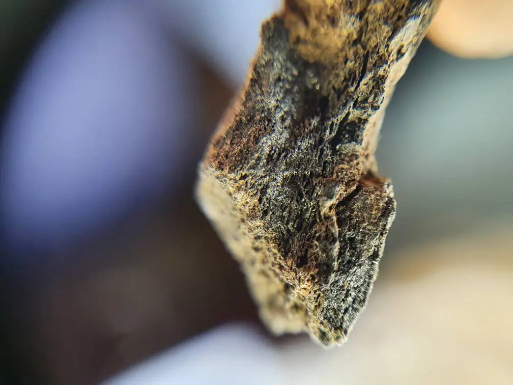

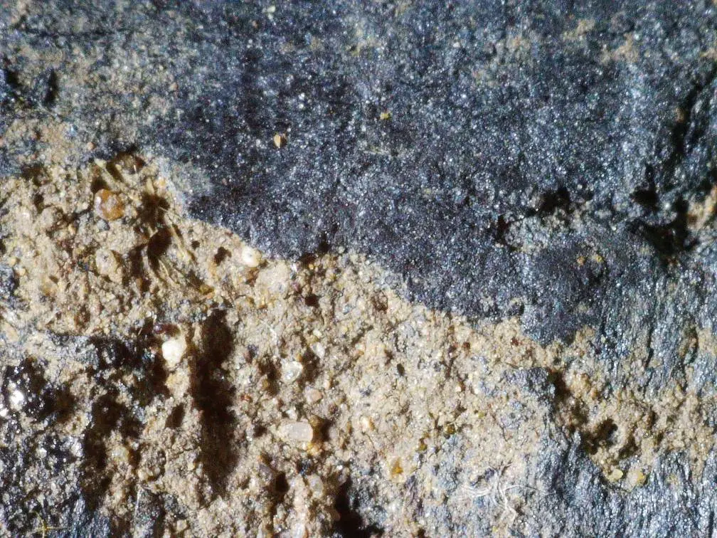

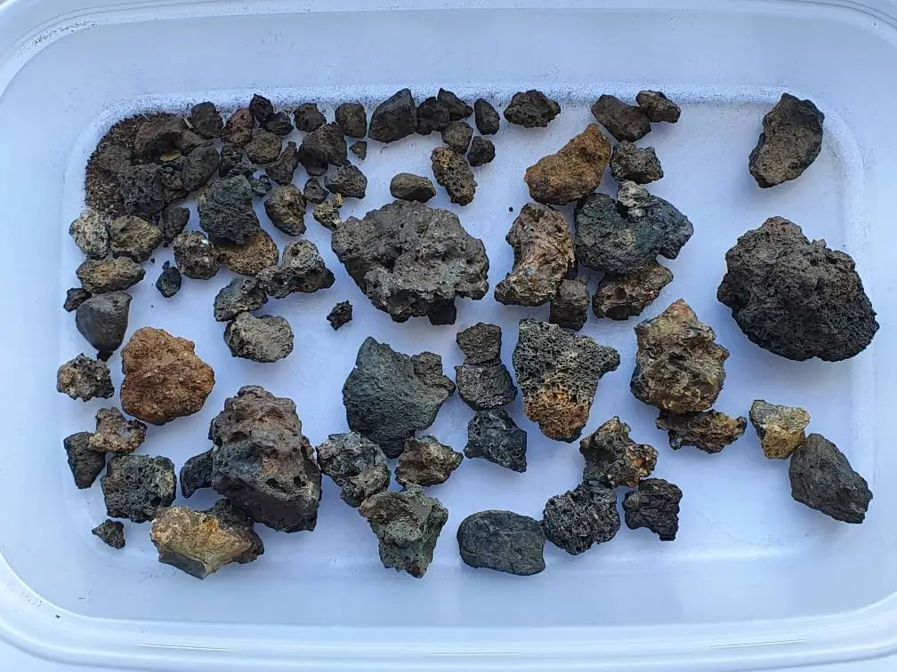

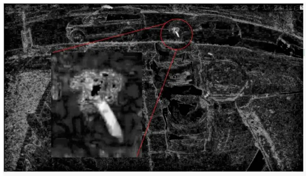

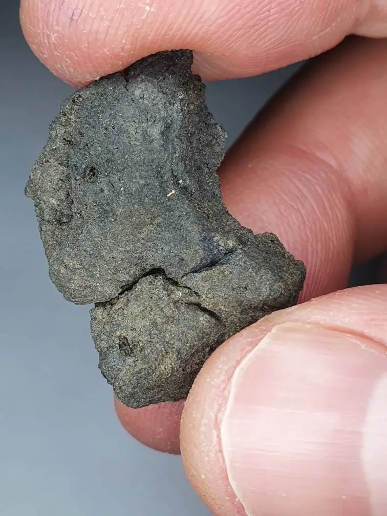

I live in Birmingham, UK. For the last year I've been investigating some unusual rocky fragments that fell from the sky as a fireball and landed on our garden on the evening of 17th July 2020. My wife and I heard it happen; a warbling whistle with underlying hum like discharging electricity, and two CCTV cameras caught it. Ours captured the fireball fragmenting close to the ground, some pieces of which bounced off the house, the other, from 0.1 miles away, captured a reflection of the fireball streaking in the sky above the houses.
One piece, which was seen to bounce off the house in the footage, was found on the drive <12hrs later which still smelt burnt. The rest of the fragments were found in our garden over the course of few weeks. The fragments have very unusual surface features. To date I've recovered about 250g of material and even started to assemble the original body, which would have been about 3-4" across.

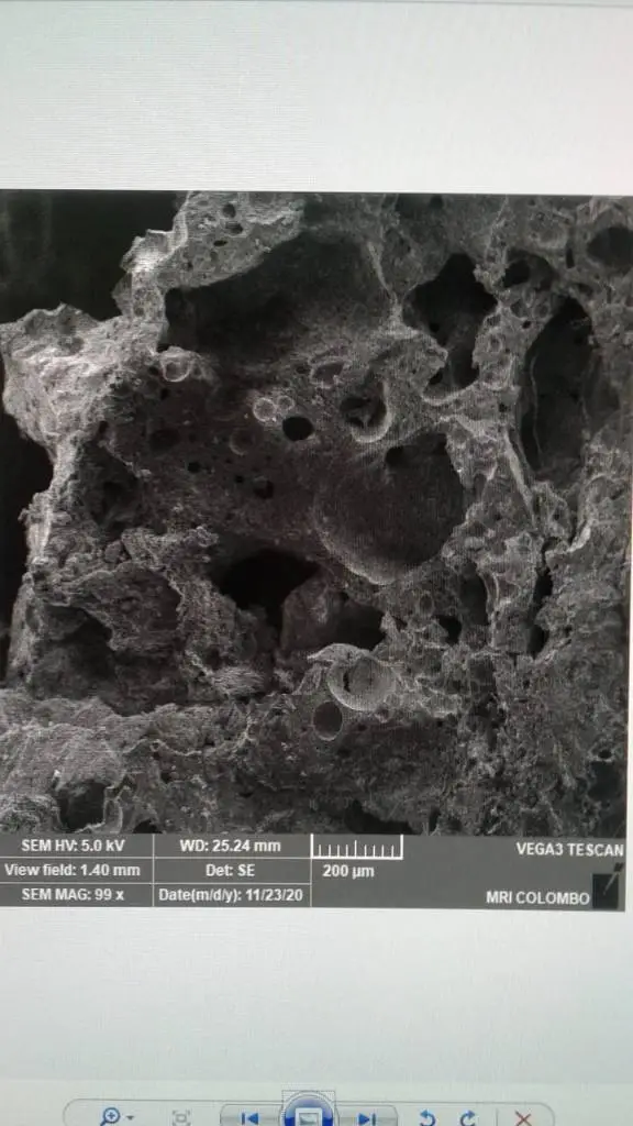

The material is low density, typ. <1g/cm3, but some fragments are more melted or fused than others, and these are denser, but <1.6g/cm3. The structure is a porous fine grained angular dark matrix which is highly carbonaceous, and there are lots of crystalline structures on the surface and suspended within the matrix. I've found that fresh fracture faces are black but turn brown on cooling from red hot temperatures, by the formation of brown crystals.
Apart from a lot of pictures and looking at it through a microscope I've had a bulk composition analysis done (SEM, EDX & XRPD), results below. Some of the material is currently undergoing a petrographic analysis, results due the 12th August. I'm keen for it to undergo a triple oxygen isotope analysis, as i understand this will really help identify its origin, but I've not found anyone willing, even offering to pay for it!
I've spoken to many meteorite experts from around the world, the Natural History Museum London, UK MON, but they dismiss the material as slag. I have it from experts on industrial waste products and volcanic material that it's neither, so the mystery continues!
The cctv and some more images are linked on imgur here:https://imgur.com/a/Glvbnqp
@Red-Coat. Thanks for the replies. I've not checked the German site yet, but UK mon linked 2 other sightings to mine:*https://ukmon.imo.net/members/imo_view/event/2020/3485
My theory for the white mushrooms relates to a process like in this paper: https://www.semanticscholar.org/pap...Bush/2d90847a2410300d0c4bf06a4c43cdcc16be721b

100 sunlight (1).webpDigitial microscope (1).webpCRhEjXg.webp20210615_202031.webp20210613_134246.webp20210613_131050.webp20210609_080602.webp20210415_151324.webp20210610_123011.webp20210114_104449.webp20201230_111856.webp20210109_210340.webp20201130_201858.webp20201209_154340.webp20200913_185330.webp20200906_145756.webp20200801_115750.webp20200801_122416.webpIMG-20201123-WA0008.webp

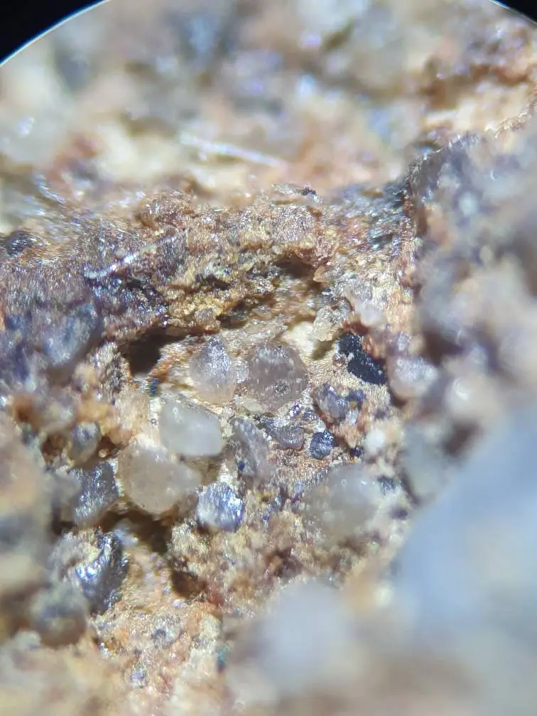

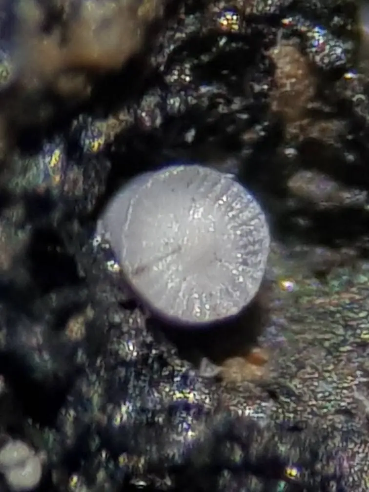

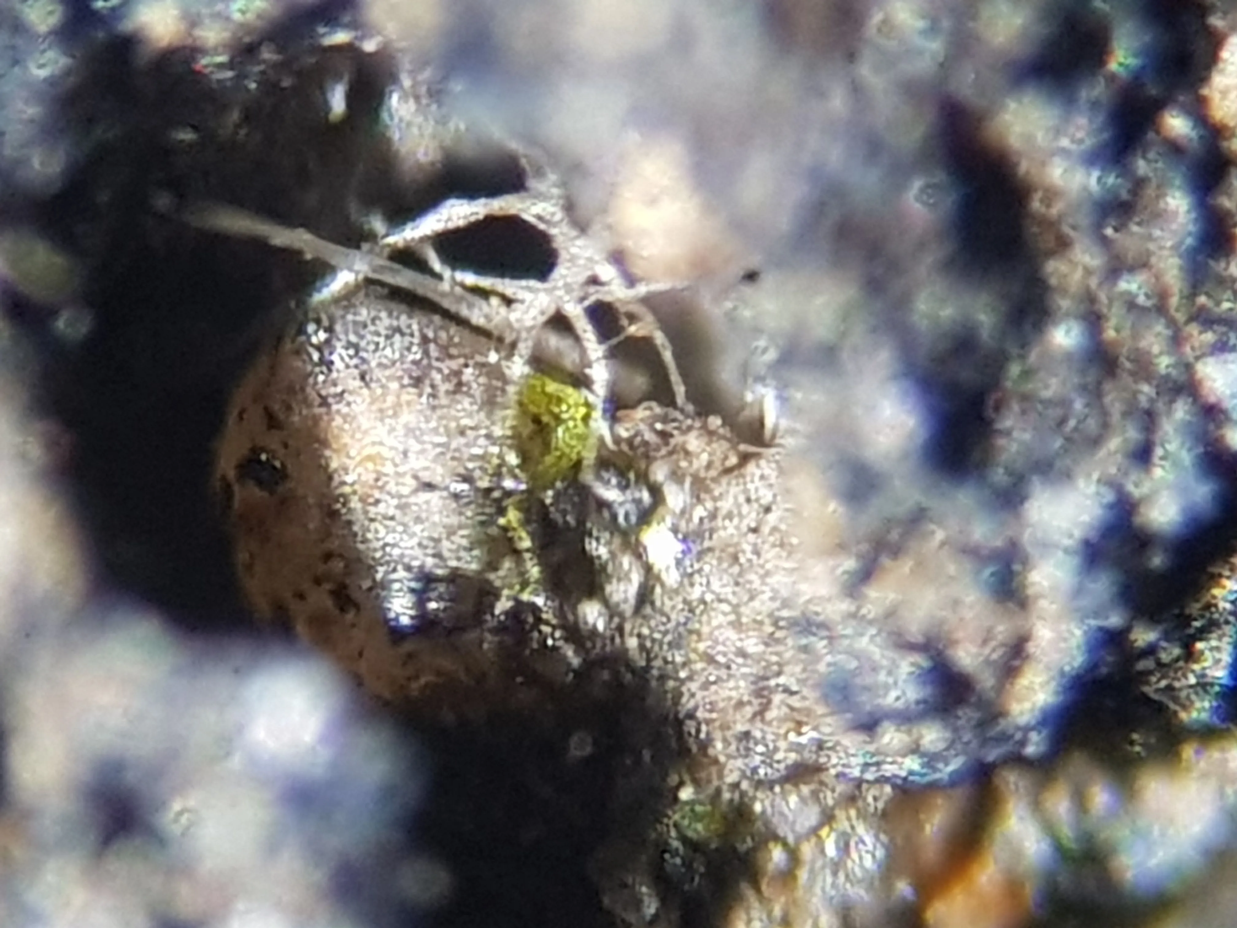

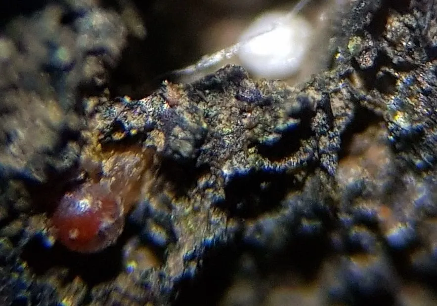

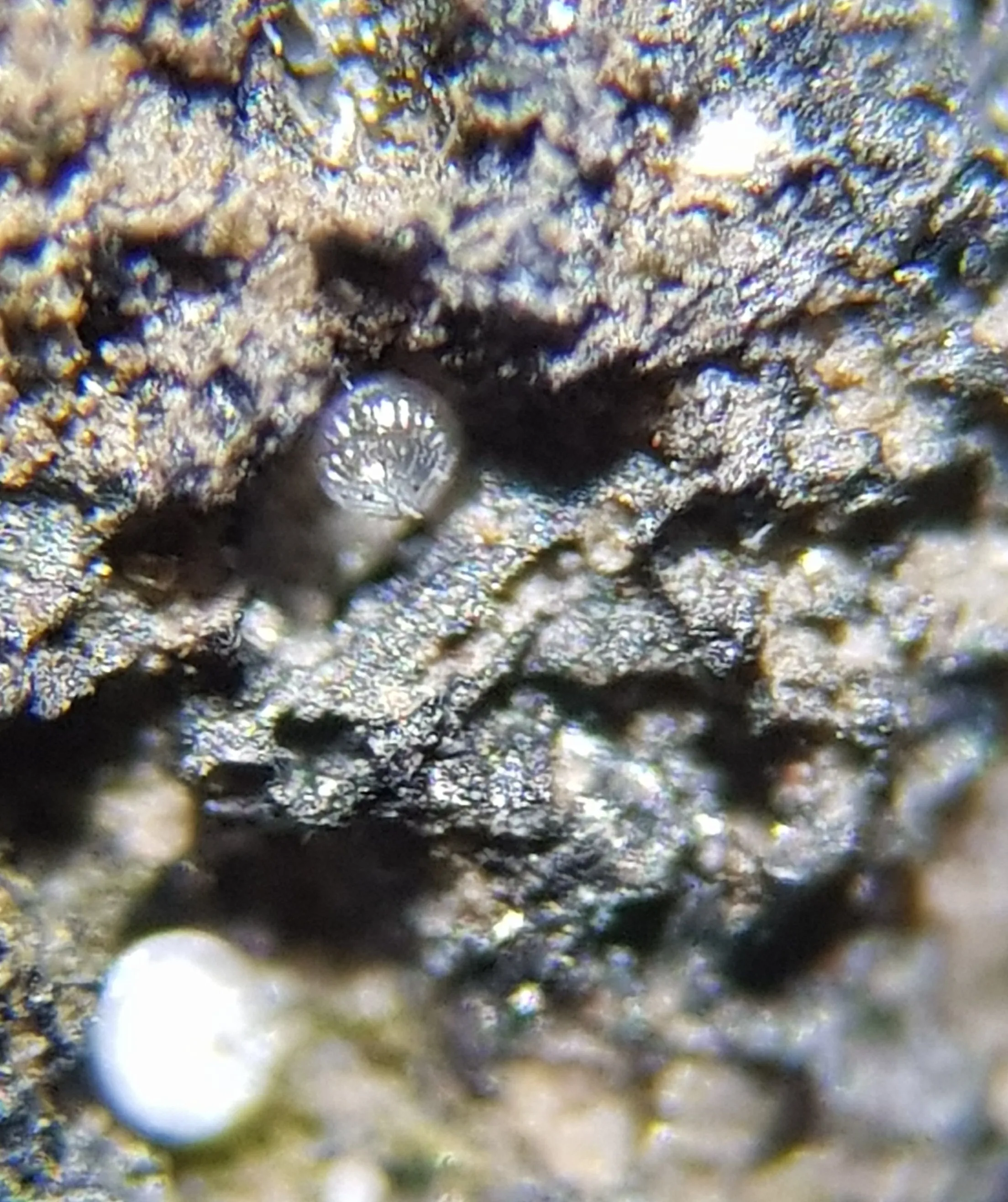

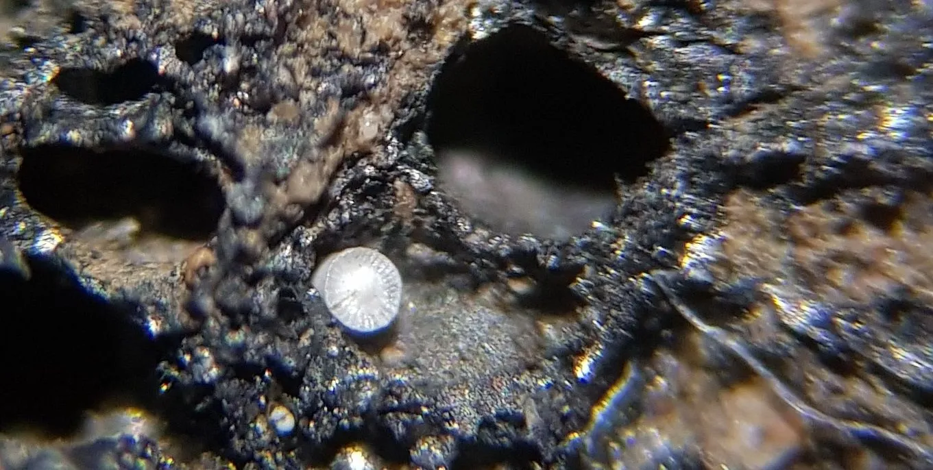

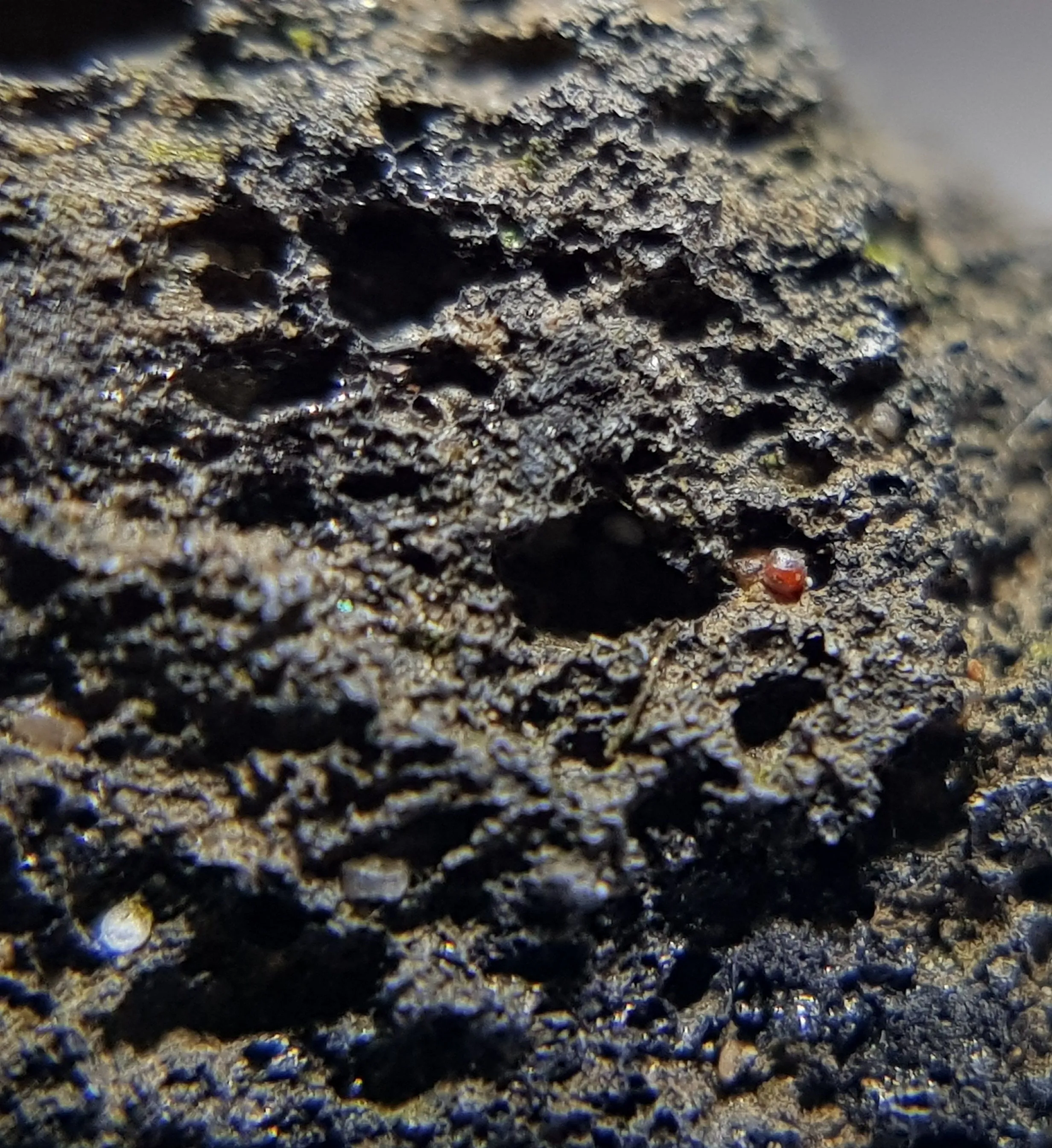

For posterity some additional images of the strange surface features are attached. All these features are found on the fragment collected the next morning that was not subject to any rain/water/moisture.

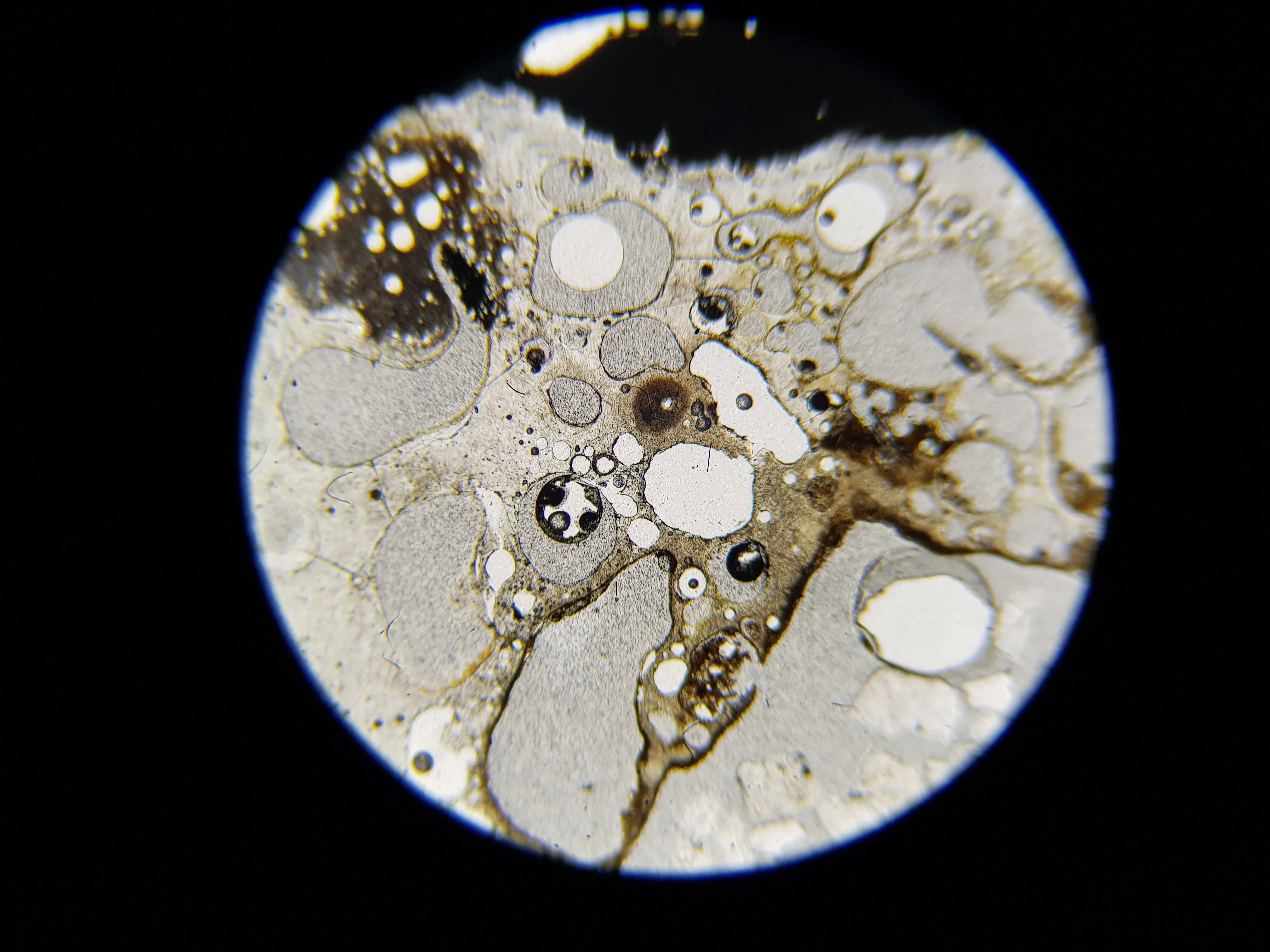

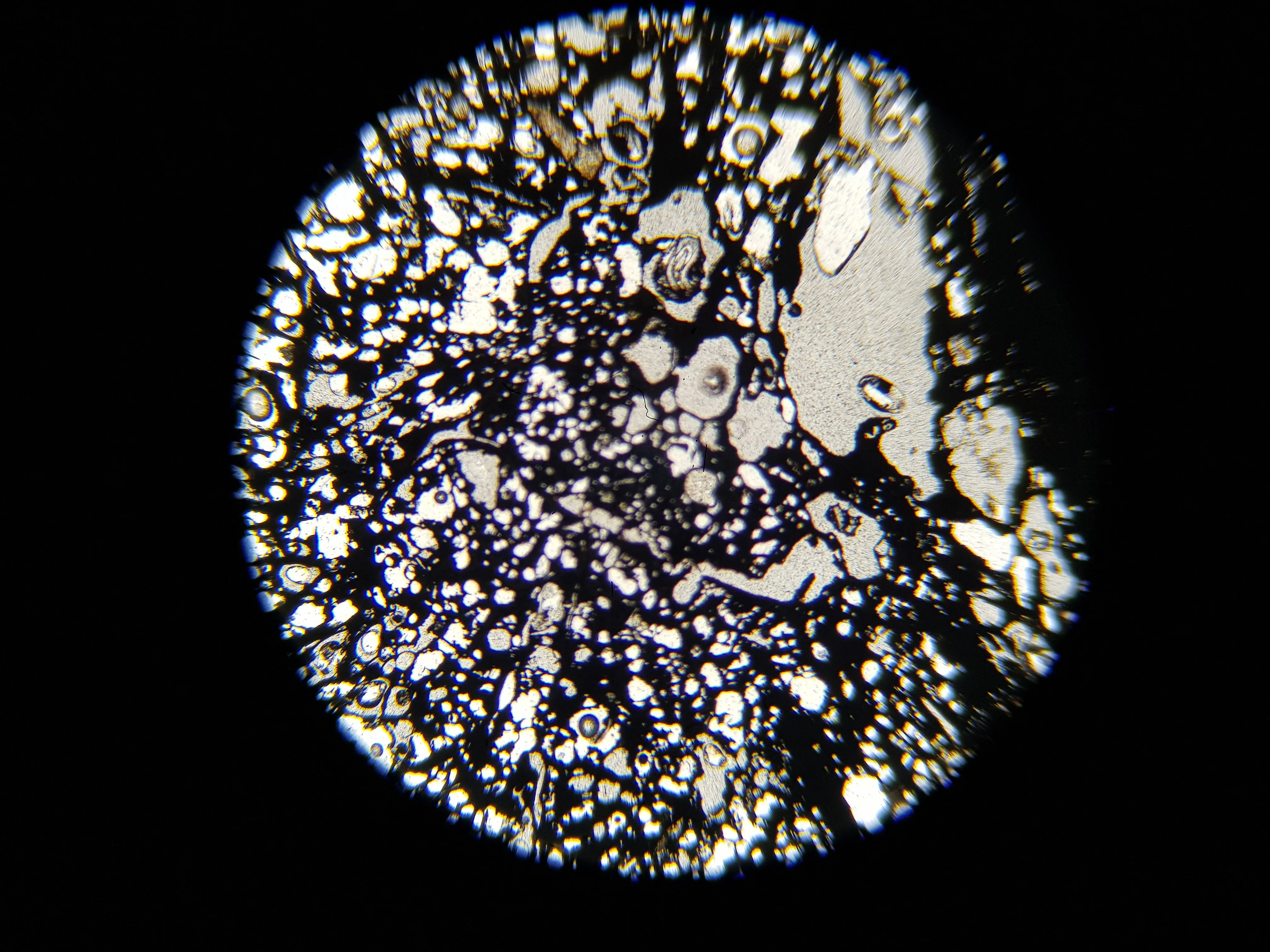

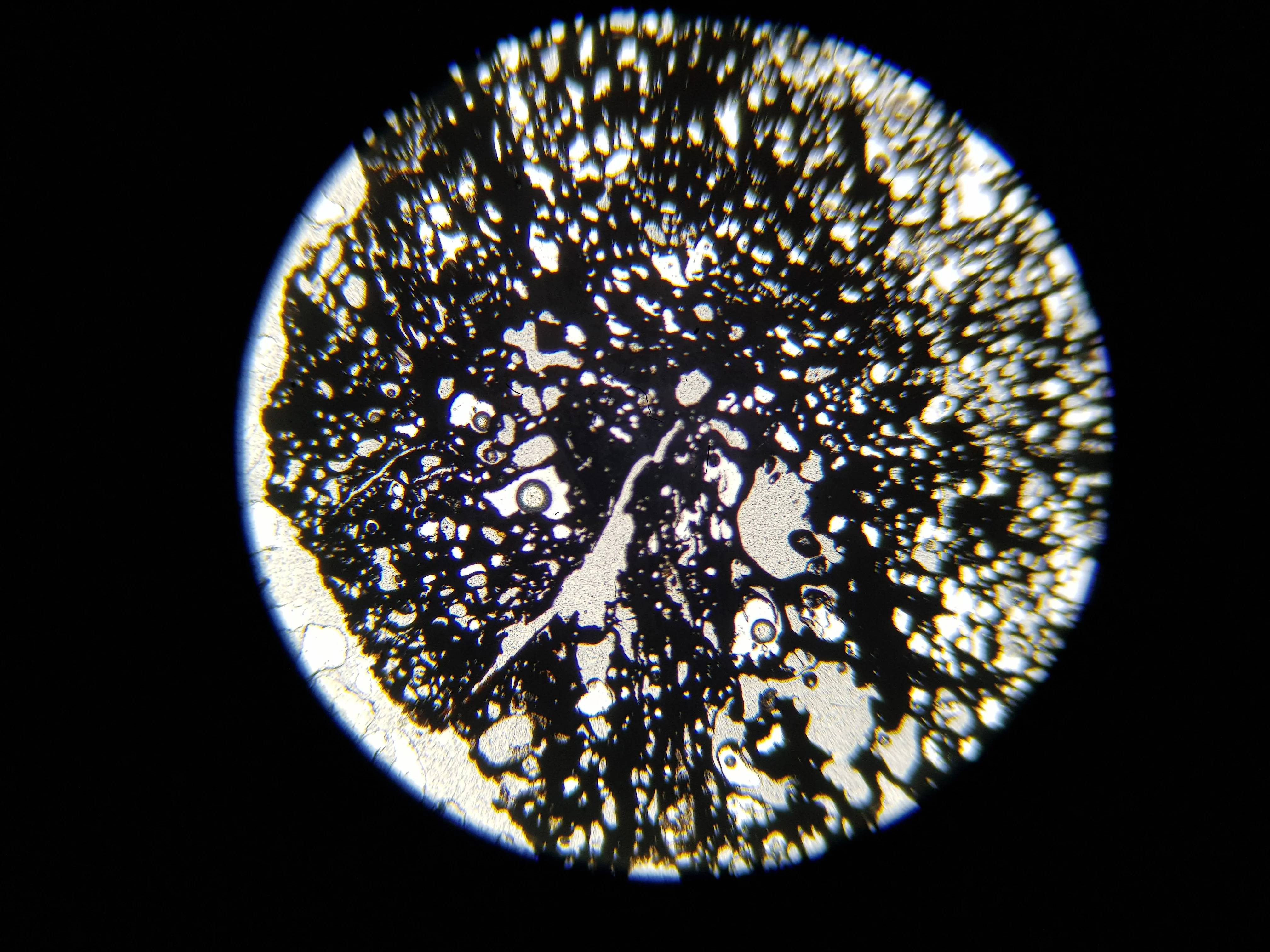

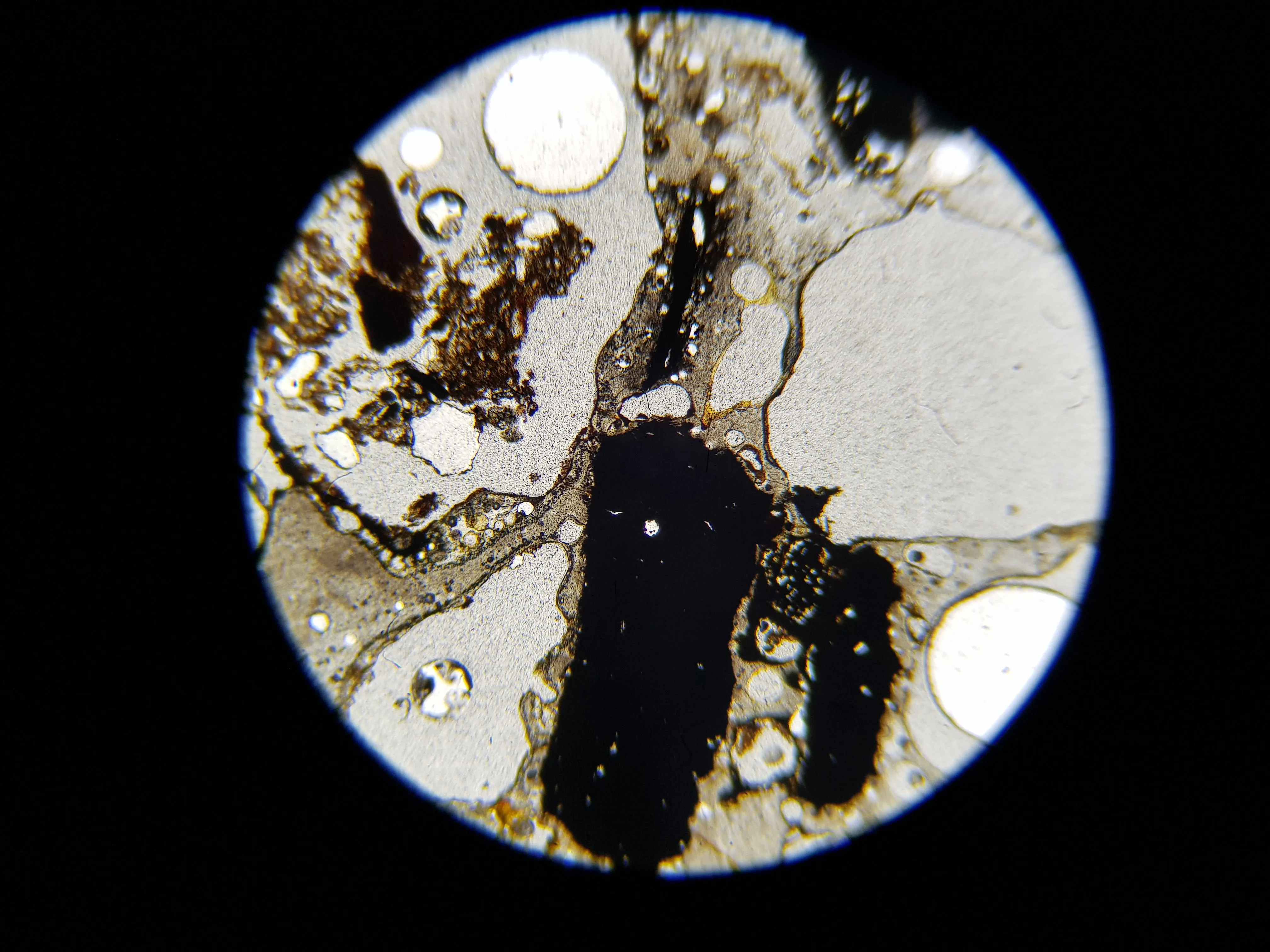

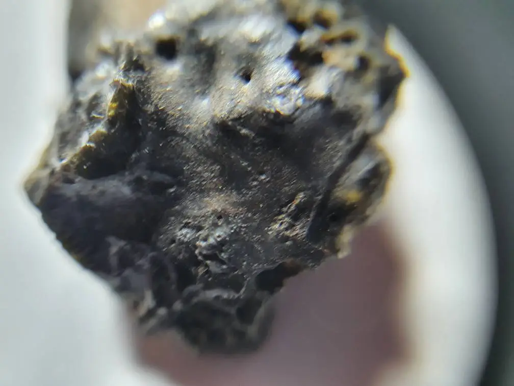

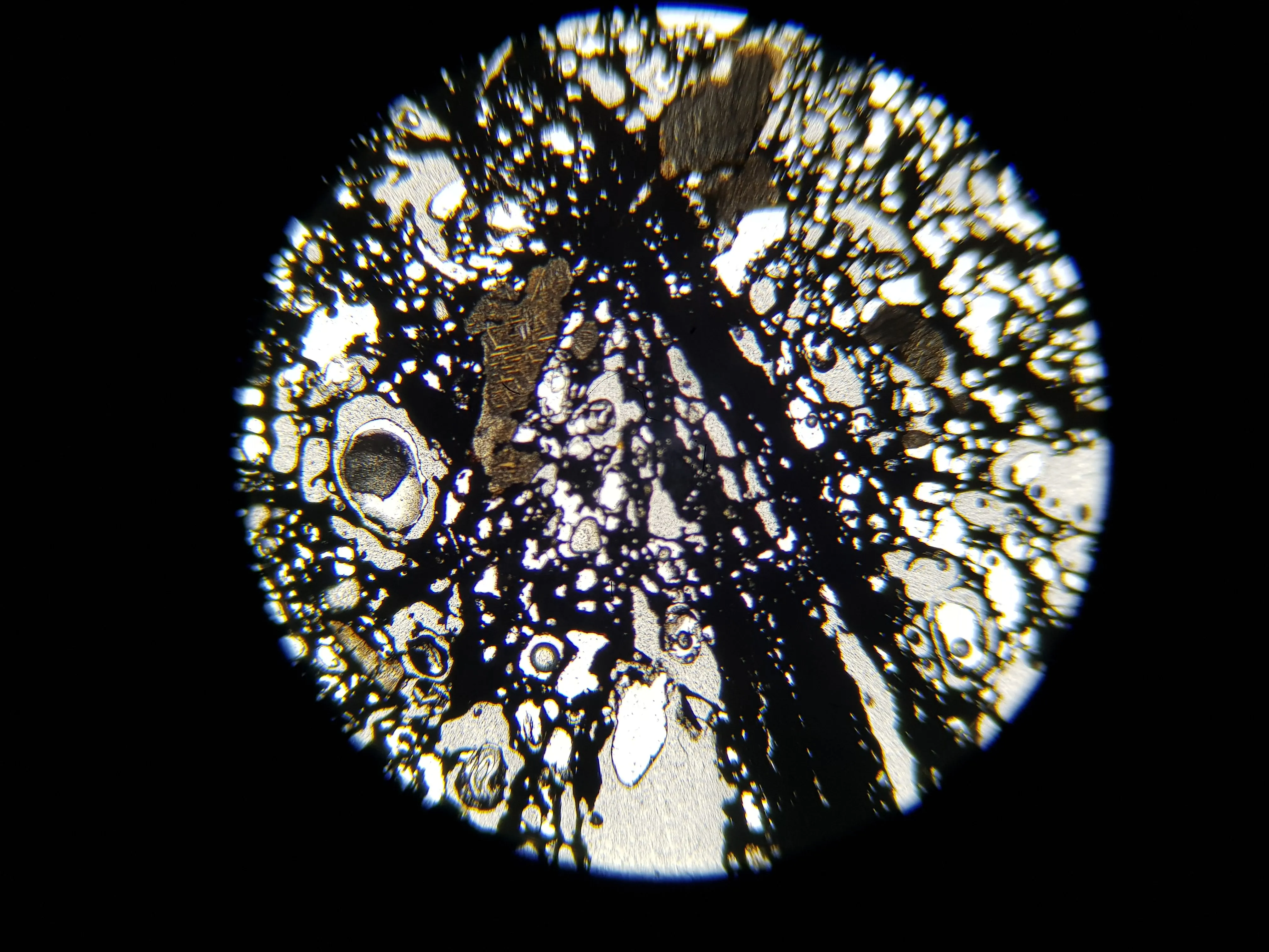

For interest, I got the thin slides back today and took some images through the microscope (10x objective, 16x eyepiece).
One of the characteristics they determined as 'meteorite-like' was the presence of chondrules, but these were found to be empty and expected to be filled with olivine, serpentine and other Mg-Fe silicates. They also commented on the angular cooling textures observed and that cooling textures like these are observed in meteorites. however, they are formed in metal alloys, rather than silicates. Just some of the many oddities.

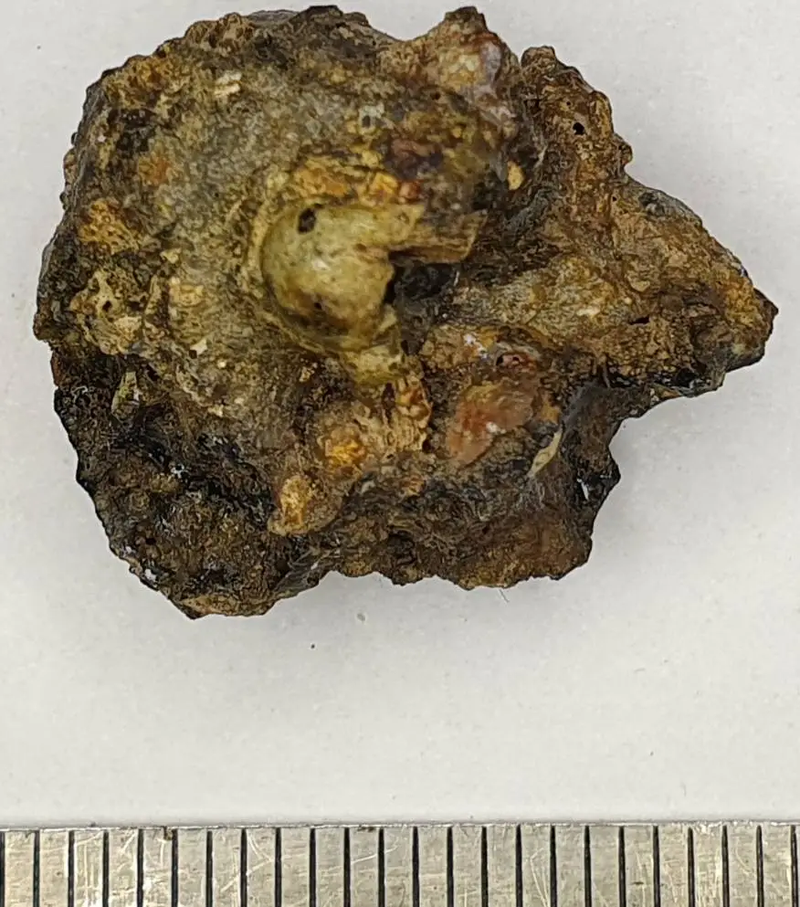

The overall objected comprised of fragments that are un-melted, partially melted or 'glassy', and some that are even fused/vitrified on the surface. I sent them two samples for prep, but only the glassy sample received the full workup. They did however give the un-melted sample a once over for curiosity.
'Unmelted' Sample:
'Glassy' or Fused Sample

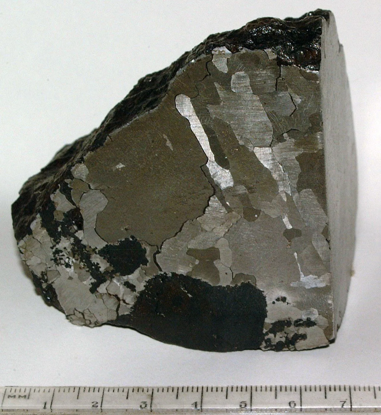

There is one possible exception to the above. Nickel-iron meteorites sometimes contain discrete nodules of graphite within their overall composition and those can be very high in carbon. Here’s a chunk cut from a fragment of the Campo del Cielo meteorite from my collection. The silvery lamellar plates in the upper areas are the nickel-iron alloys kamacite and taenite, but the two dark areas below are graphite nodules:
These nodules are very carbon rich, sometimes up to relatively pure carbon, but there are two reasons why I don’t think that’s what you found. Firstly, although the nodules can be quite large, they only survive burn-up in the atmosphere when they are within the body of the meteorite and protected by the nickel-iron surrounding them. Otherwise, the exposed graphitic areas are the first to be burnt up, ablating away to leave the characteristic regmaglypts often seen on nickel-irons. Secondly, these nodules (or at least the larger ones) invariably have veins of nickel-ion running through them, which is a probable indicator that they are a ‘shock-melting’ product. That means that although they are primarily composed of carbon, they have at least some native metal and will be attracted to a magnet. Your analysis showing the only iron to be Fe2O3 at a level just over 2% doesn’t support that possibility.

We should also not forget what you originally described as "very odd surface features, one also attached a white mushroom-like structure about 0.2mm dia. of which there are several!":
Those surely have to be from something man-made as a multi-component object? What would have that appearance and resist melting, while the other portions have not? Some kind of high-tech ceramic maybe?

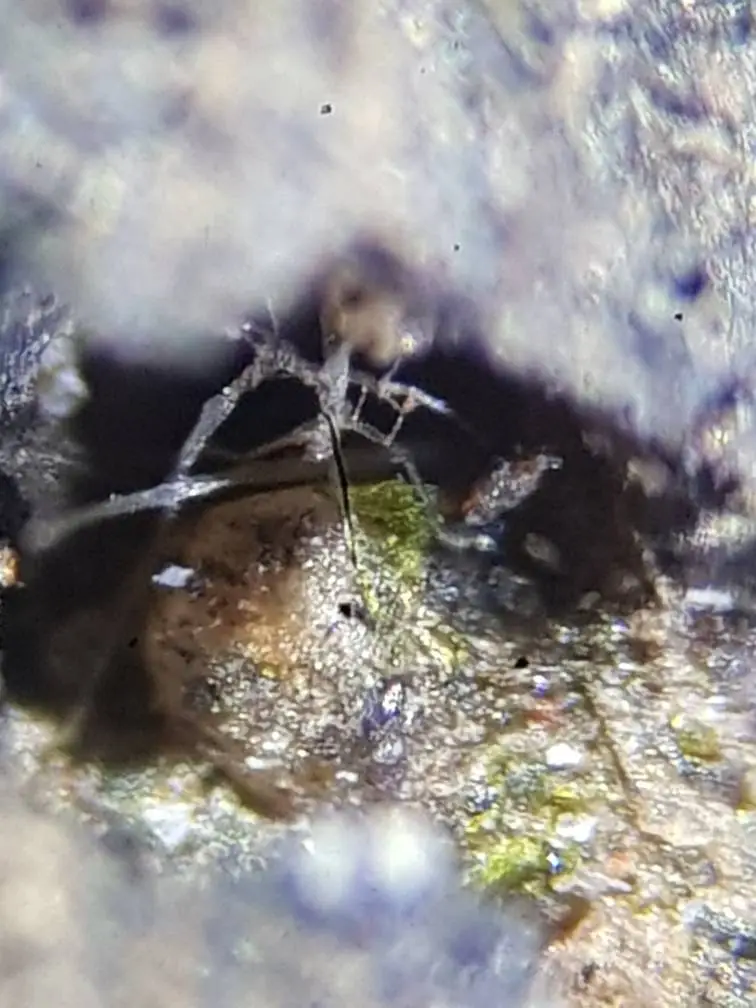

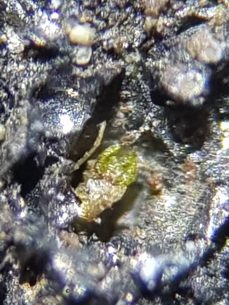

There is a wild card element I've not mentioned here, and that is the microbiology that's been found inside and embeded in the fragment that was found the next morning (and was not exposed to rain or water), and the other fragments.
I've recently started discussing it more here:
https://www.scienceforums.net/topic...-surface-features-and-microbiology-inside-it/
Good luck with that discussion but frankly you've now gone out on such a limb that I have nothing rational to add to your wild conjecture.
If this specimen bounced off your house (and especially if it bounced off a tiled roof) in a semi-molten condition and ended up in the bushes in your garden, there's no telling what organic materials it may have picked up in the process. And yes, microbial life is certainly known to exist in the area between about 5-10 miles above the surface of the Earth.
If you believe you've found a piece of cometary debris containing extraterrestrial organisms which provides proof for a 'panspermia' hypothesis, then you can count me out.

- does the material contain microbiology = YES apparently undamaged diatoms and other structures are embedded deep inside the fragments and within the material matrix

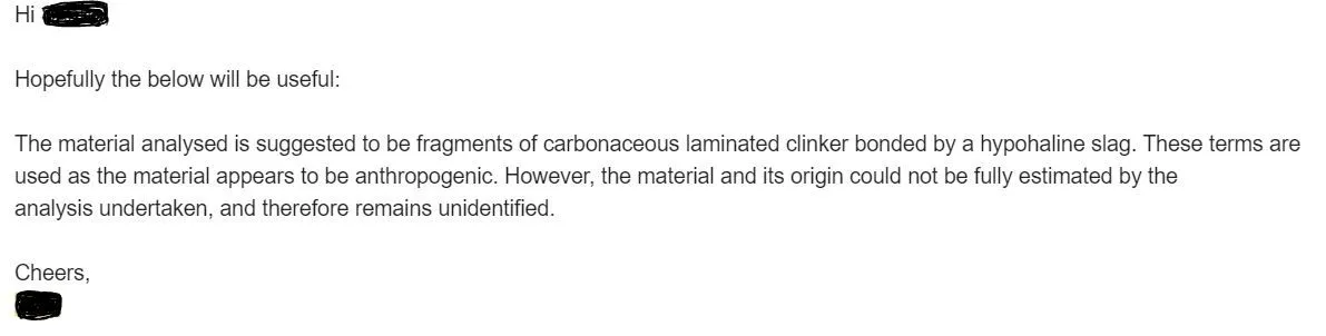

The investigations to date (SEM, EDX, EDX & XRPD, EDX & petrographic) were not able identify characteristics akin to existing meteorites, nor any of the expected characteristics of meteoritic materials, but it still remains unidentified. I have not been able to confirm the age or origin of the material by analysis such as Triple Oxygen Isotope, Cosmic Ray Exposure (as these are highly specialized), or even if it has a 'terrestrial' age by carbon dating. The prevailing theme is that that the material is anthropogenic, and possibly the remnents of an artificial satellite that have fallen back to earth. That might explain the:
- observable differences between adjoining fragments (perhaps different components?)
- some of the odd biological looking structures found on the outside (perhaps something collected from the atmosphere?)
However that does not answer anything relating to the intact biologicial structures found inside the material.
The anonymized petrographic report is attached, and their prefacing email is below.
To be clear, I'm not claiming that this material is one thing or another, instead putting it, and what I have found, out there for posterity and open discussion.
