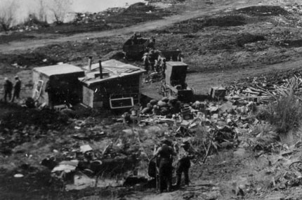

Sanitation practices varied tremendously from place to place in the 19th Century. "Organized" is not a term that I think about in conjunction with dumps. They're generally a riot! 8-) By the late 1890's things were getting more "organized" in the world of dumping, at least in these parts.
Every dump I've dug has been pretty localized, if not tied directly to a single location, but I'm usually digging in an urban area. I've found some "neighborhood" dumping areas, or at least, what I interpret as neighborhood dumps. They have been way too large for any individual establishment or family. I found a block long dump, on a local Sanborn map, but have only been able to highlight limited portions of it, due to an ongoing construction project. I keep getting kicked outta there, alas...
Here's a bit of dump "history": Landfills.
You gotta follow the "Rags, Sacks & Bottles" man.
